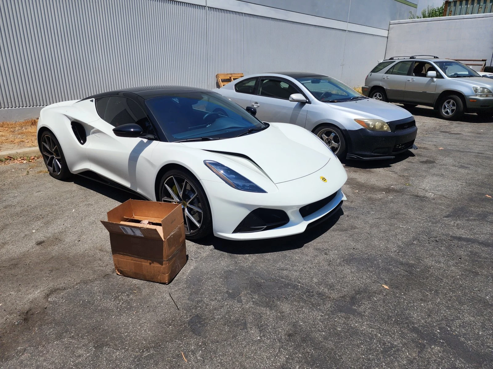

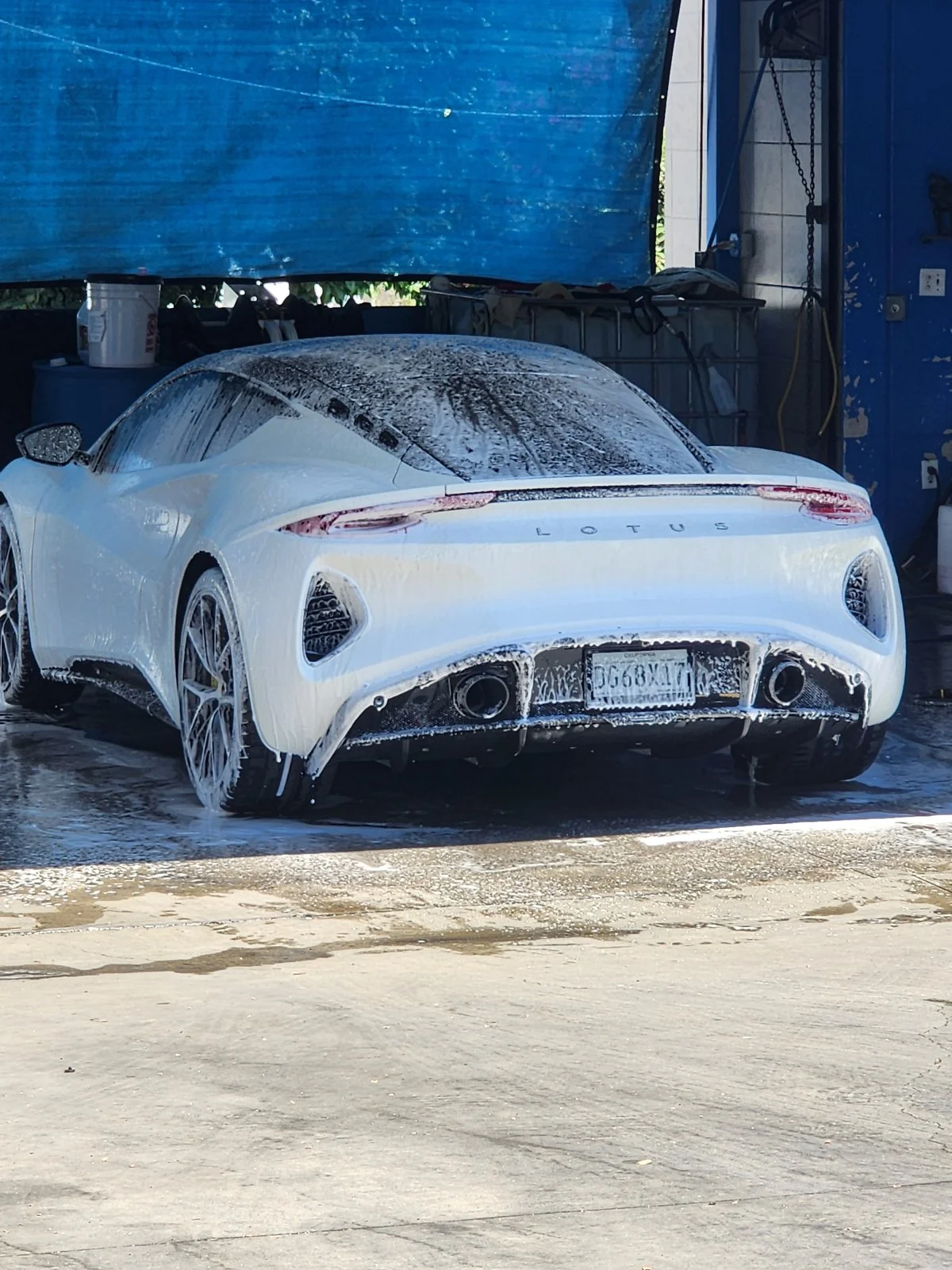

I purchased the lowering kit from GRP and also CT Carbon kit from them but considering a road condition in Los Angeles, I'm still don't know how much to lower my emira. I do not want to scrape every bumps but still want that sharp look when you lower it. Has anyone lowered Emira using GRP lowering kit?? Can you post a photo of it and let me know how much you've lowered it??
Thank you !!!

Btw, did u wrap it white? Didn't know emira had that paint option?

No.. I didn't wrap it... it's mist white.

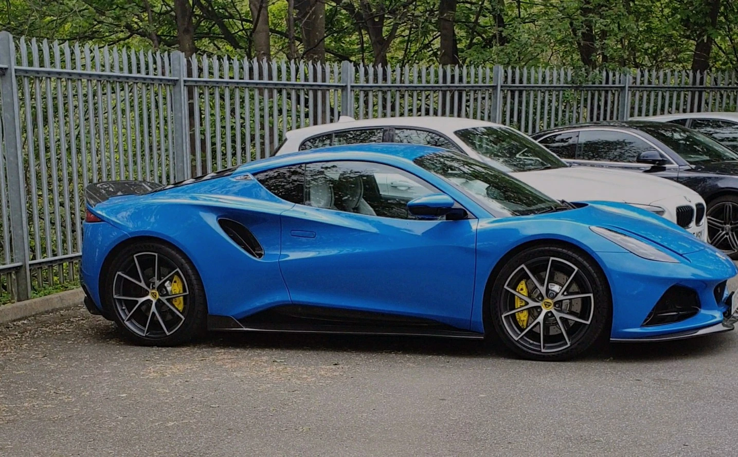

Hi, the YouTube link below shows the carbon kit being fitted and the GRP spring perches fitted. That is now my car and the ride was too harsh and too low, every bump felt and every speed hump hit. The pic is after it was all done.
I paid £320 ($400) to have the car lifted up another 15mm from that in the video and geometry done. The ride is firm but acceptable and only the steepest humps pose a problem. I've not been to the track yet, still running it in, but I can already feel it will be good. I have the Sport suspension.

Your car looks awesome 👌 how much did you end up lowering?? I'm still waiting on CT Carbon kits so I'll be installing mine when it arrives. I'm still holding on to the GRP kit yet until I see how low I can go without scraping every bumps.. and did you install the spacers also ??
Thanks, it does stand out when parked up. I'm not sure of how much it's lowered by, but it's 1 1/2 finger depth above each wheel. The roads where I live, Yorkshire, are horrendous for potholes and speed humps everywhere. No spacers yet, may be some problems with them from what I've read, I'm wanting the 3rd cat delete pipe next.
