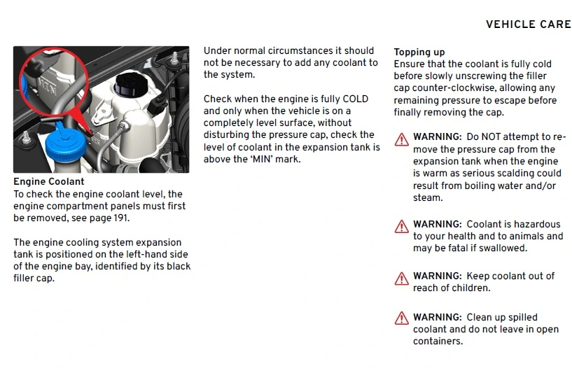

My emira reads 180 to 185F but when I'm driving spiritually up the hill on a hot day the temp goes to 200° and the car goes into limp mode. I have not checked the coolant level but don't even know where to check it ...can someone comment as to how ?
My other cars coolant temperature hardly ever budges but this car seems to have the temperature sensor at a very sensitive location maybe... and it fluctuates by 15 to 20° which is unusual versus my other cars (gt3, huracan, f430, .... etc)...
Tnx in advance for comments,help...
