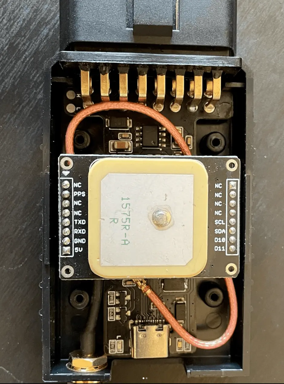

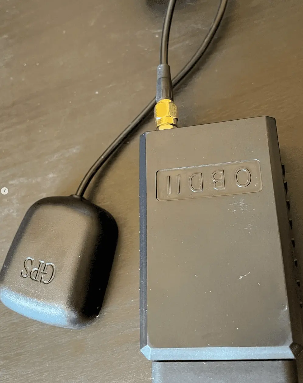

If you’re inquiring how I do the exhaust flap manipulation, I do it all with an obd2 pluggable device. It’s a programmable Arduino device with a serial CAN bus module that can receive and transmit to the bus. It also has a GPS chipset and an antenna I added. Put it all together and write some code and it constantly polls the GPS location at 1 second intervals, if it detects its within the radius of the Laguna sound station, it sends the CAN packet to close the exhaust valves and then reopens them when you leave the area.

Pics of the arduinos device I made for the F82.

From my initial searches, 6th gen Camaro also has valves controlled via CAN bus, which means it’s possible but I haven’t seen anyone do it for your car. To be perfectly honest, I don’t think I’ve ever seen anyone else even attempt or achieve this on any other car. I’ve seen some 911 GT3s hardwire an Arduino / Raspberry Pi to a relay for their vacuum system — but not via CAN.
Unfortunately CAN hacking is super time consuming. Your car is constantly just sending a massive amount of data around on the CAN bus all the time. Identifying the CAN message IDs specific to your car and the correct byte values to send that instructs one or more valves to open or close took me 10+ hours of work for my BMW M4.
