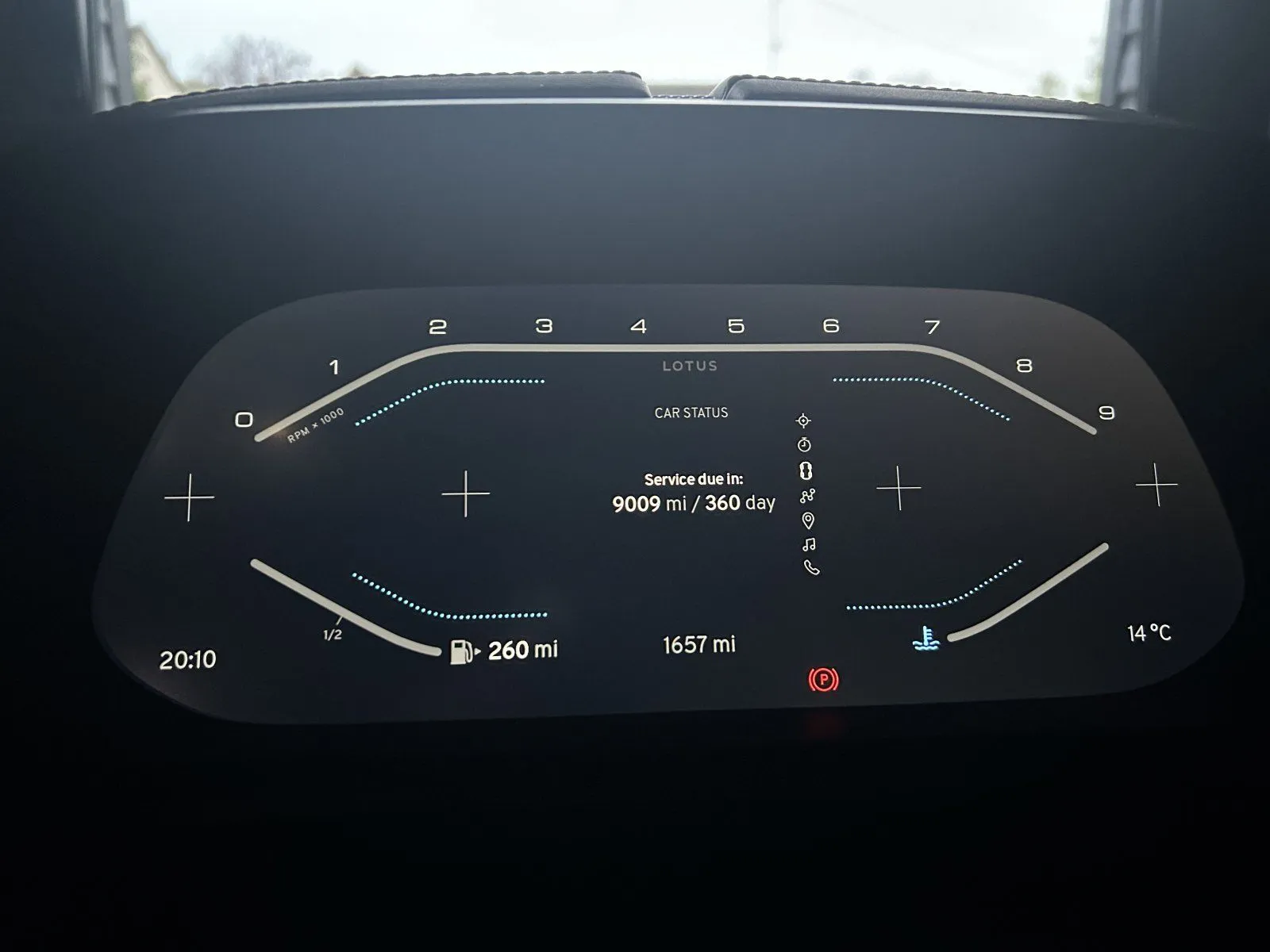

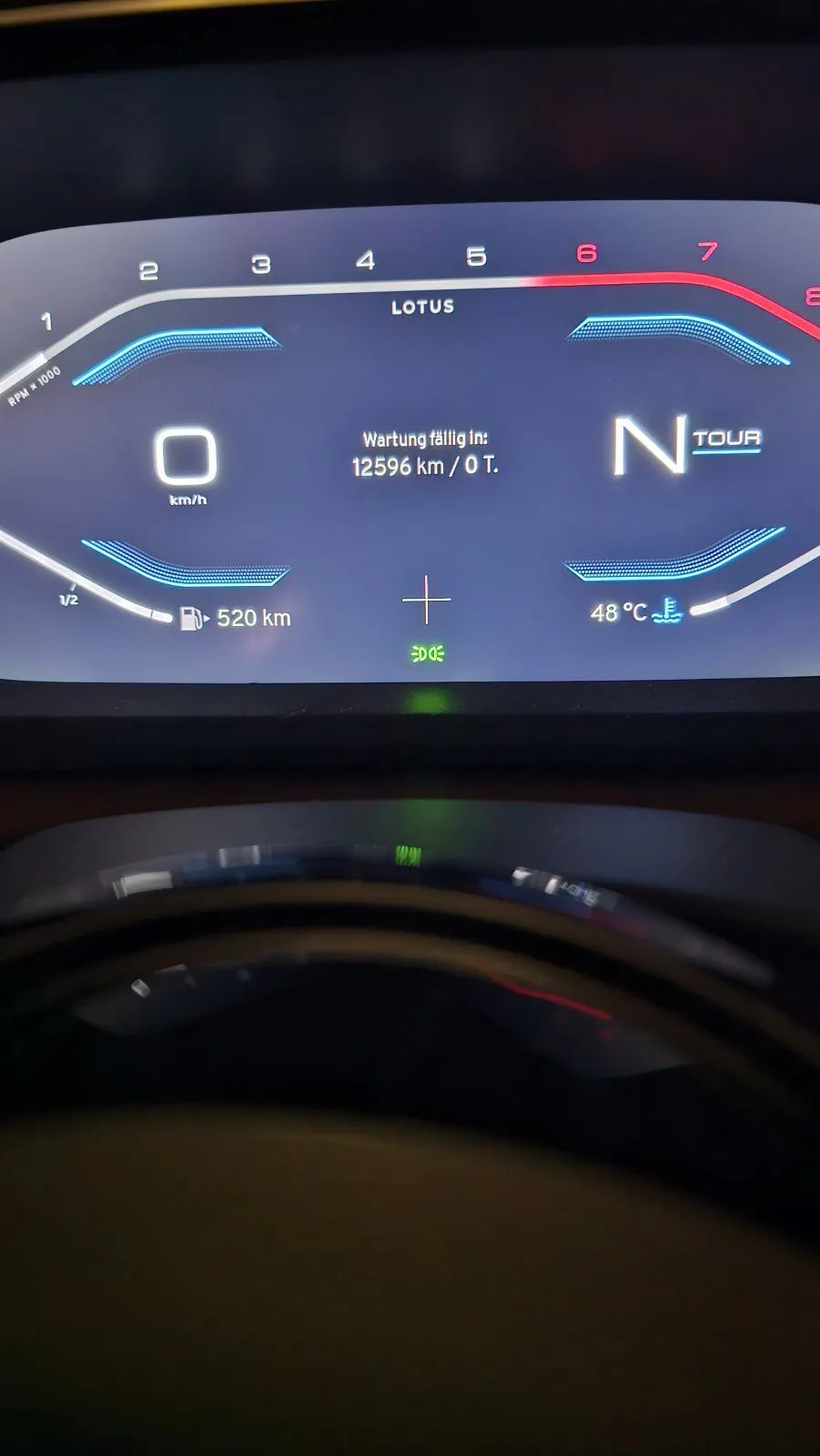

Hello. I got my new emira in october 23. Now it shows in display during start procedere that I have to book a service. I called my dealer and he said this is kind of an issue that lotus made after building was finished. Does anybody know how to delete this issue by myself? I don't like to go to my dealer hundreds km away from home. Thanks.
Hello. I got my brand-new emira in october 23. Now it shows in display during start procedere that I have to book a service. I called my dealer and he said this is kind of an issue that lotus made after building was finished. Does anybody know how to delete this issue by myself? I don't like to go to my dealer hundreds km away from home. Thanks.

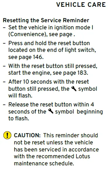

From the manual:
  • #6
OK, but still there is only the notice that I have to book a service... the tool as shown in the manual didn't appear yet, so I propably have to wait until it appears...
  • #7
I tried this process several times but it’s never removed the message.
Let me know if it works for you.
Unfortunately it doesn't work in my car either. I still cannot delete this messsge to book a service ...
I finally managed to do this today. The manual is slightly wrong. With 'ignition' in position one, ie just get into the car and slight press on start button, then hold down reset button on the stalk, keep pressed and start the car, after about 10 seconds a yellow exclamation mark will flash, as soon as it does release the reset button. This resets the service to 365 days.

It worked after several tries. I guess the key was press "reset button" and then immediately start engine before message in display shows "reset all warnings"...
