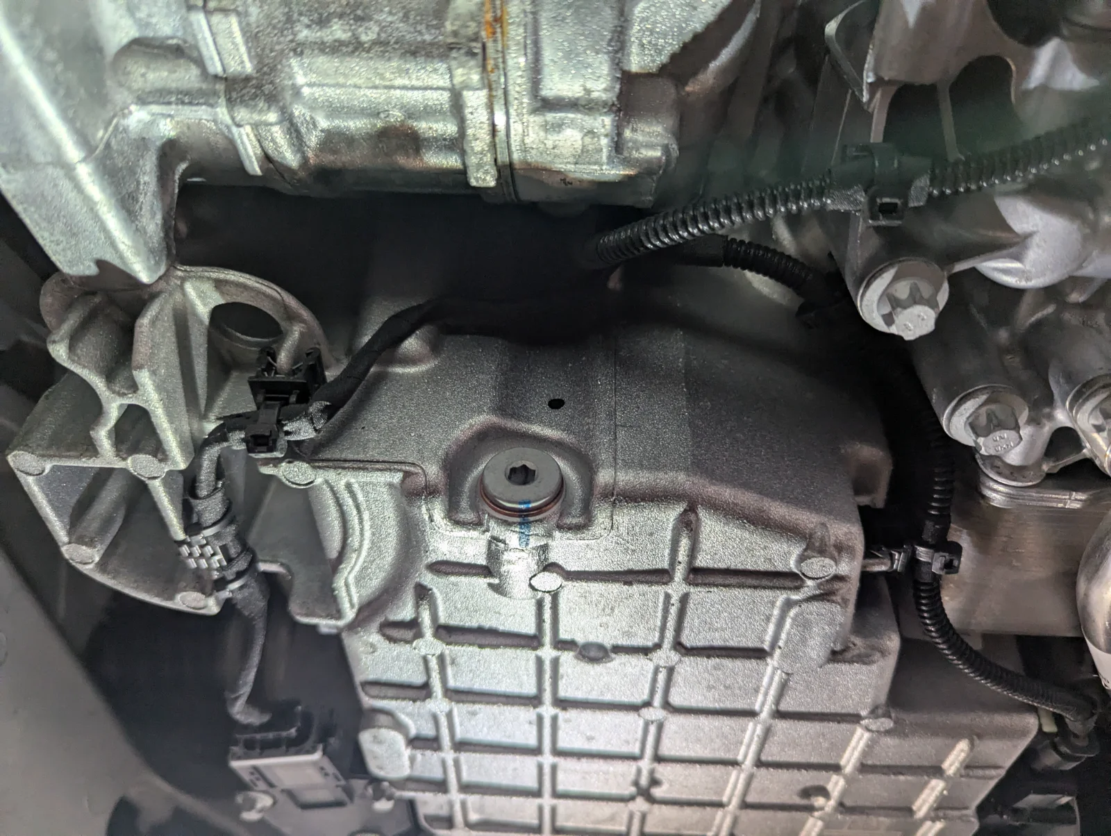

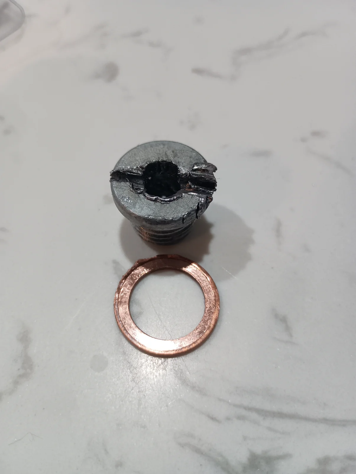

I changed my Emira oil at 1000 miles. Took me several methods to remove the oil drain bolt because it got stripped. Eventually got it off by sawing a slit on the head, then used chisel and hammer to break it loose. I replaced it with a drain valve, so now I only need a wrench for the oil filter housing.
it was stripped upon removing it for the very first time? :unsure:
