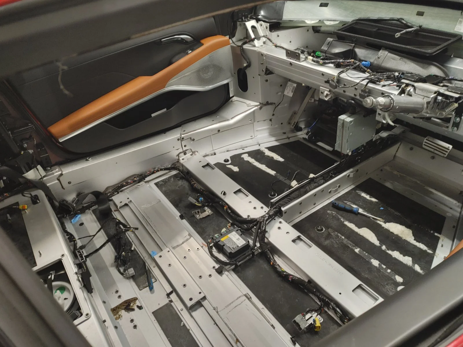

They initially found a few error codes for EVAP, other sensors and the AC which had been temperamental. They checked the sensors and found nothing wrong so cleared the codes and took it for a test drive. During the drive things started out ok but the AC started playing up again and the engine overheated.
Further investigation found corrosion of the wiring harness terminal in front of the drivers side and will require a complete strip of the car and replacement of both harnesses. This is a 25 hour job and the 3/4 harness (the bigger one) is not in stock.

After 4 weeks of almost daily phone calls with them I've got nowhere. No one I have dealt with has been able to tell me what the cause of water ingress to the harness terminal was or whether it would happen again. I "politely" pointed out to them that if this happens every 6 months because of a design/manufacturing issue it makes the car worthless. The repair is not trivial at 35 hours of labour and stripping the car down. They finally came back today with a valuation for my Emira as part exchange for a new one. Needless to say I wasn't happy with it, particularly as I was offering to buy a new car to resolve the situation. To be honest, given the financial hit to me of not having the car for what would be 6 weeks, I felt like they were taking the piss.
HOWEVER, I called B&C (who are brilliant) to discuss the technical ins and outs of the issue and discovered that there is now a recall for this which is linked to the water getting into the HVAC as discussed at length elsewhere. I have also had the HVAC resistor replaced because of water ingress last year. I strongly recommend that any of you who have had the HVAC failure and replacement to get the terminal assessed for corrosion.

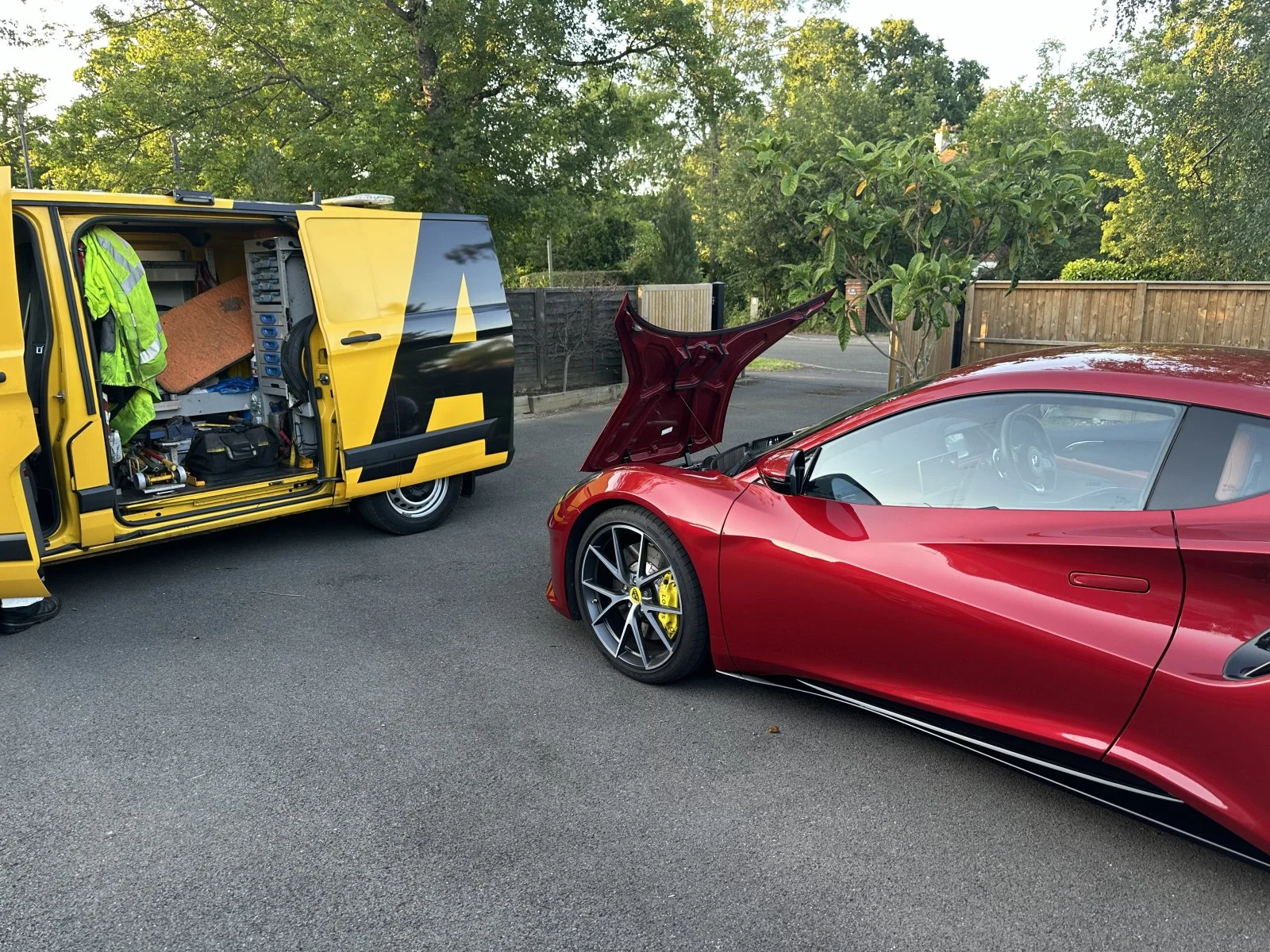

Well it lasted 7 days!
This morning it wouldn’t start. Initially it showed the “key not in car” error. Subsequent attempts showed no error messages but pressing start did nothing. No amount getting out, locking, unlocking and starting again would resolve it. The dash and central screen came on when I opened the door and CarPlay started, ignition mode 0. However, holding the start button for 5 seconds did nothing. So it won’t go into the different ignition mode 1, 2 or start the engine.
I tried with both keys which unlock and lock the car and I had been using it every day as well as putting it on trickle charge on Saturday. It has started first time since getting it back 7 days ago and then all of a sudden nothing. The battery was at 12.8v this morning. I also waited 3 mins between attempts as per the handbook.
I have had the intermittent starting issue before but I was able to change ignition modes and locking/unlocking always resolved it.
