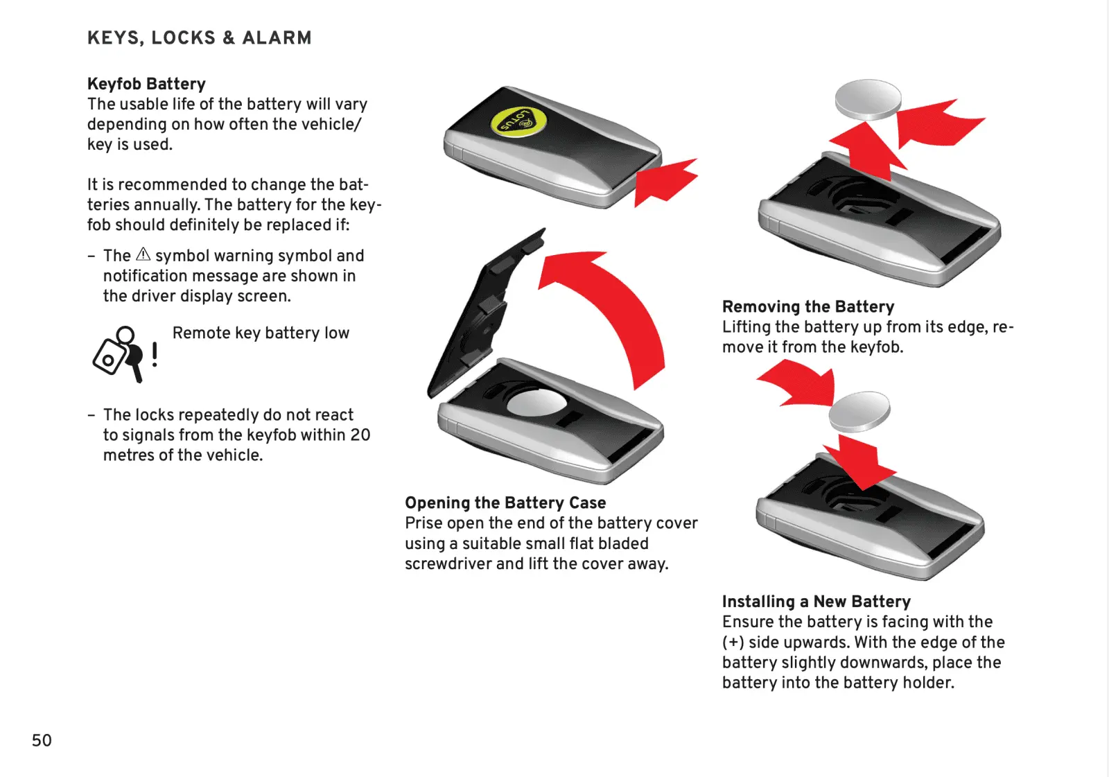

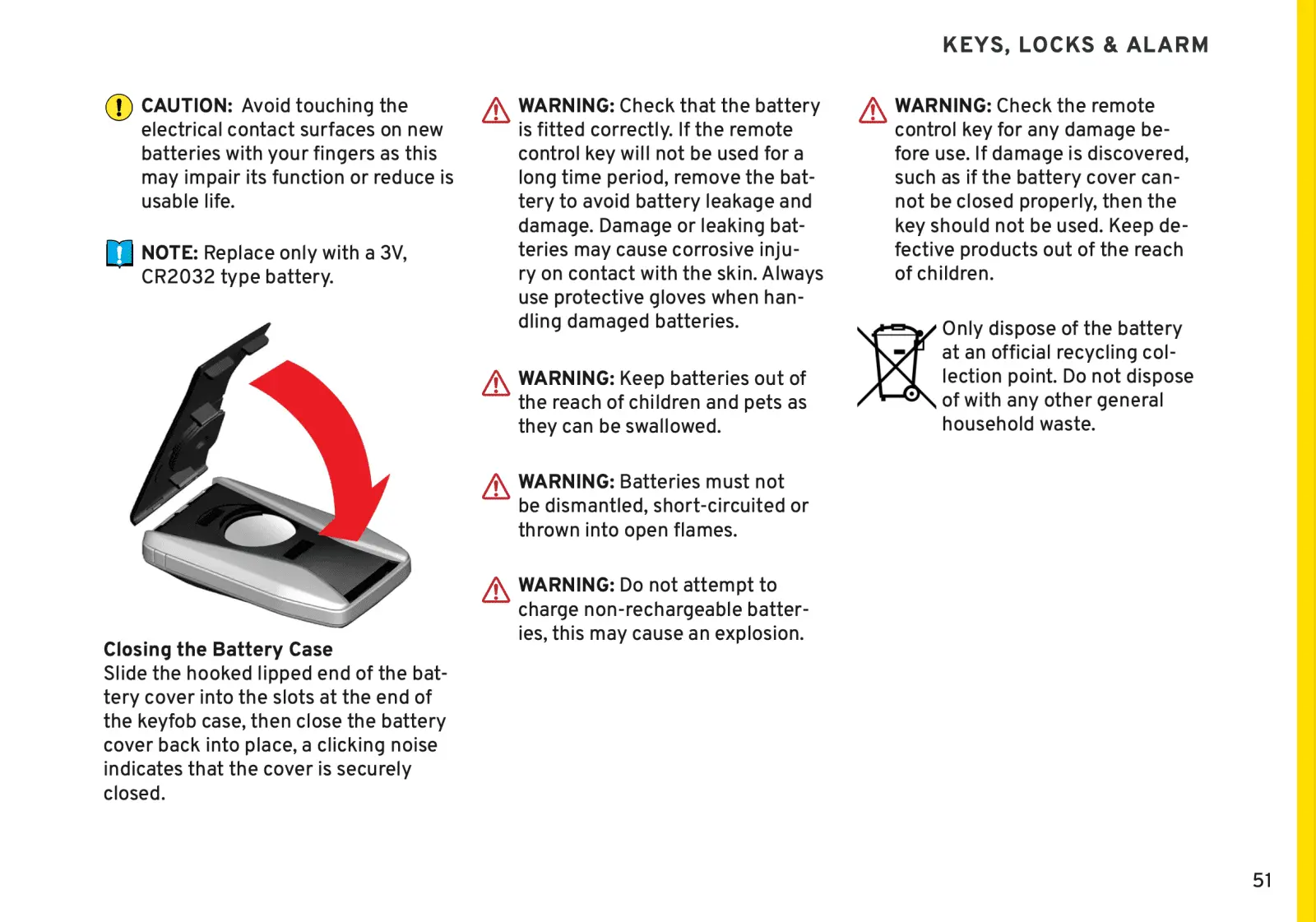

Sounds like you may have pulled the wrong side off the key.
Such a shame this stuff isn’t covered in the Owner’s Hand Book 🤦‍♂️

I just tried this, and it’s annoyingly and unnecessarily difficult. The manual advises using a fingernail, but your nail will come off before the cover will.
Ultimately I was able to use a guitar pick. Well, two picks. One was small enough to pry the edge up, and then I wedged a thicker one into the gap to pry it off. There are four plastic retaining clips: one at the wide end by the lotus logo, two on the skinny end, and one in the middle.
Two quick tips I have for anybody messing with the key:
1. The easiest way I’ve found to get to the emergency key is to open the trap door per the manual, turn the key upside down, and give it a tap with your finger. Should drop out easily. I have no idea how you’re expected to pull it out with your fingernail as the manual instructs.
