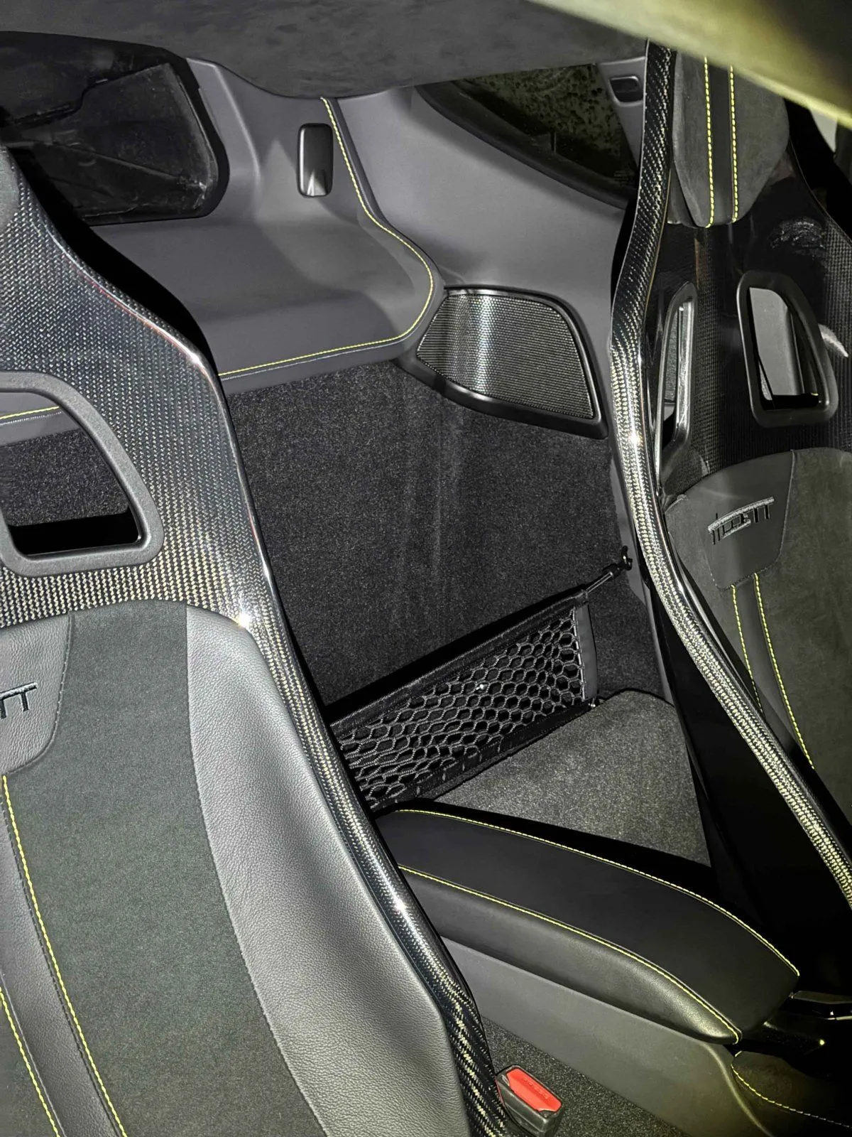

Its not as challenging as you would think. You pull one seat forward and the other back and you get a large gap through the middle. Because the seats are thin you actually get more space behind the seats.Hopefully it happens and I'll look for it in the future. I need to make use of the storage behind the seats for trips, and having just seen the SF90 in person, I realized that fixed buckets would make that fairly challenging.

Looks incredible! Can you share how you removed the seats and the connectors? Were you able to resolve the air bag light with a resistor?I've got my seats in my Emira and it transforms the vehicle.
B10XL-48.5 with Emira themed trim trim and our soon to be released specific Emira bracket and runner setup.

Removing the seats is easy. Just four star drive M10 bolts in the floor. There are two connectors to prise apart.Looks incredible! Can you share how you removed the seats and the connectors? Were you able to resolve the air bag light with a resistor?

Keep us posted on how you installed the resistor if it works! For the runners, are they the same size of that if the Evora?Removing the seats is easy. Just four star drive M10 bolts in the floor. There are two connectors to prise apart.
The seats are heavy so the first time you take them out, take care to put the steering wheel back into the dash first. You take the seat outside with the belt still connected then remove the lower panel. Unbolt the seat belt outer buckle and receptor. The receptor has a wire that to remove needs the cable ties cutting. The rear lower fittings are removed and replace with M8 ones in our kit to fit our runners. The resistor I’ve fitted. I am still waiting on my car to go back to the dealer and be reset to see if this removes the light.
I’ve been told where to put it and the resistor to use but until they can reset the warning about the missing seat bags I can’t say it works for sure. I’ve been waiting for a warranty part for months so I’ve not had the opportunity to get it reset.
That said, I don’t even see the message now. For me the seats make the car complete, so it’s a worth having the airbag light on.
