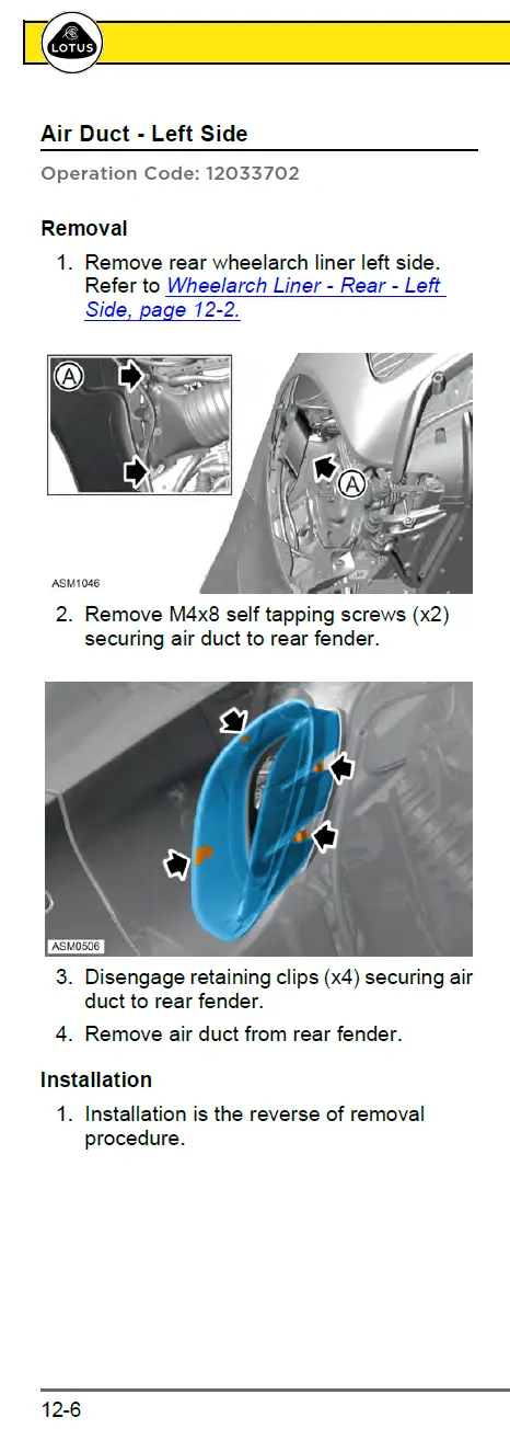

I just got my car back from a local detailer whom I hired to do full car PPF (paint protection film) for me. They informed me that my passenger side air scoop was loose, and showed me that it can be picked up slightly, out of the recessed area.
Has anyone else had this happen? Any idea if it's easy to re-secure it back in place?
I'm not too worried about it popping out, since it's sitting in the recessed area, and air will only keep it in place. However, the thought of one side being nice and snug vs. the other side being all loosey goosey annoys me
