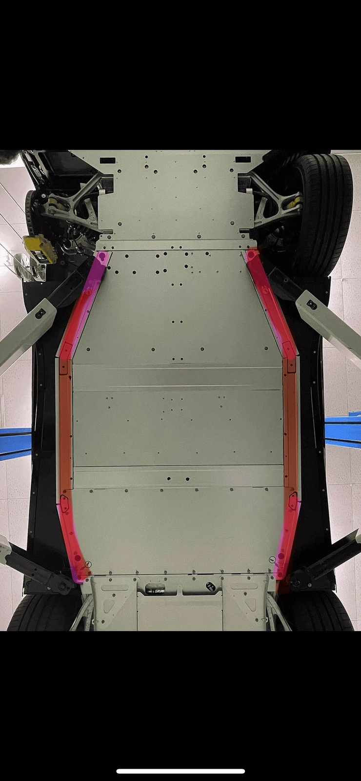

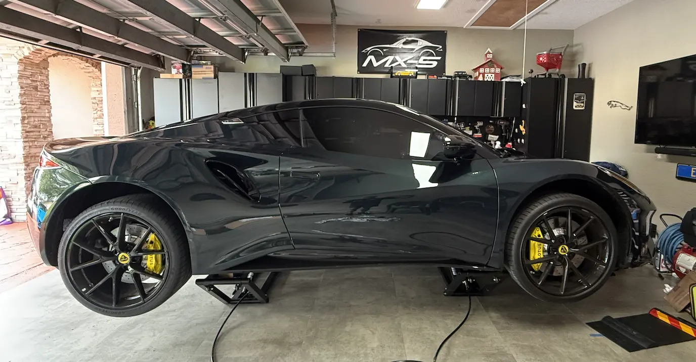

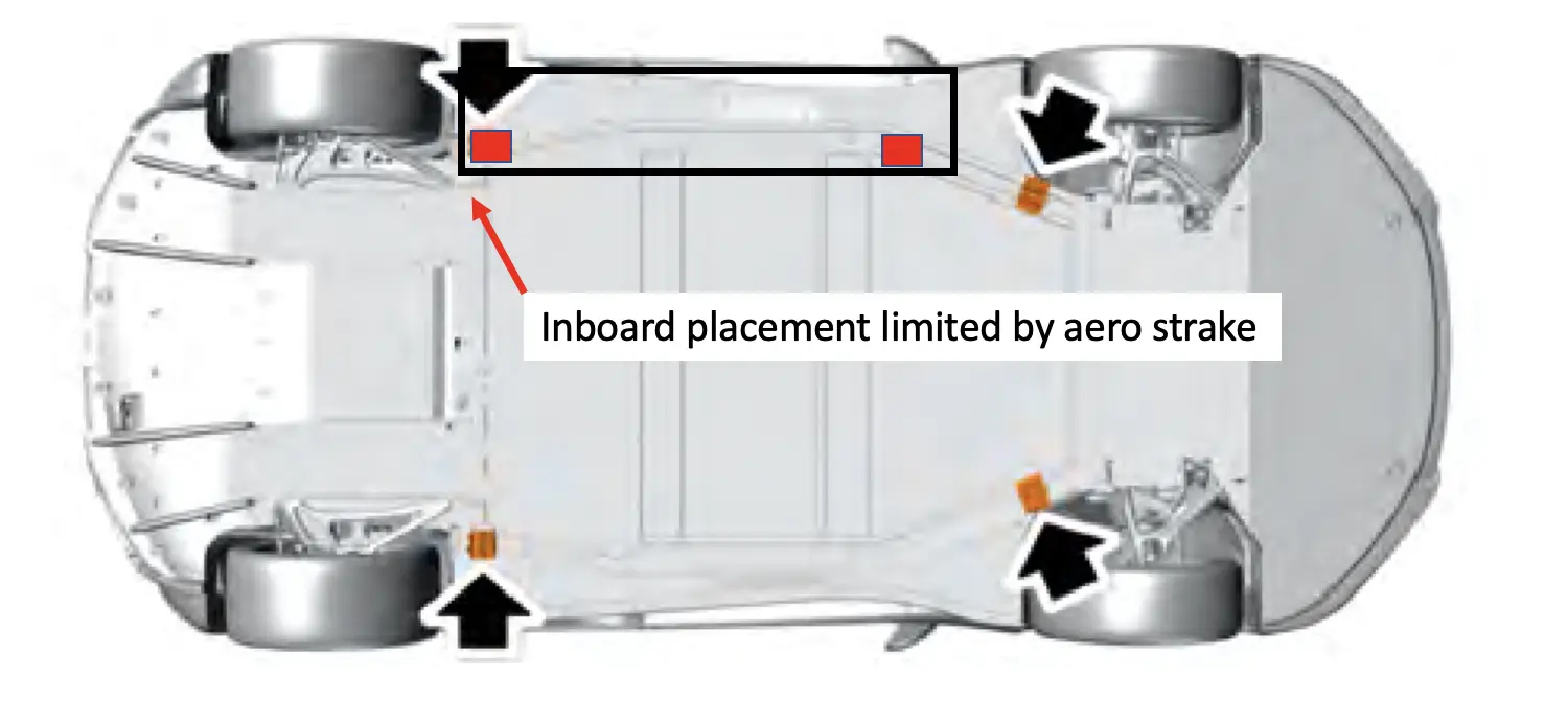

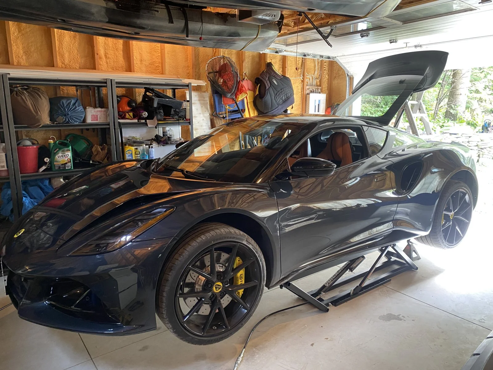

Quick video on the four jacking points for an Emira. Works if you're using a floor jack or a lift. Note: for the lift, the car is really low. We needed to use two extra rubberized pads in front and one in the rear, due to clearance issues.
Video also shows the underside of the car.
