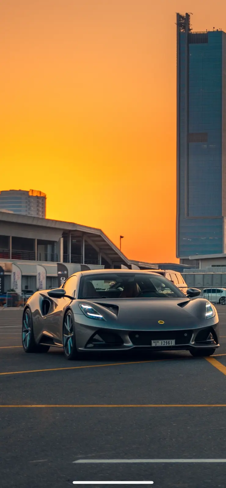

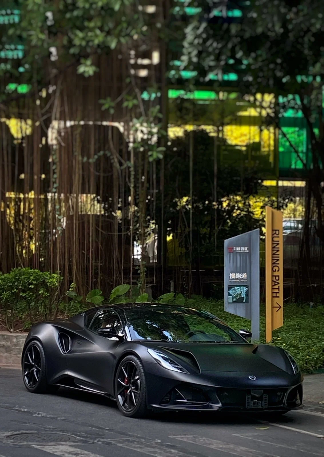

@GRP for customers who have ordered your lowering kit, do you have any sense how much people are lowering their Emiras? 15mm? 20? And what proportion are adding wheel spacers?

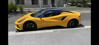

I like the stance on the Eventuri Emira, which they told me was lowered (but didn't tell me how much), and they said they didn't use spacers:
I also like the stance on this one that I found on Reddit:
Any thoughts you have would be appreciated! I want to close the gap and make the stance more aggressive, but don't want to run into issues with scraping, etc..

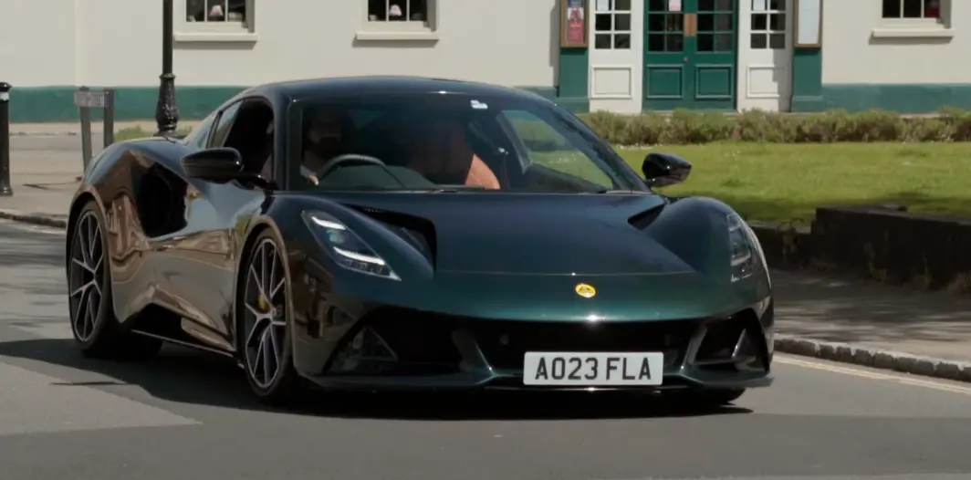

The Eventuri Emira has rather sunken looking wheels when you see it on video(IMO). The Emira is fine at standard height with stock offset, but definitely looks better with some spacers, once lowered.
I’ve had the GRP lowering kit added and the lotus dealer maxed it to its lowest point. They also put on the 12 mm spacers.
I’ve had no problems with any scraping or wheel arch issues. The only problem I have now is tripping over on footpath faults when I park the car because I can’t get my eyes off it. It looks sensational!
