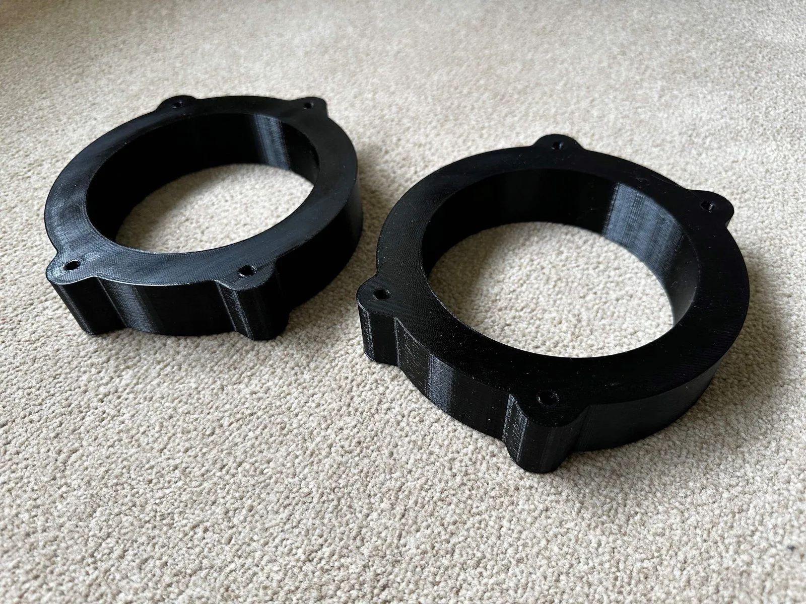

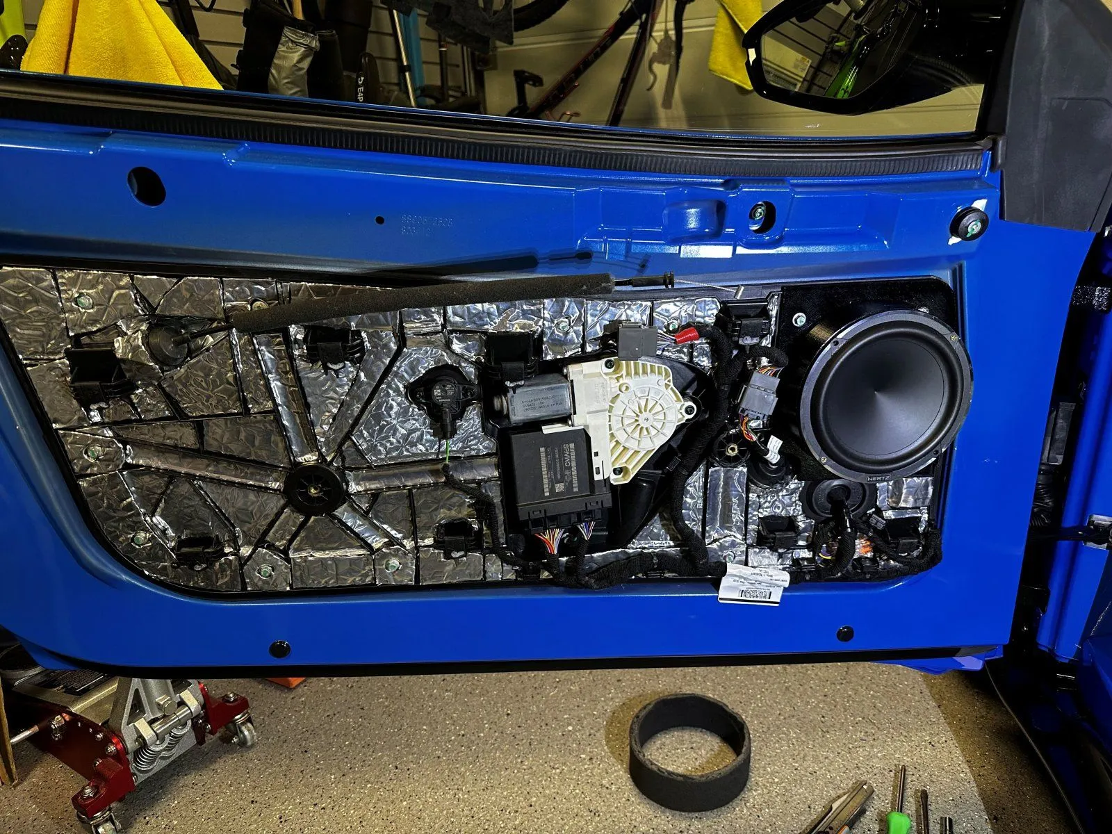

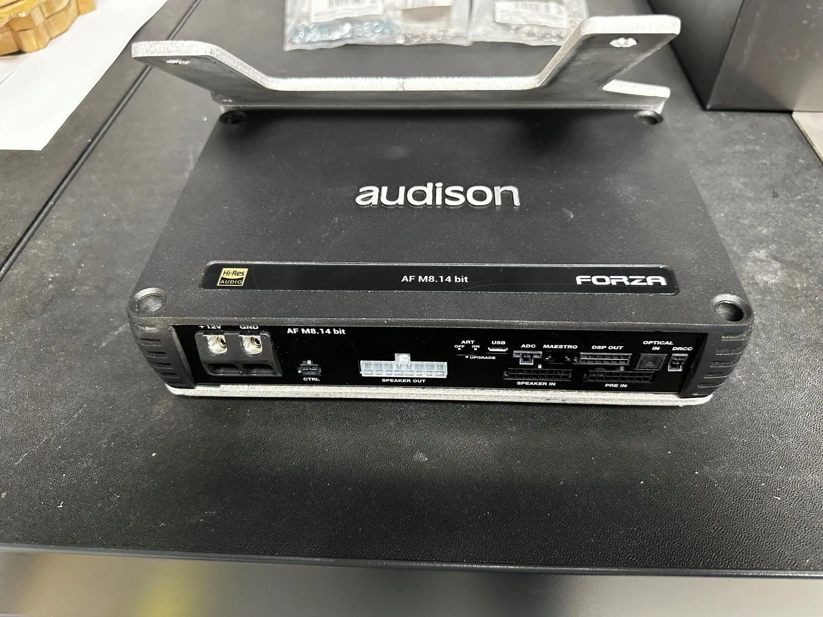

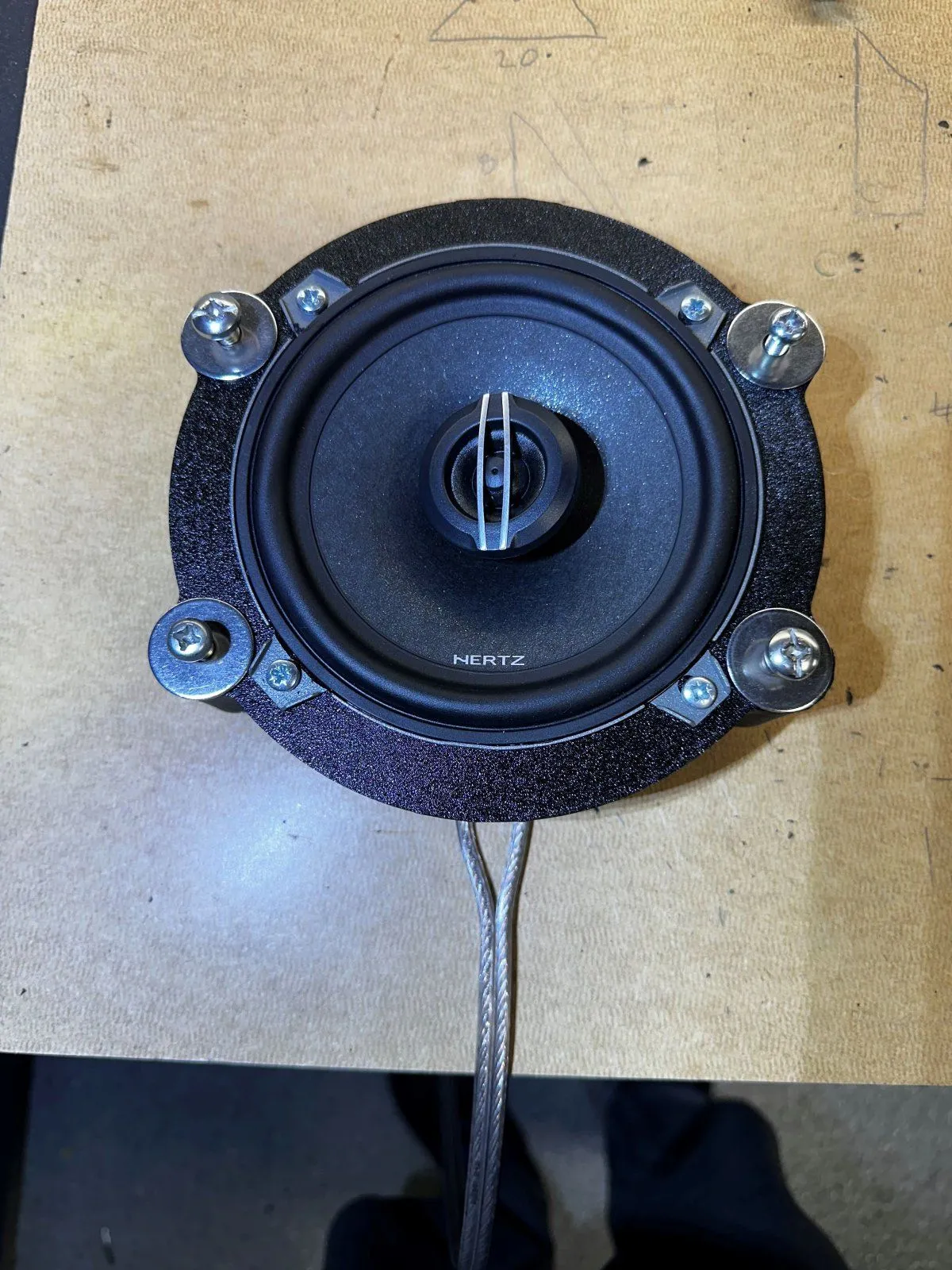

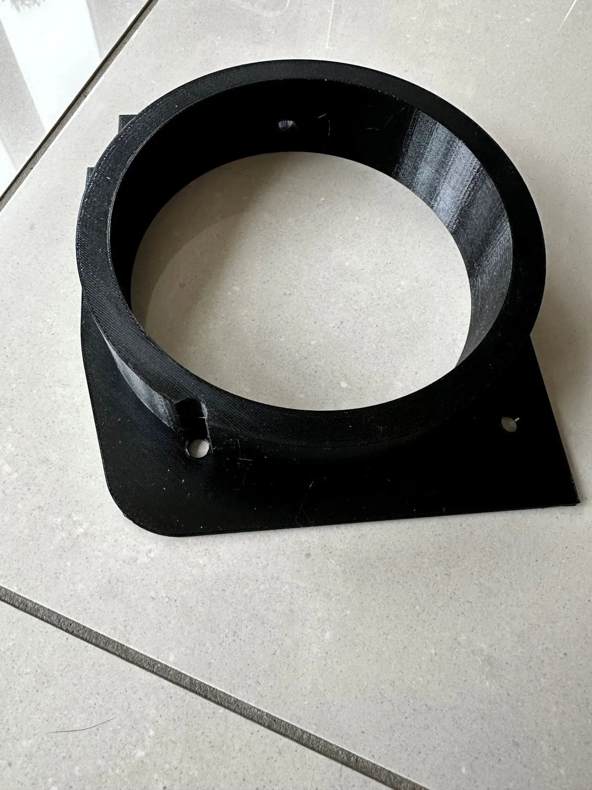

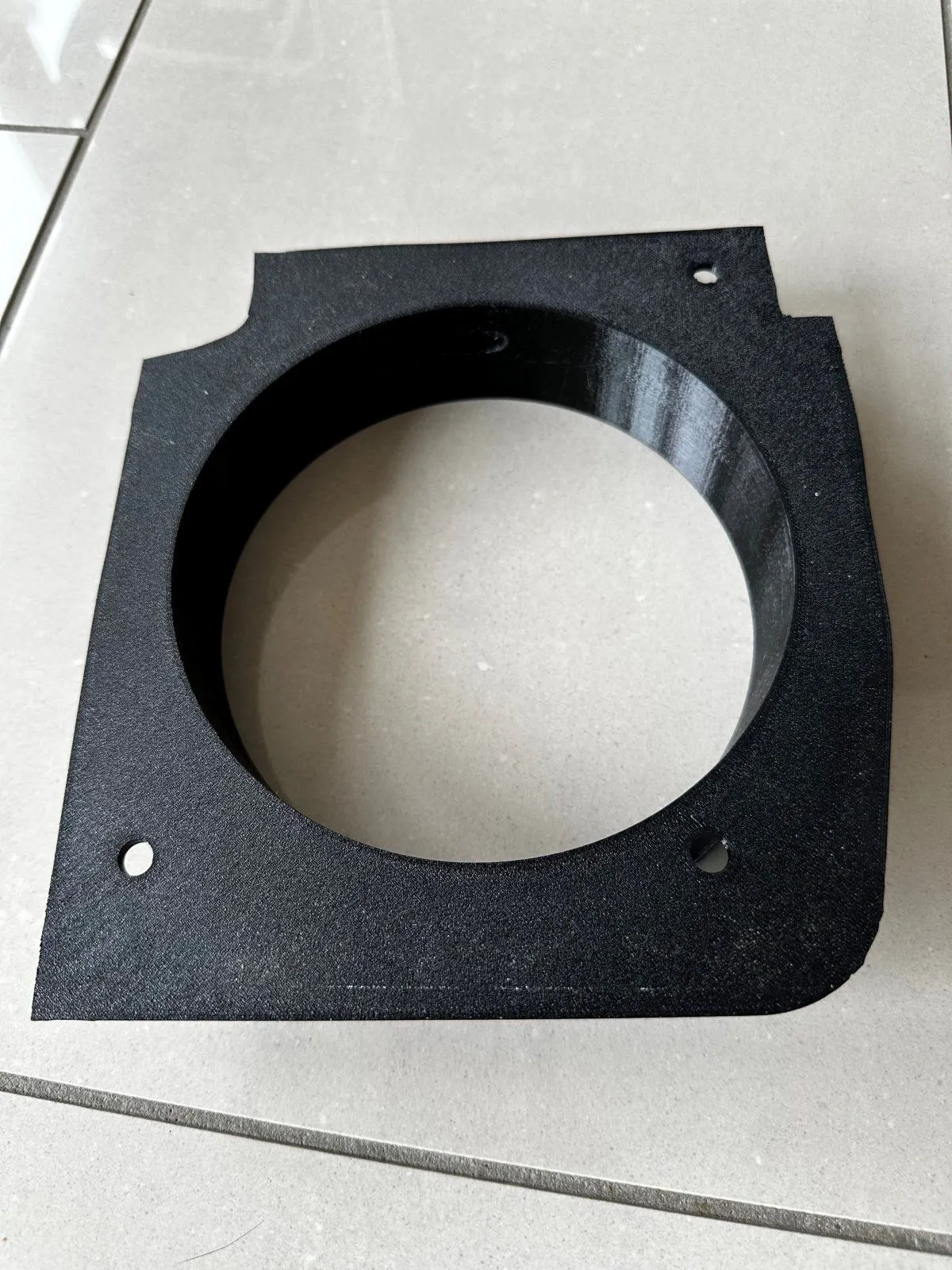

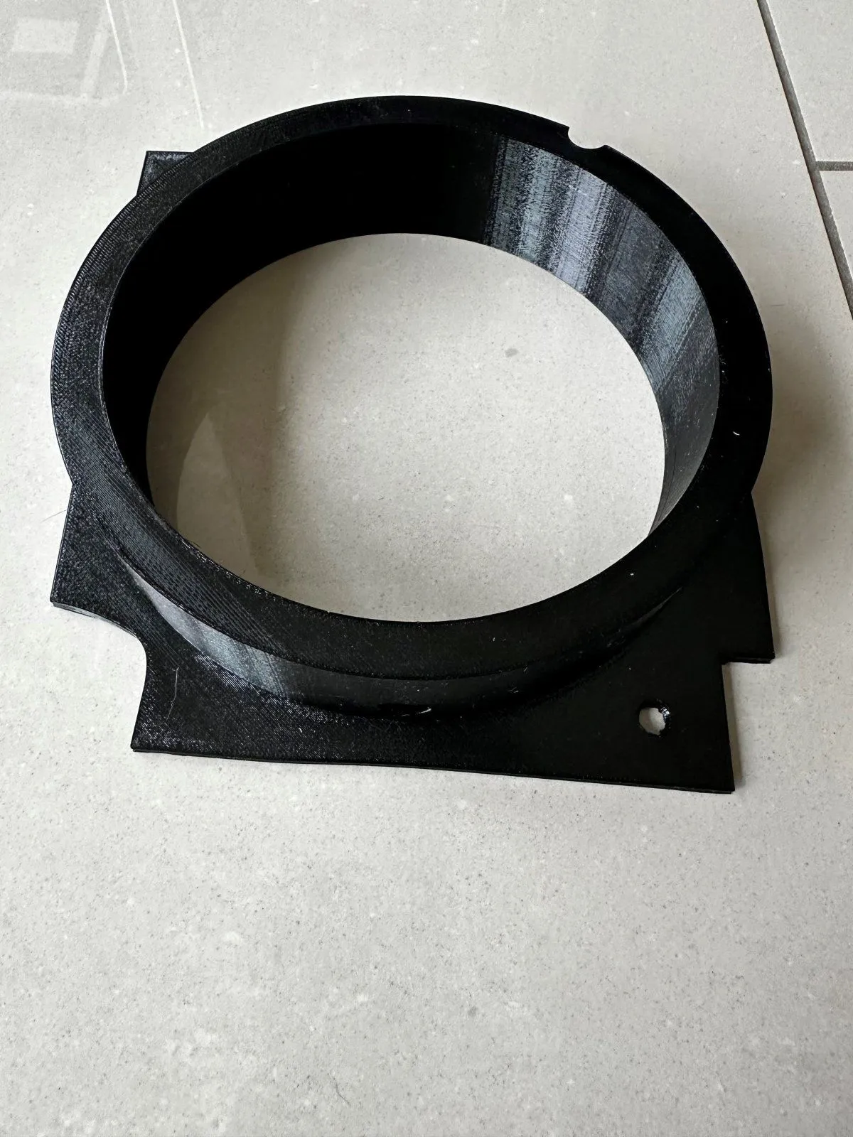

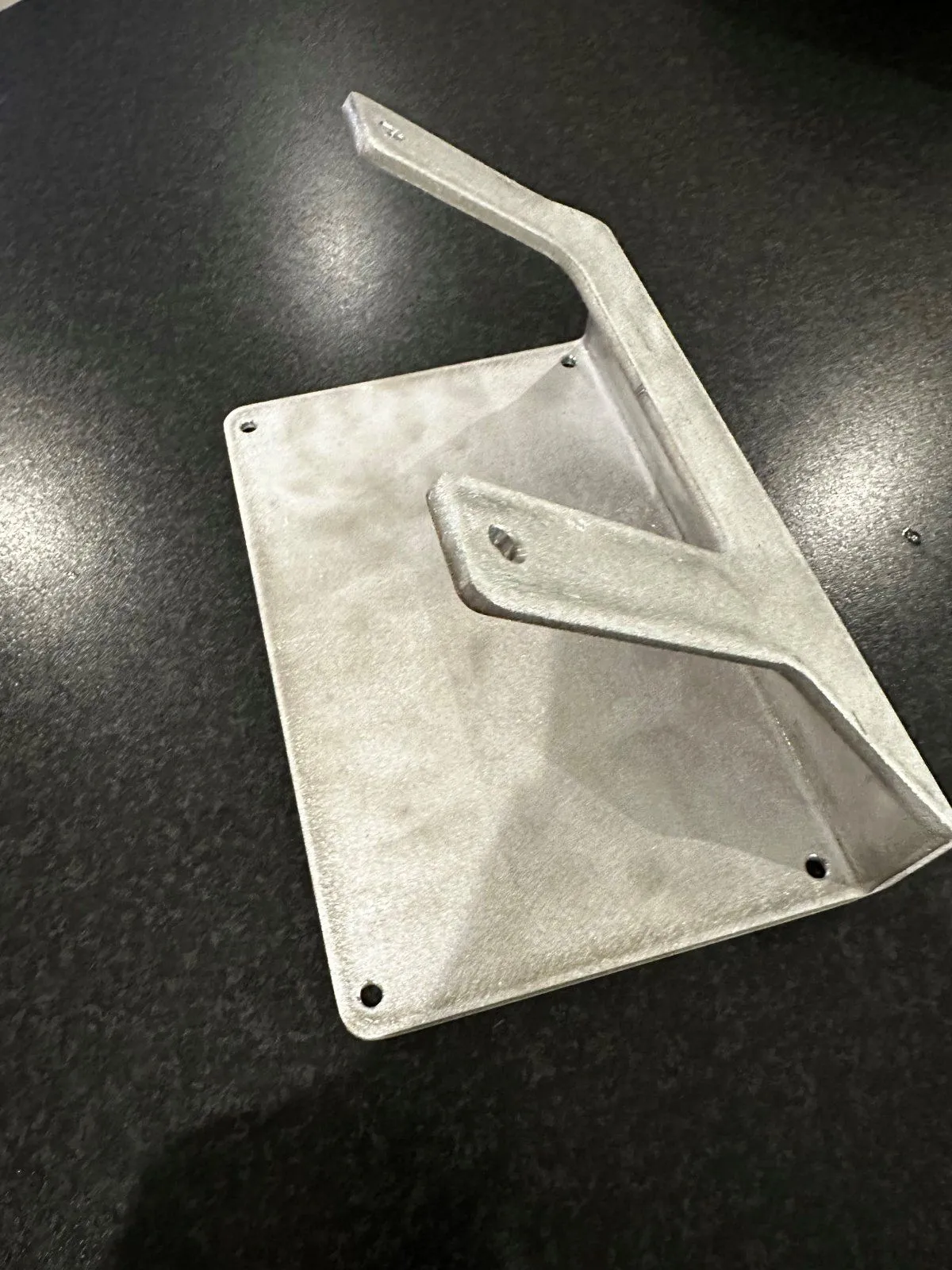

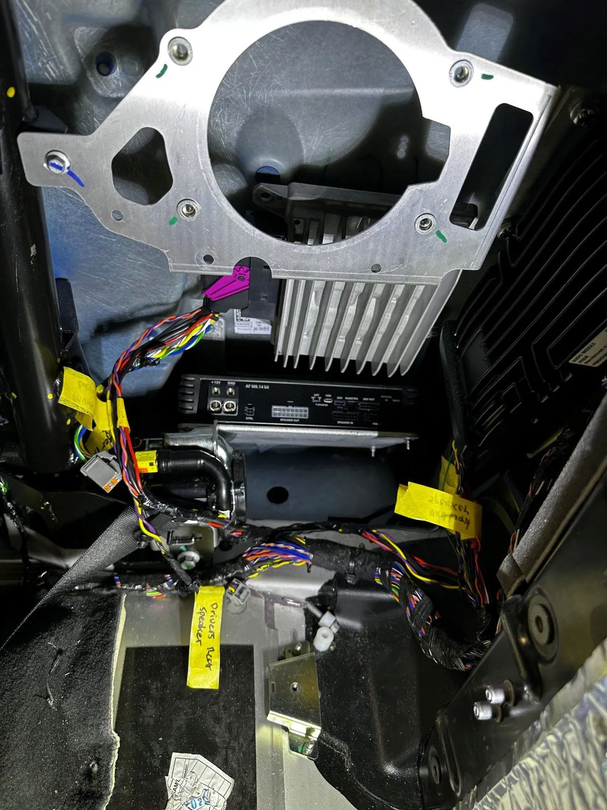

As promised, here are the final 3D printed versions of the front and rear speaker mounts, & Amp Mount, allowing you to upgrade your KEF audio to a far superior system. The front mounts allow you to transform from a 3" speaker to any 6.5" speaker, and the rear mounts allow you to install any far superior 5" speaker.
I’m able to produce both front and rear mounts on demand at a cost of £435 (Including postage if you’re within the UK). The mounts are 3D printed at 100% infill, not hollow or honeycomb.
The amp mount can also be produced upon request for £180, (formed from a single sheet of 5mm aluminium, plasma cut & folded into the perfect shape to mount in place of the cars original sub). All holes are pre-drilled and it’s made to take any Audison Forza amp. A 70mm Stainless-steel blanking plate (to cover the bottom free-to-air sub drain-hole).
Speaker wiring colour codes will also be included, saving you hours of time.
I’ve personally completed this upgrade to my own Emira and the difference is night and day – If you enjoy your music as much as the car, then this upgrade is definitely worth it!
I’m sure there will be many questions, and hopefully I’ll have all of the answers as the installation was completed by myself (plus taken 100’s of pictures along the way should these also be of interest).

These are pretty awesome! I will def be interested in these when I get my Emira.. Nice job.

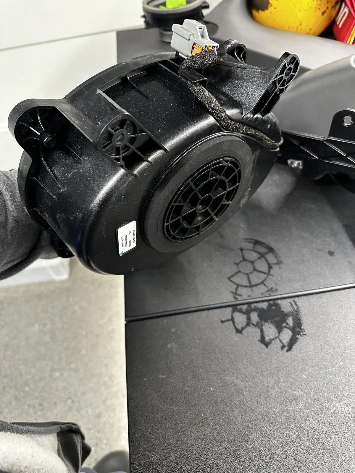

Hi,
My car was also a December 2022 delivery.

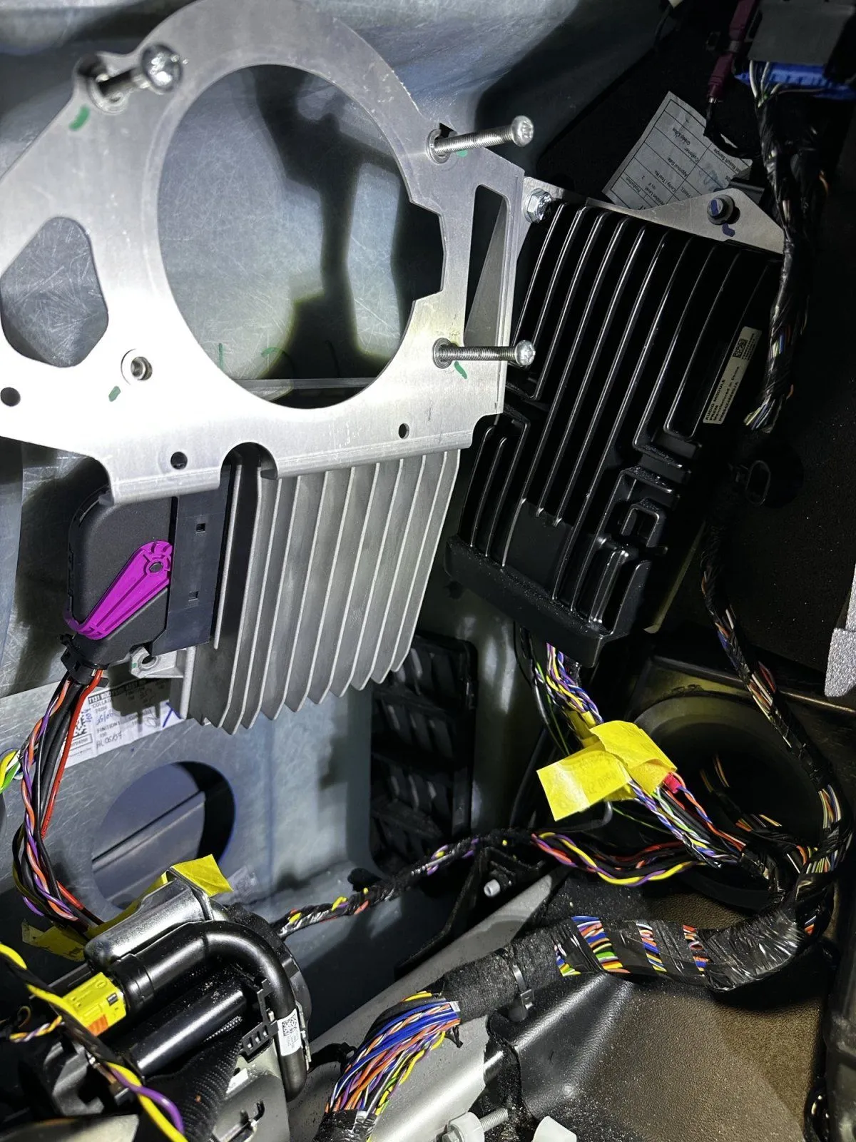

I'm not guaranteeing this is the problem, however, when removing the OEM sub from my Emira, as you'll see from the picture attached, it had water ingress. Here's what I find interesting - My car had been garaged for the last 3 months, it was last washed approx 1 month ago & I don't use it in wet weather (On Cup 2's), so the water sits inside....I suspect over time this may cause others an issue....
The other photo attached shows the two OEM Amplifiers, which (is my understanding) is the upgraded hifi. The Black amp powers the door and dashboard speakers, the silver one powers the two rear speakers and sub. You could see this by removing the pull-out rear access panel on the right-rear side of the car. It can also be identified from the front fuse box located in the left-hand passenger footwell, I think I remember the fuse labelled as "upgraded hifi" or similar - correct name for this fuse is in the handbook that came with the car.

My speakers are definitely run in - I have 6,000 miles on and use the sounds a lot. They definitely improved with use but still sound nothing like this latest demo / loan car.
Very interesting KJW..!! Mine is a daily drive and gets used a lot in the rain - even the really heavy stuff we have had recently. I'm on Sports / Cups too (which gets interesting and was doubly interesting before the wiper fix :-O !!!!!).
Does the driver seat have to come out to access this access panel, as the car is in for a non working heated driver seat with Lotus so it might be convenient to attack all this at the same time!

Hi,
No problem & happy to help where I can.
To answer your question - No, just move the seat forward. The pull-out trim panel is the panel below the rear speaker - no tools required, just a bit of a tug. The same access panel on the other side allows access to the rear fuse box etc.

My Lotus guys hopefully having a good look inside the access panel tomorrow to see if there is the potential water ingress issue.
