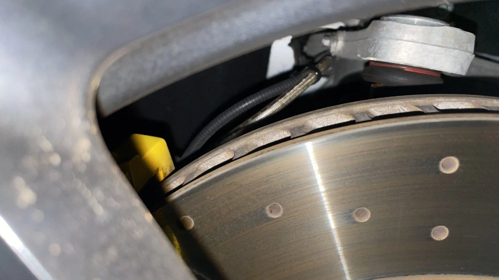

The Emira already comes with DOT4 brake fluid so it should be able to hold up to track use. @Evotion what you might want to look into, is upgrading the brake hoses to the wheels from rubber to braided stainless steel. As the rubber hoses get hot they get softer, so that causes them to expand and stretch more under brake pressure, which is what makes it feel like your brakes are going soft. Braided stainless steel hoses won't do that, so you'll get crisp and consistent braking pressure all the time.
Evora GT came with stainless steel brake hoses. Is that not the case with Emira?

Maybe it was just me panicking from going from abrupt braking feel to to "shit, what has happened to the brakes" :)
The car still stopped - just felt completely different.
