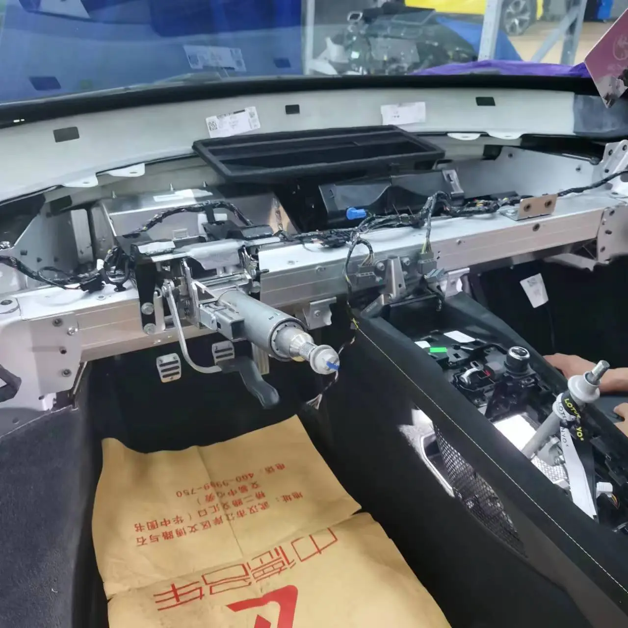

For the AC issue, it probably because of the hot air melting the plastic bearing for switching cold/hot air.
And for the repairing, Lotus UK needs to make an order to get the bearing from a Chinese factory then ship to England to pass the QC test. Then they will ship it from UK to NZ.
Hope you dun have this issue
