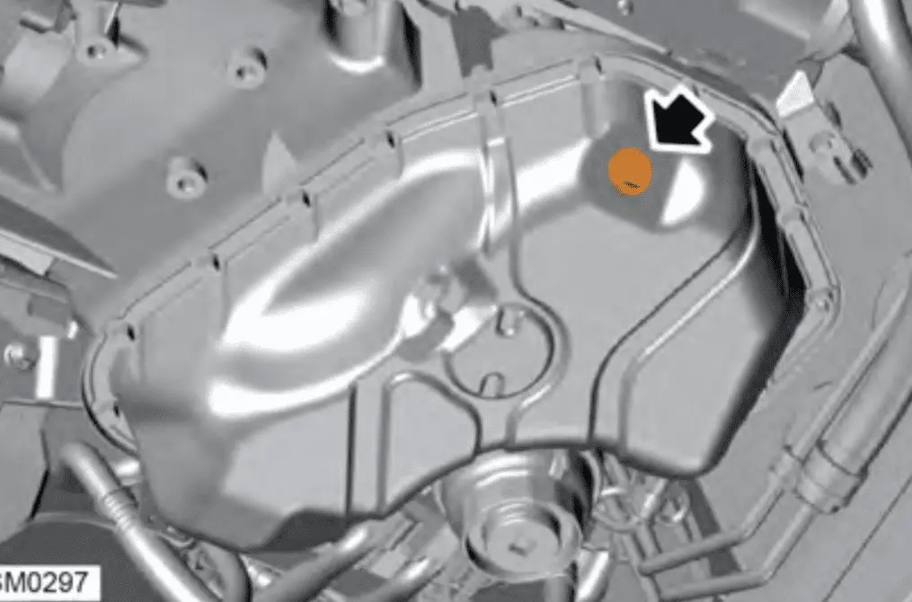

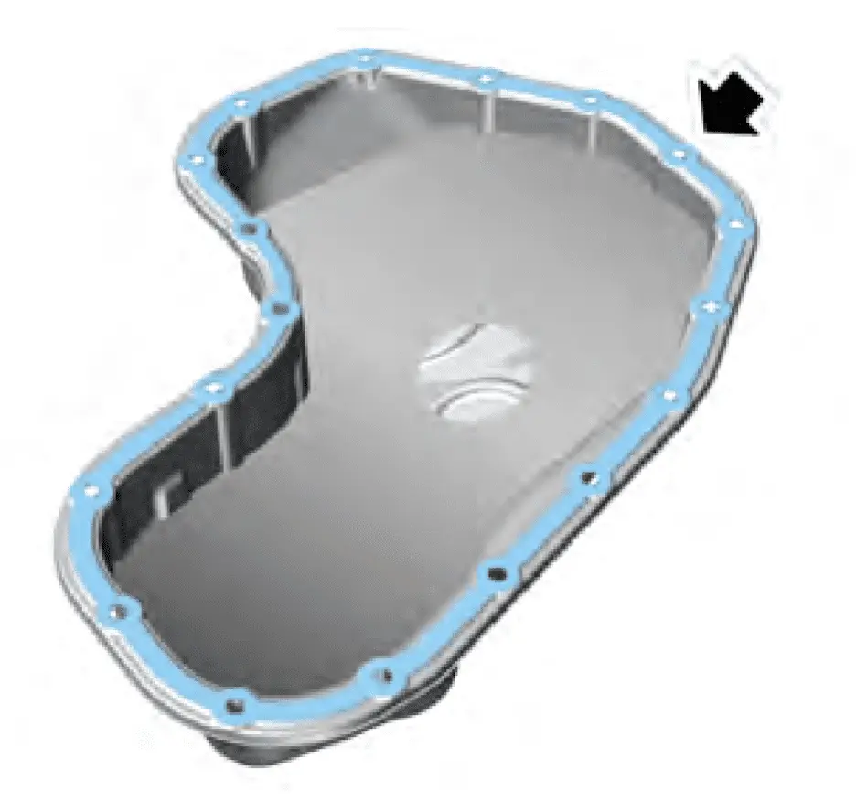

The image of the detached pan in the service notes is sort of weirdly blank in the middle. It's possible that it has a flat plate horizontal baffle? That would explain the flat blank look of the image, if it was actually showing a flat baffle plate that goes full width.
See:
The service manual illustration showing the underside of the pan looks more formed, and twice the depth:
So, no idea what's actually there without dropping a pan on an actual car to take a look.

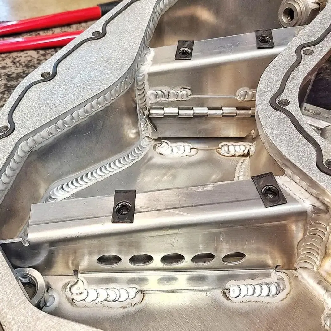

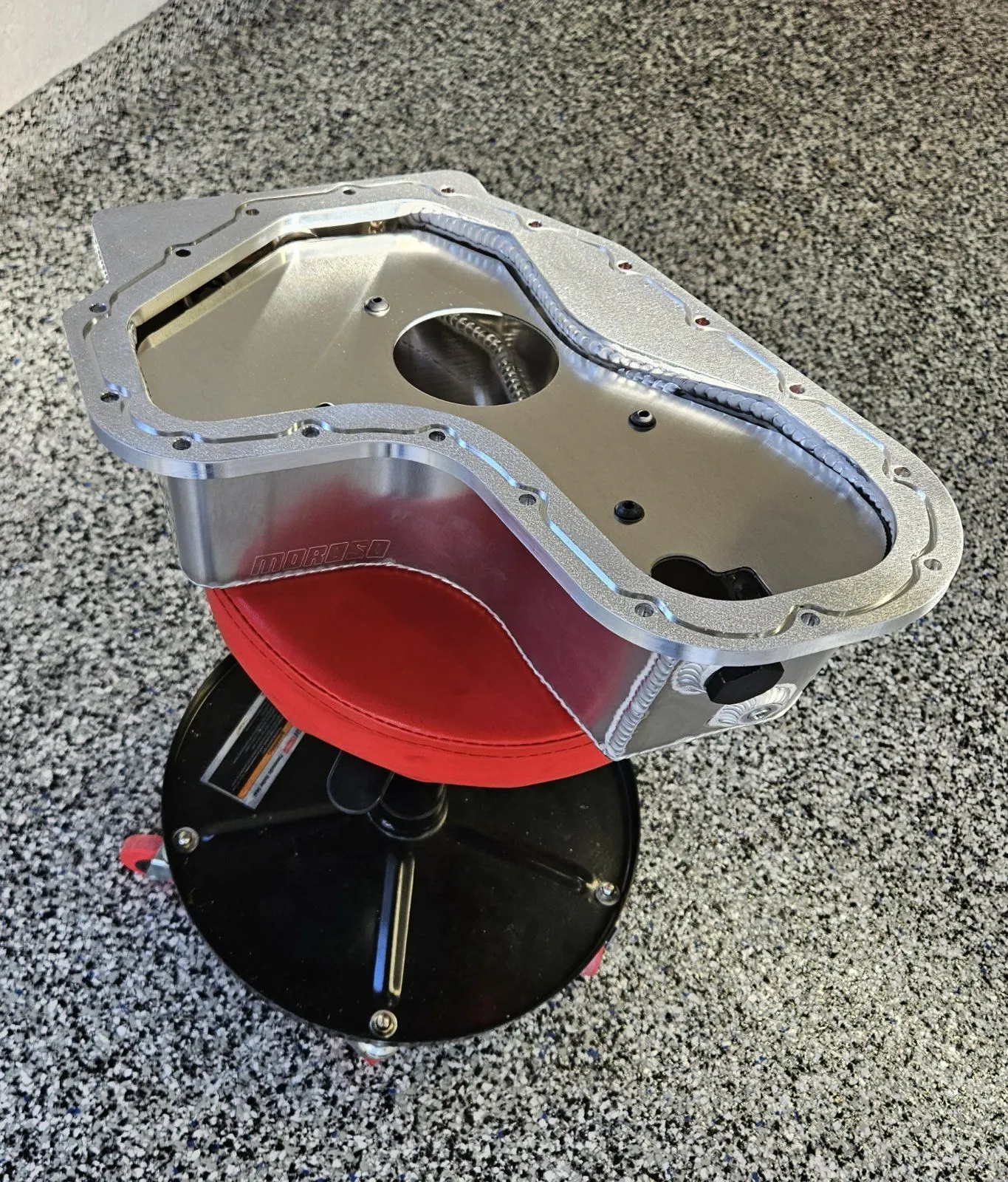

That being said, there are nice upgraded baffled oil pan kits that should fit the Emira (they fit the Evora) from Lotus Motorsport, Moroso, and others. The Lotus Motorsport one looks like a work of art, their p/n ALS5E0147J.
There's even a baffle kit that you can add to the factory oil pan for only $160 that likely gives much of the benefit of the "red" pan. I have no idea regarding quality. https://wilhelmraceworks.com/2gr-baffle
