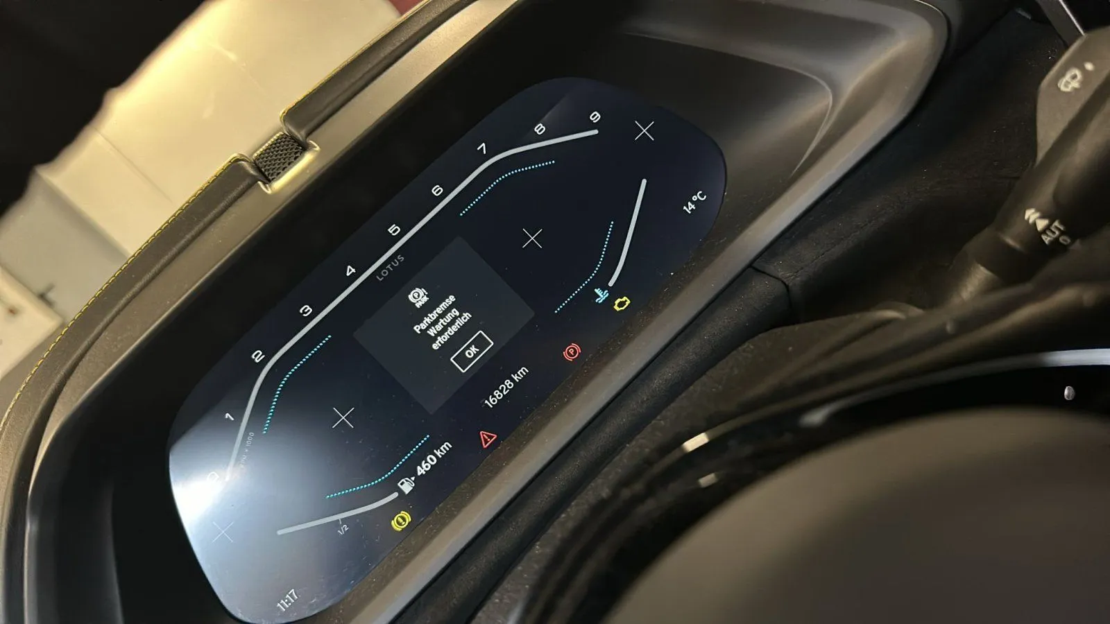

Parking brake service message & wont start - how many others with this issue

Always getting the parking brake error
