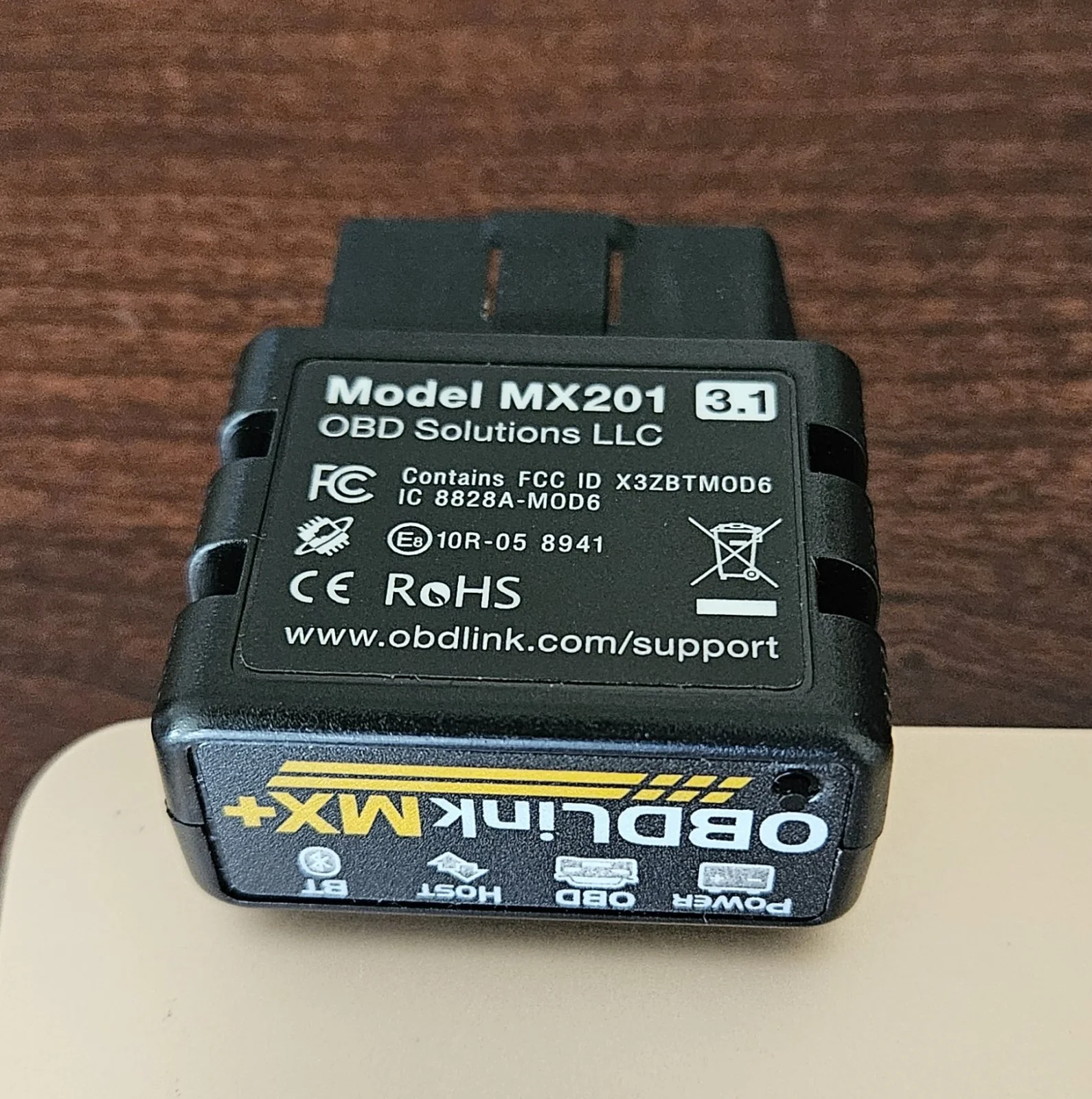

I've had that error code probably five or six times. After the first occurrence, I took it to the dealer and they said everything was fine and cleared it. After that, I've had it come back within a day, and sometimes it may take a few weeks. But each time, I clear it with my OBDII reader. I'm not too worried, losing comm or losing ABS is not the end of the world.
