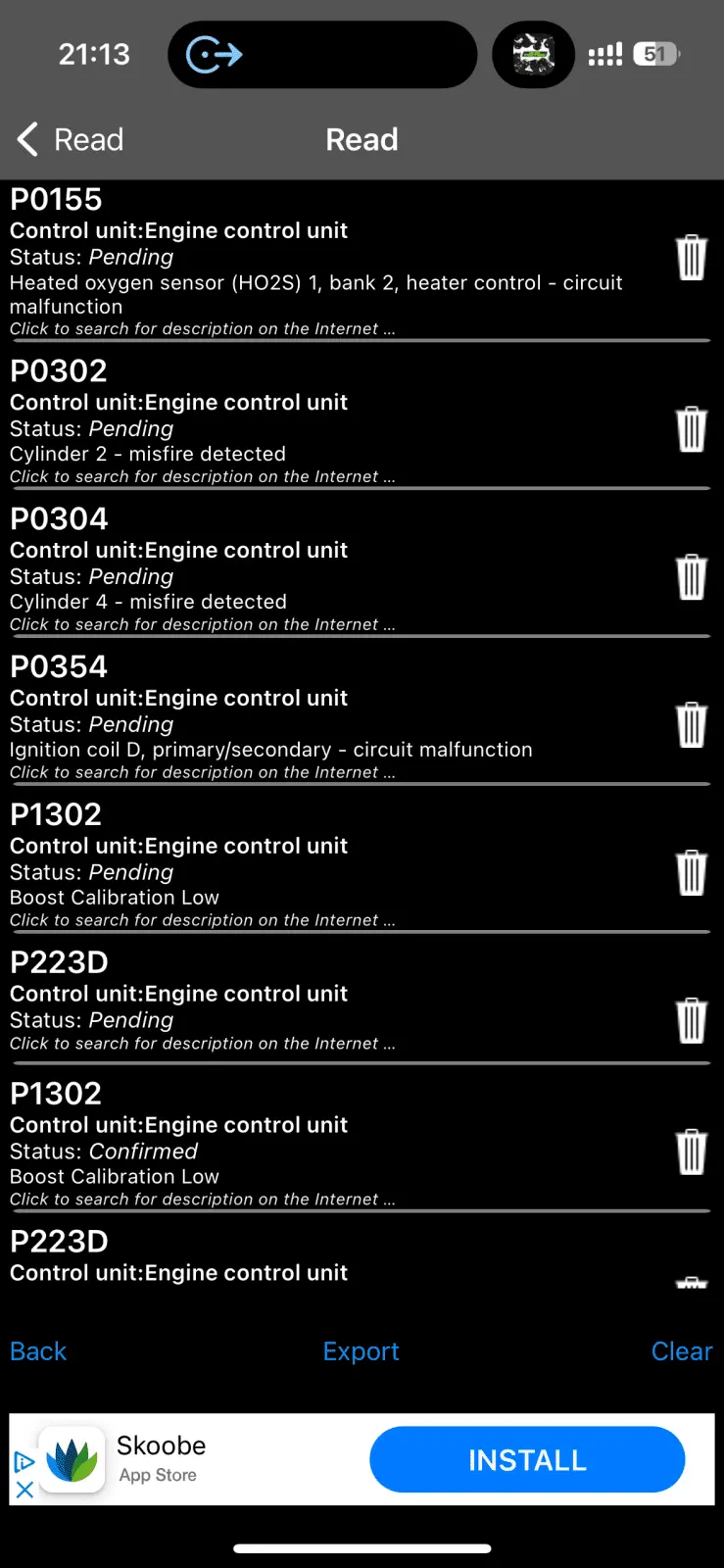

Throwing codes

I've had your exact problem before plus one of my O2 sensors blows every time I wash the car - confirmed, not speculated. I suspect there are multiple points of water entry in the wiring loom and the general (rear?) ABS/brake sensor area, which would explain _a lot_ of problems reported here again and again.

So high pressure is definitely not THE factor. After keeping the car dry (absolutely no washing 😢) for more than 2 months now I had to keep it outside for two days. Colder nights and moisture in the air.. O2 sensor went bongo again. Same behavior like after a wash - car runs fine initially, you park it, start again after a few minutes and the sensor is fried.
This time I also was greeted with many other errors at a later time, car almost not drivable in limp mode. Two ECU restarts later got it home again..
I can confirm the misfires, car definitely drove and sounded like it was on it’s last breath. Almost stalled after going from throttle to idle. I have an appointment for the 11th and will not drive the car till then. Probably will miss the last real summer week here….
