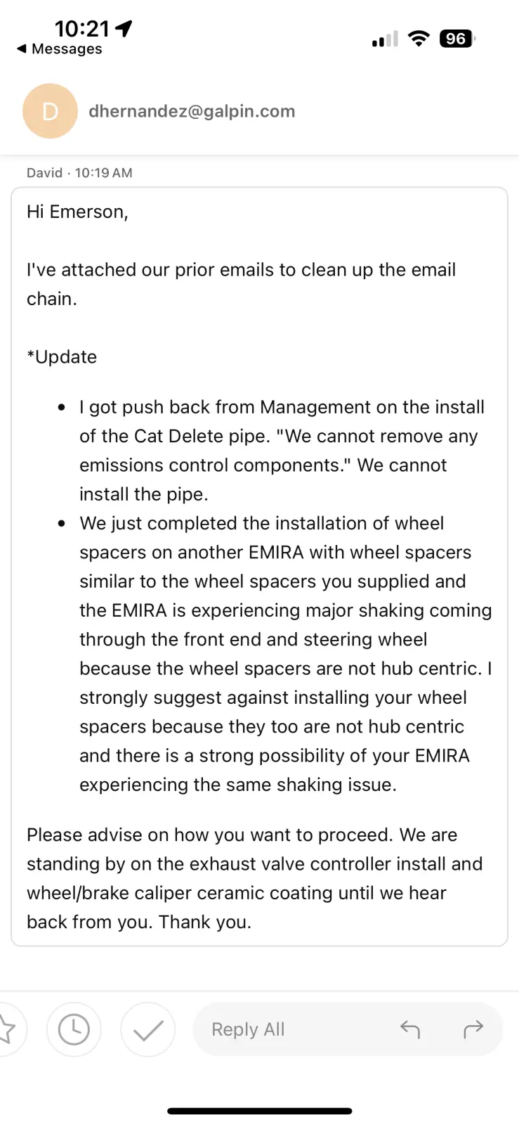

Just FYI my shop is having issues with the GRP 10mm spacers. Getting some shaking while driving.
