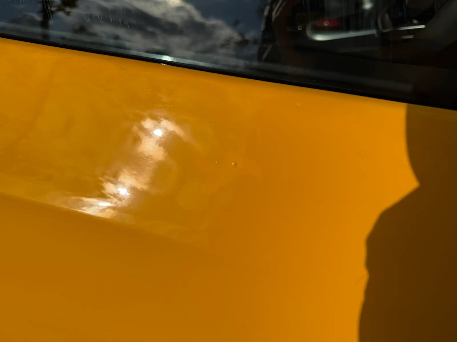

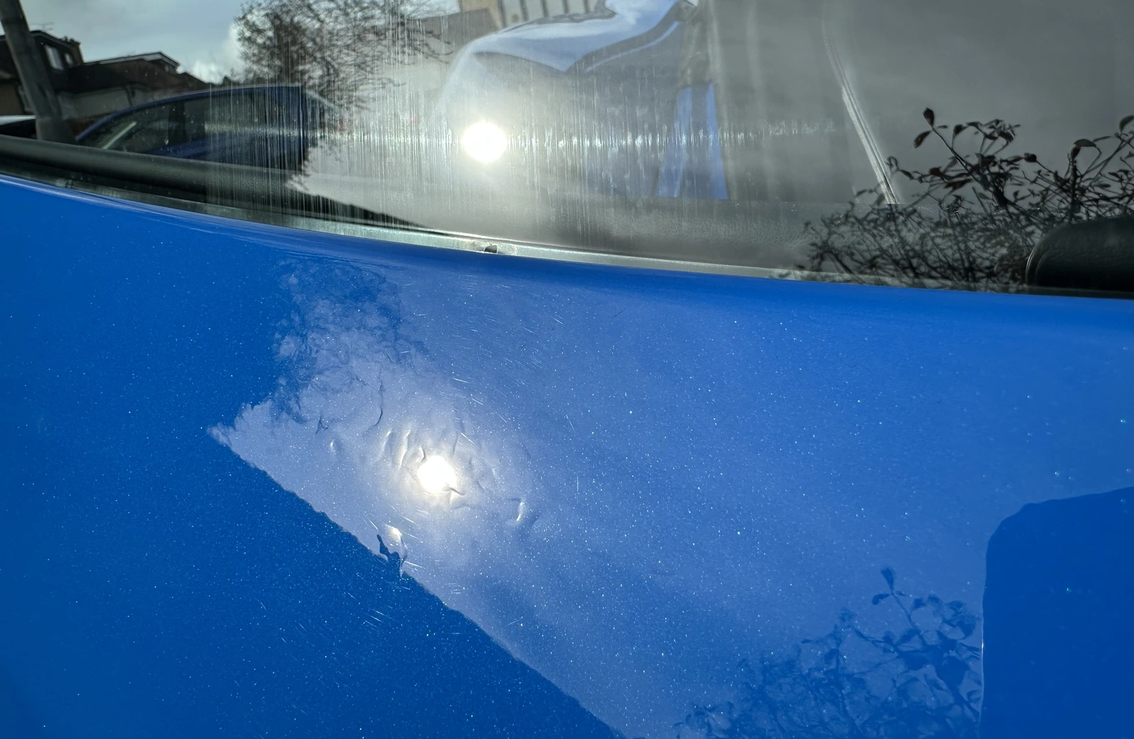

Sept 2023 V6 that I picked up a few weeks ago.
Hadn’t noticed any bubbling when I bought the car, but noticed some this week.
Car is kept outside and it’s been very frosty recently.
What’s the process for starting a warranty claim, do I contact lotus customer service directly? I’ve got an HR Owen Lotus nearby.
Your paint issue looks a bit different to the paint bubbling I have seen in the thread. What you have looks like another issue, probably caused by bad surface prep before painting. Definitely get it looked at though, paint shouldn't do that!
EDIT: Have since scrolled back a bit and seen other people with similar problems to yours. Might be talking complete tosh. Get it looked at. Call up the service centre/the people you bought it from (if you have had it fewer than 28 days).
That’s exactly the same as mine, on both doors. Send pictures and the VIN to a Lotus dealer and they can get it authorised and book you in when the doors arrive (they’re currently on back order)
Thanks for clearing that up. It is a bit different to the blistering on mine!
