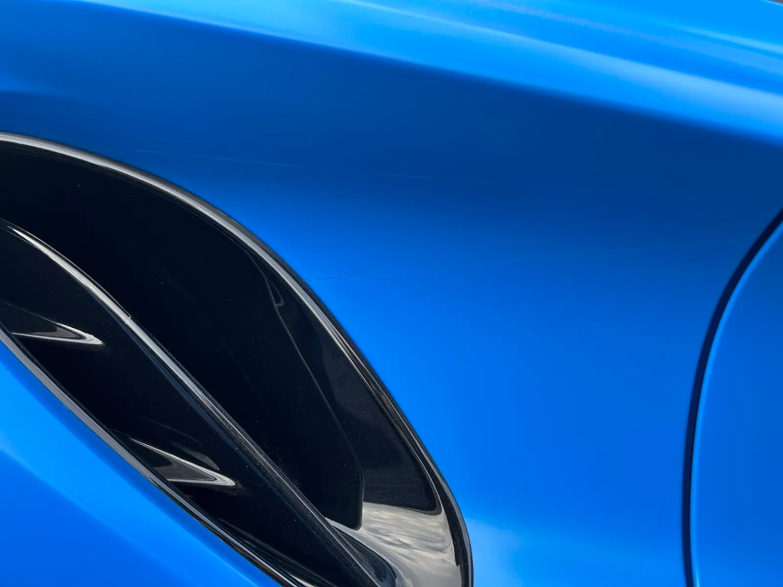

No seam no cut no stretch whatsoever on mine, its all about the skill of the installer. I was only able to find one skilled installer in my area who can pull this off. Mine is a matte ppf so any blemish is highly visible.
Matte is much easier to work with it

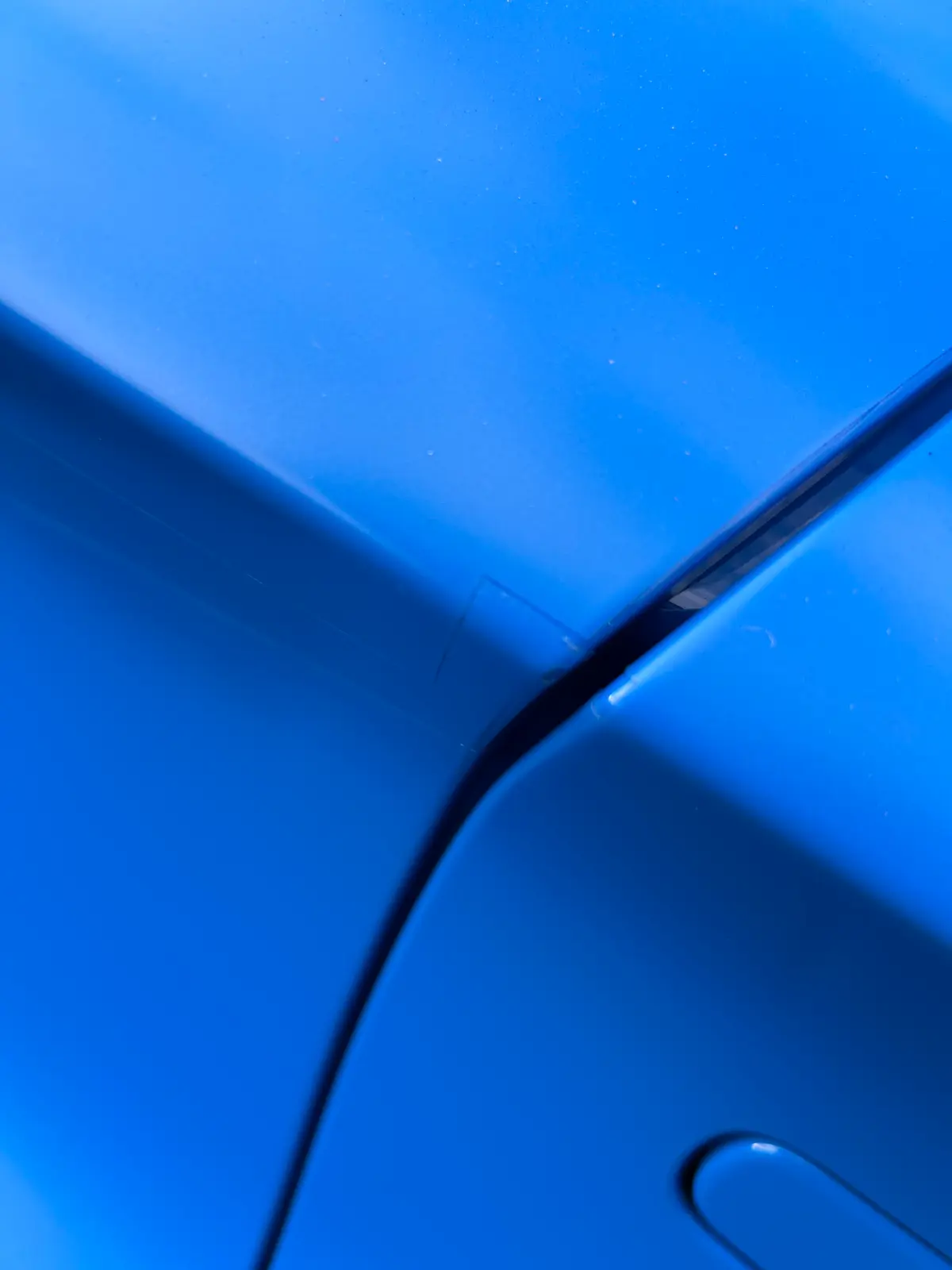

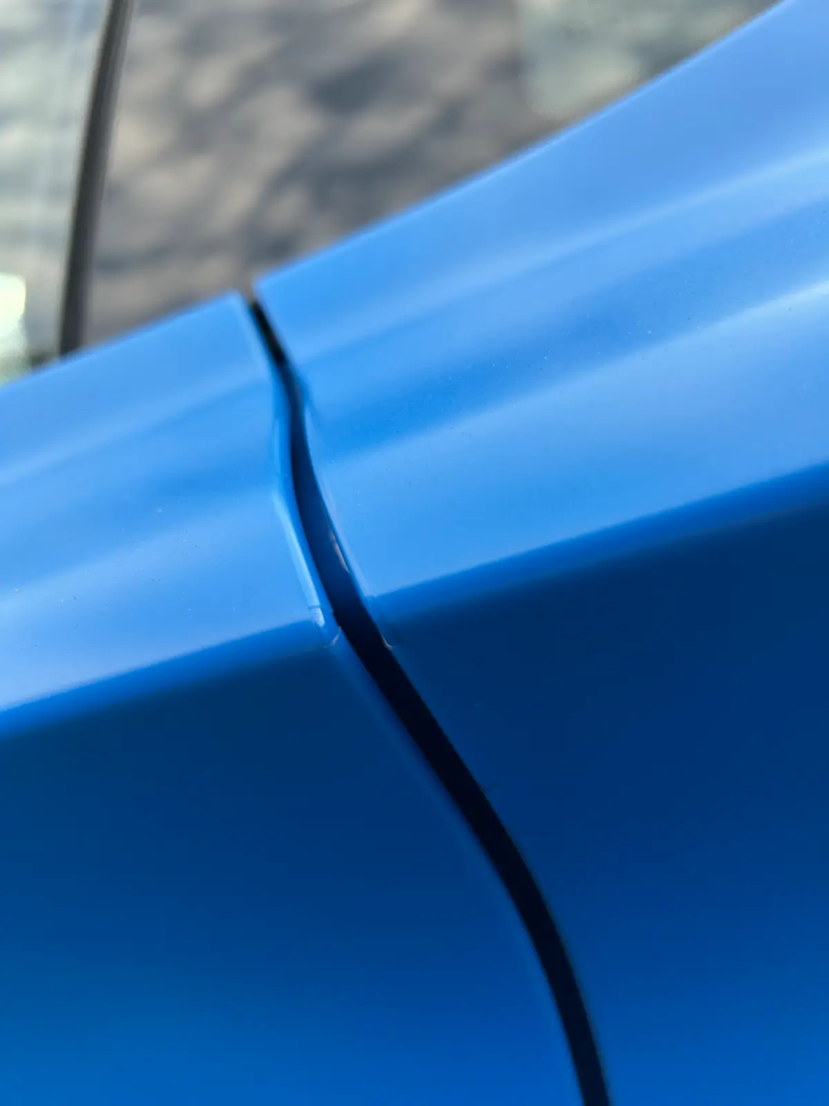

So this is sitting on my dealers lot. To me (who has no idea of PPF), this doesnt look like a very good job when looking at the video in this thread or some of the posted pictures. What do you guys think?
It looks like the standard pre-cut PPF template. The installer looks to have done an OK job joining the lines of the template itself. Pros of having all these relief cuts is the film is less stretched and less likely to lift in high tension areas. Cons are the relief cuts creates edges that can catch dirt/debris and make the lines look more obvious, and will leave some parts of the paint fully exposed.
A better installer would edit the template to fit their abilities. I have less faith in clear PPF applied to a car with no relief cuts at all to hold up long-term; unless we start seeing owners post photos 6+ months afterwards to show otherwise.
Ok thank you. So I guess the template ppf is easier to apply and cheaper but doesnt look as good as the version in the video where they just take a huge wrap and put it on without any relief cuts.
I also have the same pre-cut PPF on my car, though some areas on my car look a little better than the above around the door. I will probably replace the whole thing after a few years. Im happy enough with it now since i'm protected, and you virtually can't see it

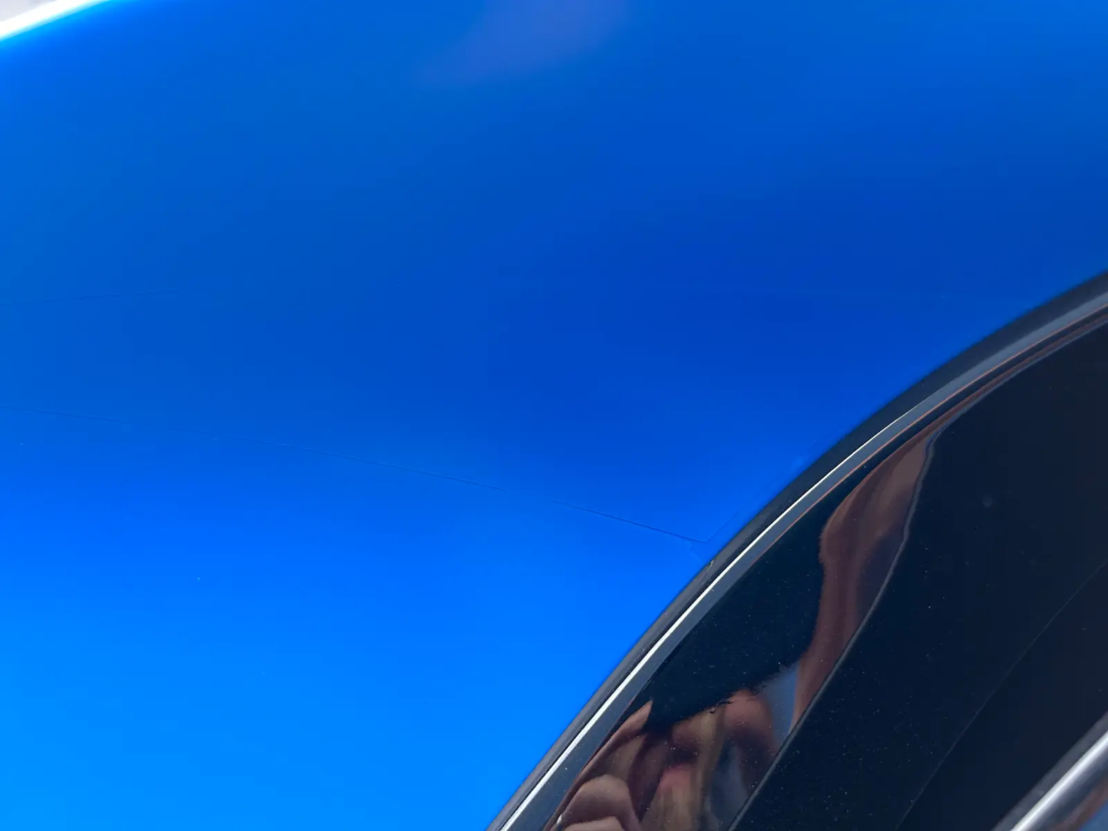

Yeah doesn’t look great. I would have preferred no seams either but a very experienced installer said it won’t hold up in the long term. I have a 10 year warranty on mine and the seam is really clean so I’m ok with it. You really have to look for it to see it.
