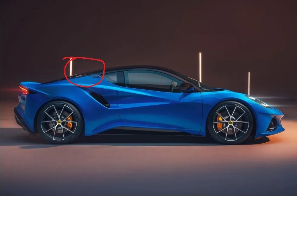

i can answer some of your questions now:
(1) no, and the problem of engine water inlet happened again on a blue emira yesterday. It is hard to figure out what's really going on now since: 1. the jet lag between UK and China. 2. there's a one week national holiday and the Chinese mechanics are off
(2) my salesman said they had summarized and sent the errors to UK, but they do not know if them had been fixed
(3) Yes, but if you order i4 now in China, you will suffer from the long waiting time(same as other international customers) and price hike (about 8k usd more)
(4)they are arriving based on the agreement between Geely and Lotus (first batch of i4 will belong Chinese customers). But believe me, it is not as good as it sounds like. Most emira purchaser in China are experiencing the slogan "lots of troubles, usually serious". i4 emira is a great model, but just not ready hitting the market. From the feedback from owners, the check engine light is on after 300km driving. And if you use high pressure water gun to wash the vehicle, make sure not to point at its rear air intake, that will damage your ECU permanently (1 of delivered emira had met this problem). I will draw it below. Right now we are concerned that how it will survive in the rain.
(5) i dont know. I'd guess under 20.
I can confirm this on V6 manual. Exactly the same spot has been identified by the dealer and it continuously produced errors. On mine we wrapped the ECU watertight until Lotus figures out a real fix. I already expected it to be a wide-spread problem with me catching it early because I put a lot of miles on it. Driving in the rain usually wasn’t a problem, but dew overnight was.

On the right side as shown in your picture, or on the left side? I recall seeing the ECU on the left side of the crashed Emira...

I would like to propose the same preventive measures to my dealer. Did you just wrap it with kitchen wrap then put it in a plastic bag, or was it something a bit more sophisticated?

I assumed that they meant some kind of wrap that can withstand the heat that the ECU puts out?
Looks like the ECM is on the left side of the vehicle, accessible by removing the left rear wheel arch. Seems incomprehensible to me that the ECM isn't weather-sealed if it is being installed in the engine bay area in general.

For me it’s on the left side. It’s just wrapped in some plastic. So far it doesn’t show any signs of heat problems (at least short term) and the replacement ECU is already ready to be installed. We just wanted to make sure we fixed the problem before destroying another ECU. Well the current one is still working but not in good condition hence the replacement. Before the new one gets installed I’ll make sure some real solution capable of dealing with the heat is available. Long term I see another recall coming to actually waterproof the ECUs..
