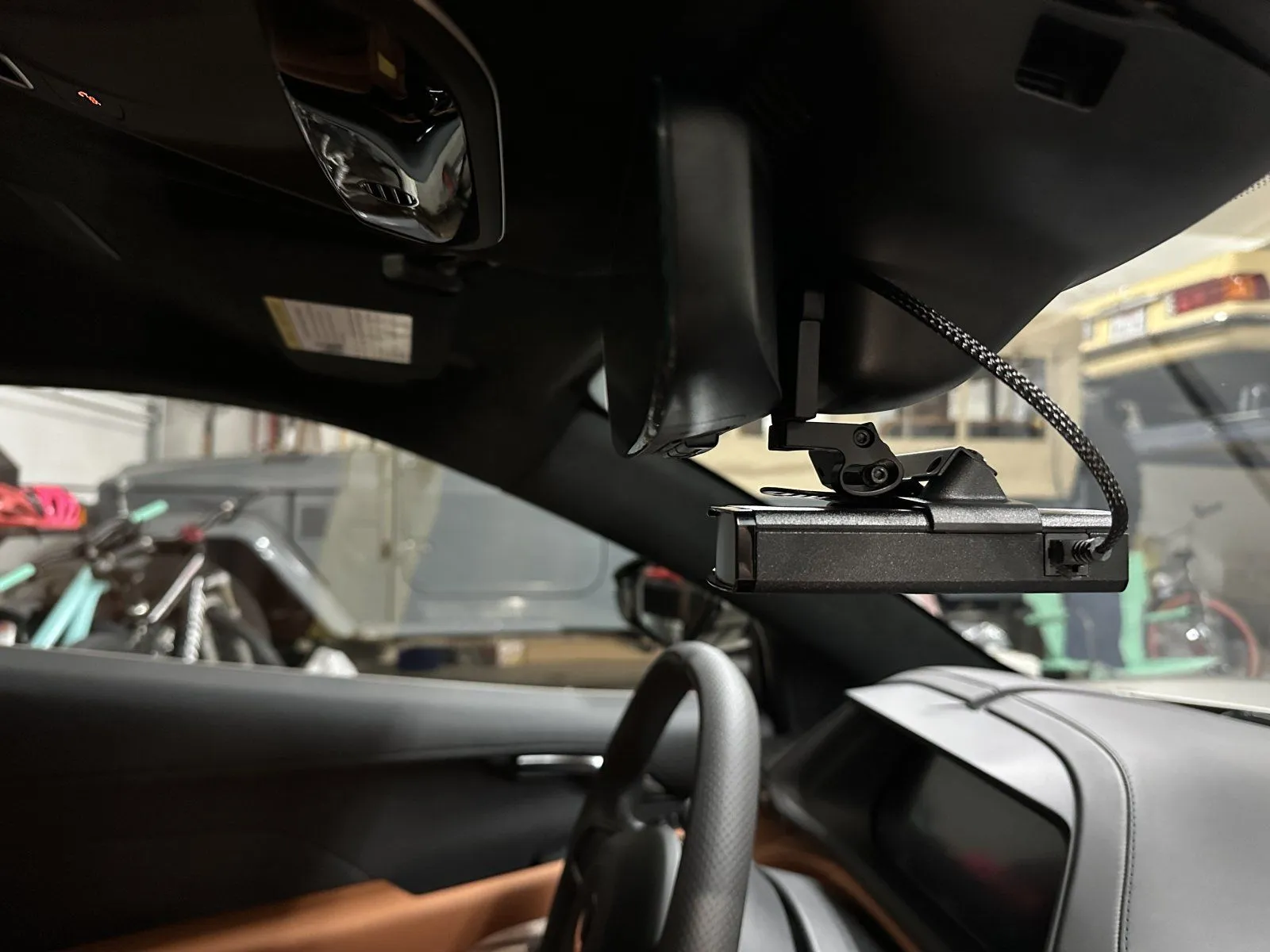

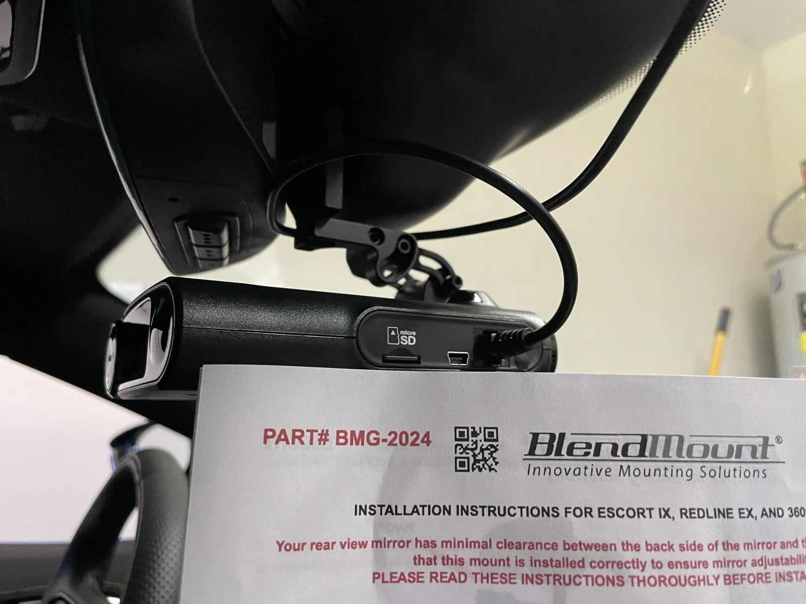

I'm going to give this 5-12v one a try.. They have a 1.6ft version that looks tidy. Ordered.
Amazon productIts not letting me past the url, but its :

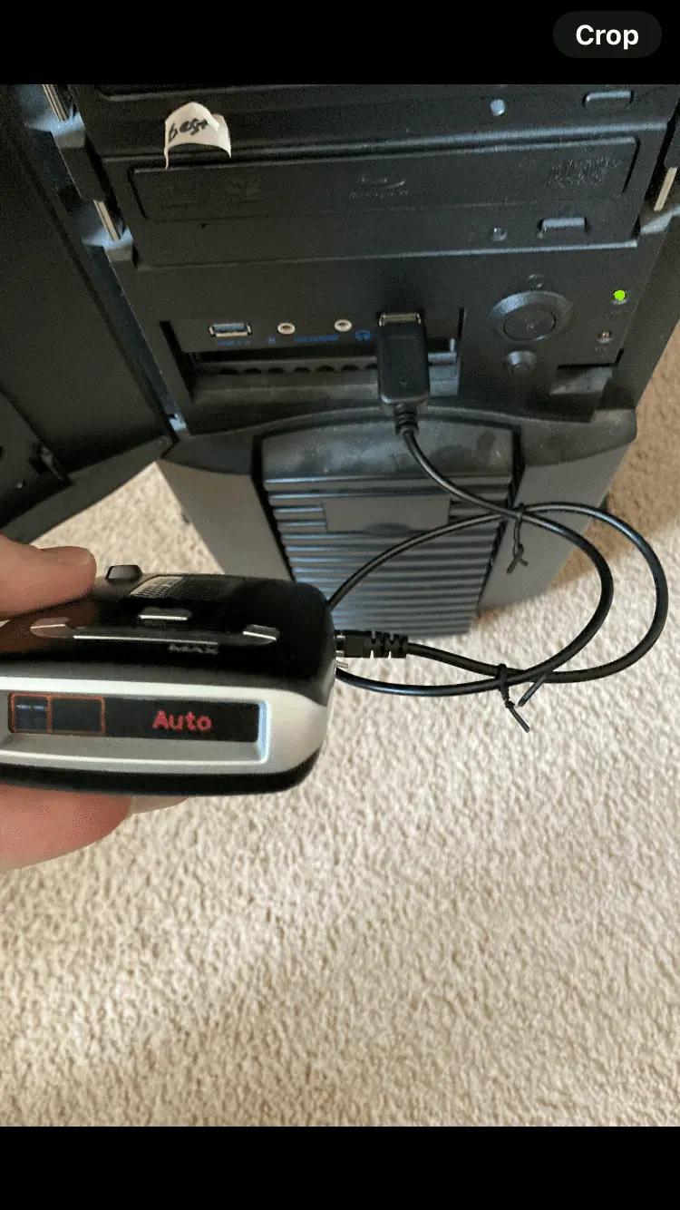

Credit another forum member this is the switch hot. I needed to run V1G2

Just received this.. It didnt work for me either untill I plugged it into a higher amperage usb port (computer). I guess we’ll see if the Emira has a decent output up there.

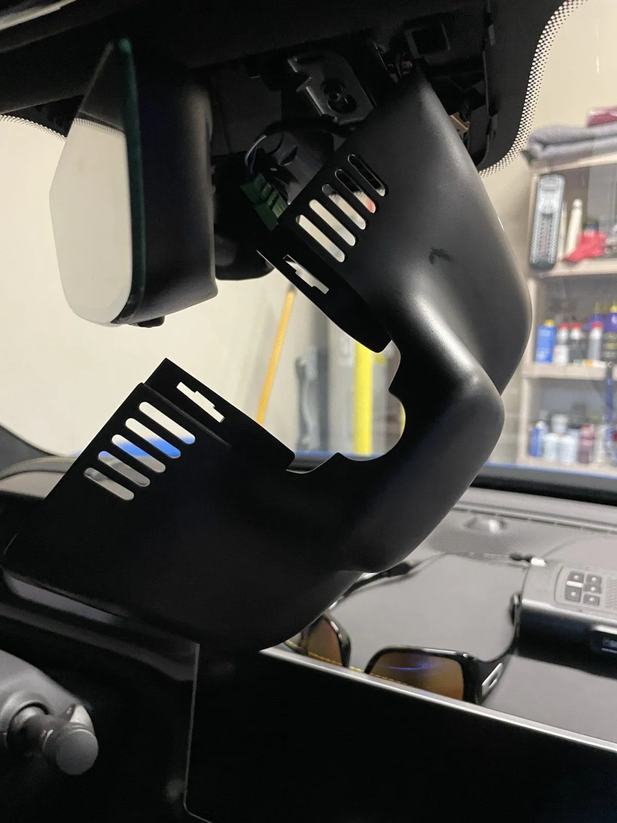

Lsp408
Active member
Mar 25, 2022
27
63
Knoxville

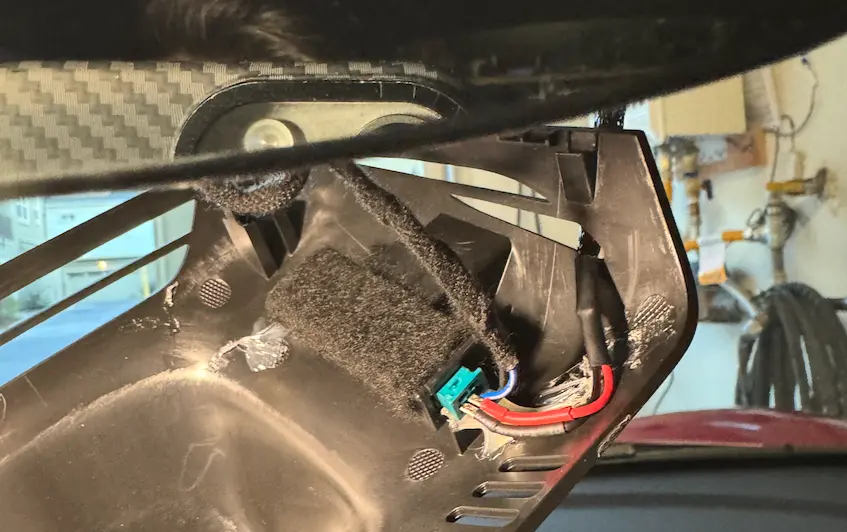

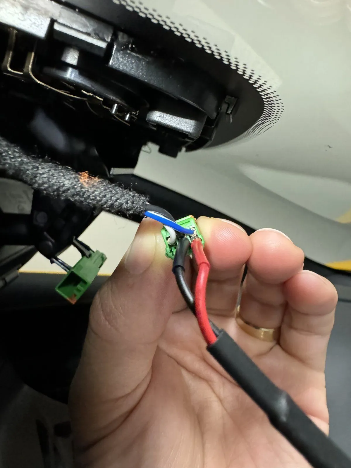

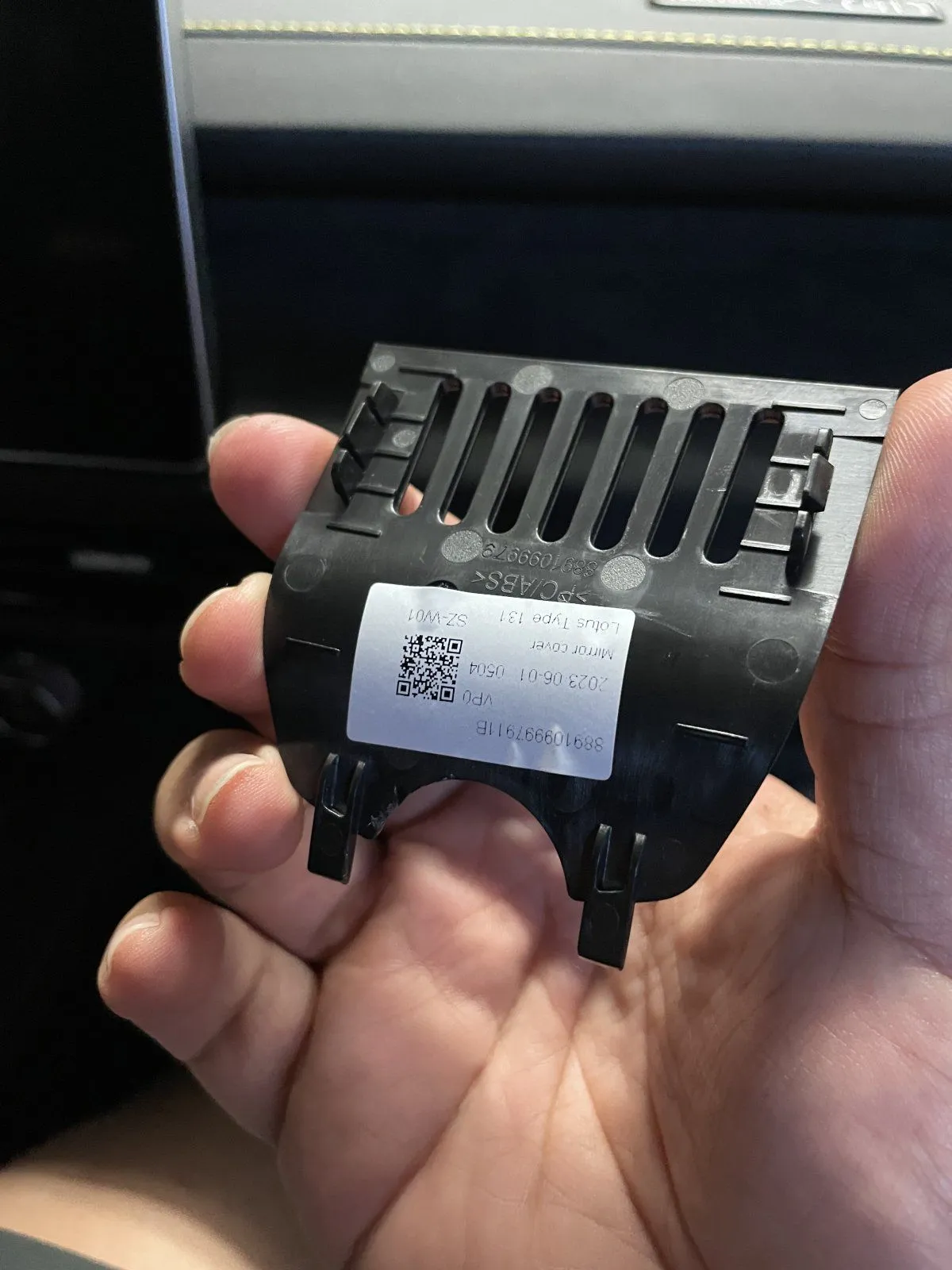

Tried the same thing. The 5V to 12V did not work for me (Escort Maxcam360c)
Going with the wiretap method
