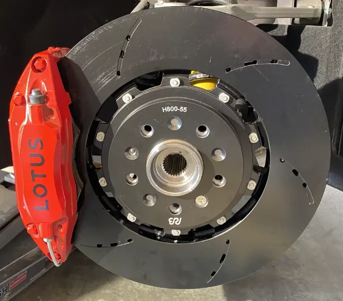

@Warren-RB curious to know why your iron discs (non-CCB) are drilled and slotted as opposed to just slotted? Is there an option for just slotted for more track use?
See various patented designs built into our brakes (Including open slots):
Advantage of an open (thru) slot finish:
  • Has the advantages of both drilled & slotted rotors
  • Allows the disc to expand and contract and prevents the disc from cracking or warping
  • Increasing cooling area and retains more friction surface
  • Slots relieves thermal stress
  • Slots are self cleaning and the pad build up will not clog the slots and are exhausted via the rotor edge keeping the disc surface clean
  • Reduces brake pad dust buildup and keeps the wheel clean through vacuum effect
As illustrated above our rotor are made differently from the rest of others in design and finishes, in fact they are more difficult to machine than conventional drilled or slotted finish. The holes are "oblong" and they will not crack like "round" holes and it has a ditch to collect the brake debris and evacuate them thru those slots to keep the disc surface and wheel clean.
These are "proven" advantages in the past 20+ years are favored by thousands of car enthusiasts on both the look and performance, while a few dedicated track racers may prefer "slotted" only finish at their own discretion but they represent less than 3% of our customer base, so we do not offer other finishes.
Also try to understand a rotor made of cast iron is not very stable dimensionally, ie they are subject to expansion and contraction during heat cycles that can result in warping and/or cracking by nature. Believe it or not how resistant to the ill effect of "heat cycles" is more to the cast iron metallurgy (Composition and microstructure) than the finish itself.
For track applications you should inspect rotors' physical condition before/after each event and have them replaced if a crack is progressing rather than until failed.

Thanks for the detailed explanation. Makes sense
