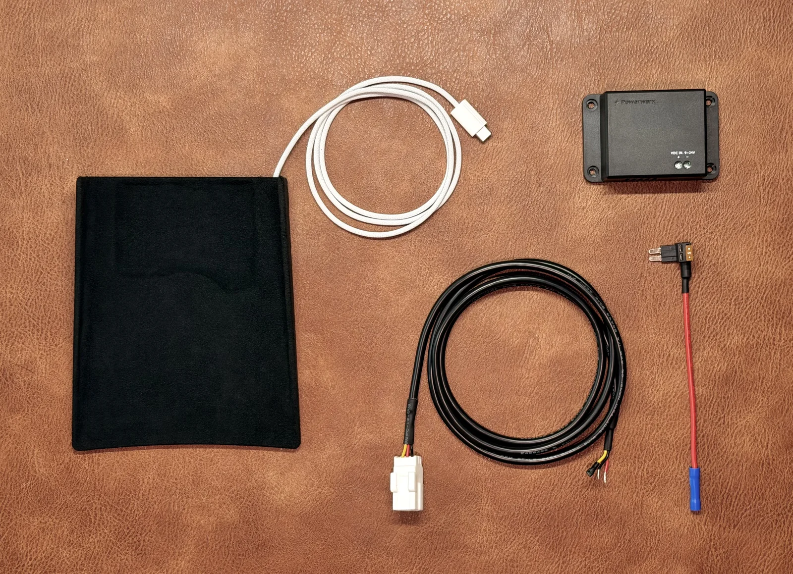

The Alcantara I use for my wireless charger tray is an exact match to OEM. Pics here:
I get it from Relicate. Black 9040 unbacked.

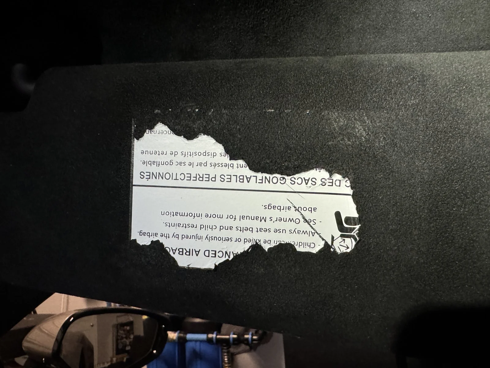

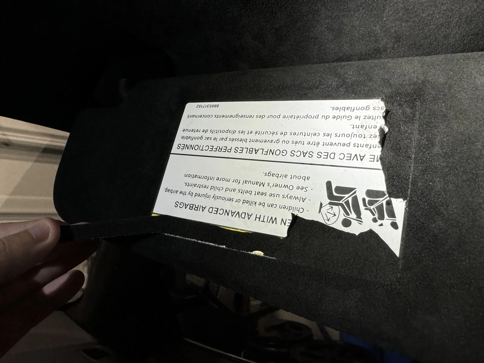

I took the risk hoping it would be as easy as the Porsche in the video above. The edges came off relatively easily, but most of the adhesive seems to be around the center and it got very tedious very quickly after that. First photo is after 5 minutes and second photo is nearly an hour later. I would say this isn't worth your time unless you can find a better method than mine.
My next step is trying a heat gun, but if that doesn't work I may look into covering it with a patch of Alcantara until I can call my dealer and inquire about the cost of a replacement, or with any luck try to order a euro visor sans sticker.

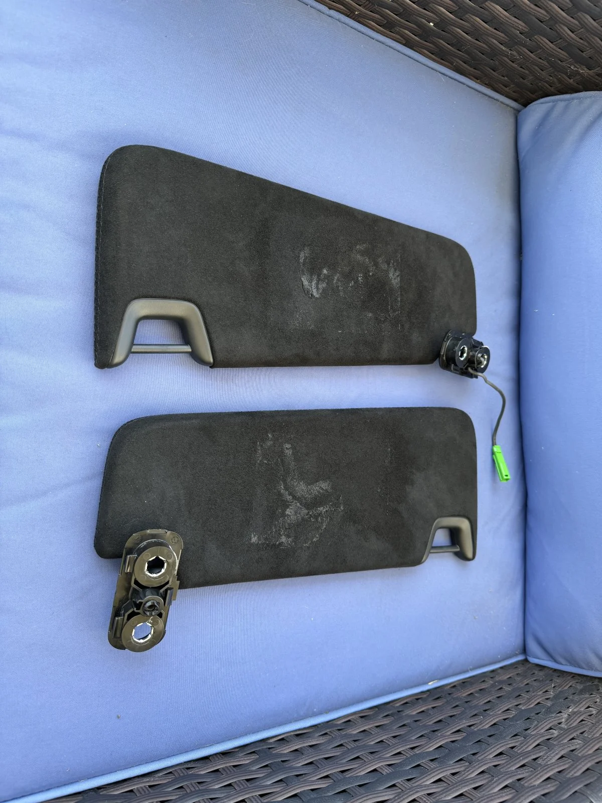

I was able to finally remove mine with a combo of isopropyl alcohol and steam, but it was not fun and left behind a decent amount of adhesive residue. For now it's at least better than the white/yellow sticker right in your face, and is MUCH less noticeable when folded up in the dark interior than in these outdoor photos, but I'll still research a few methods to safely remove the residue without harming the suede.

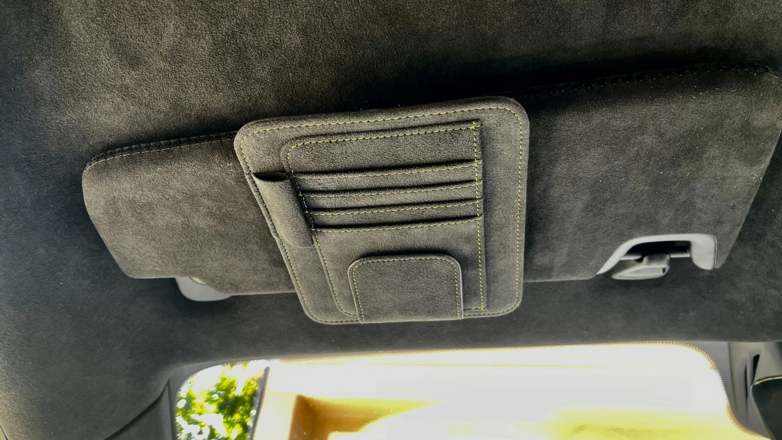

Not a perfect solution but Banco's Sun visor organizer just about covers the entire sticker from my vantage point in the driver's seat. I think it would need to be an inch or two wider to completely block the view of the sticker from any angle.

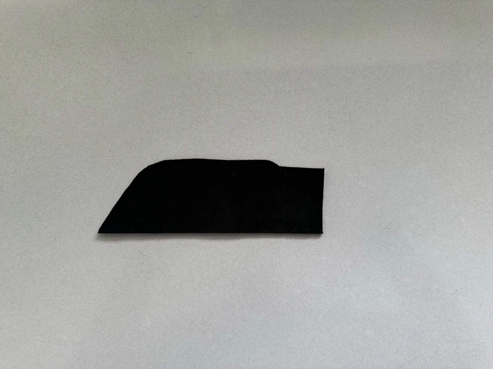

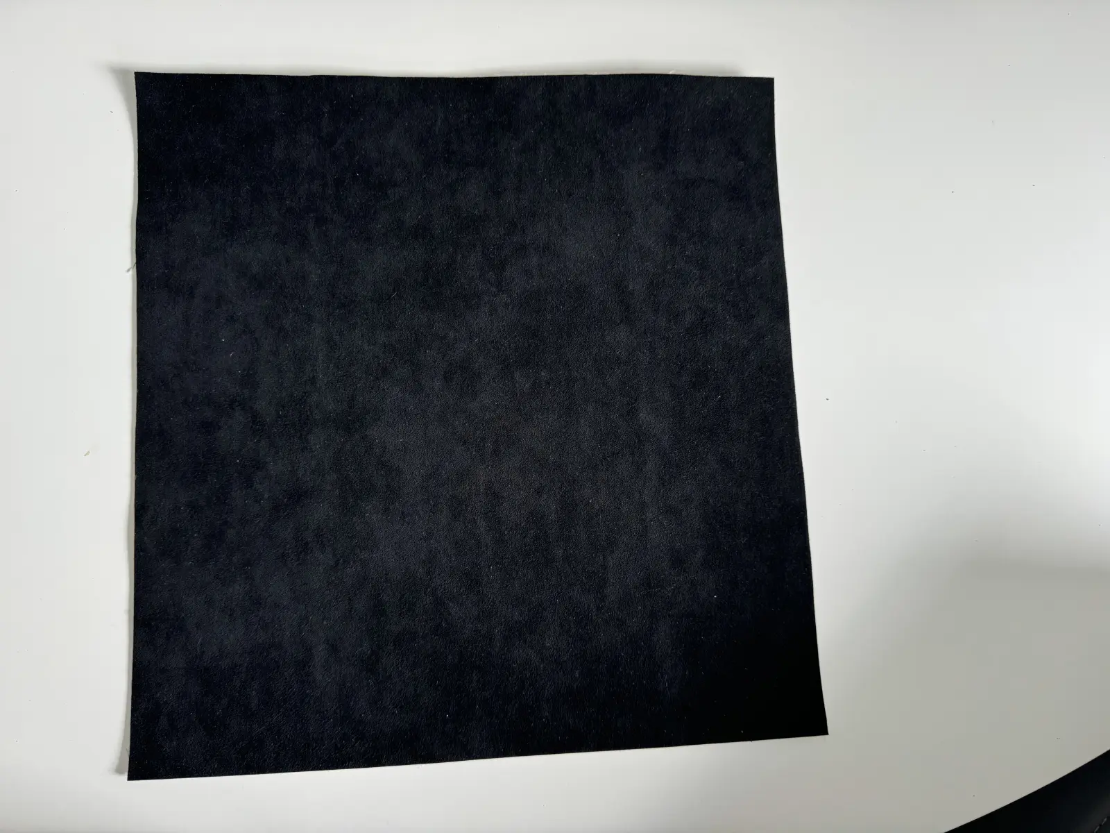

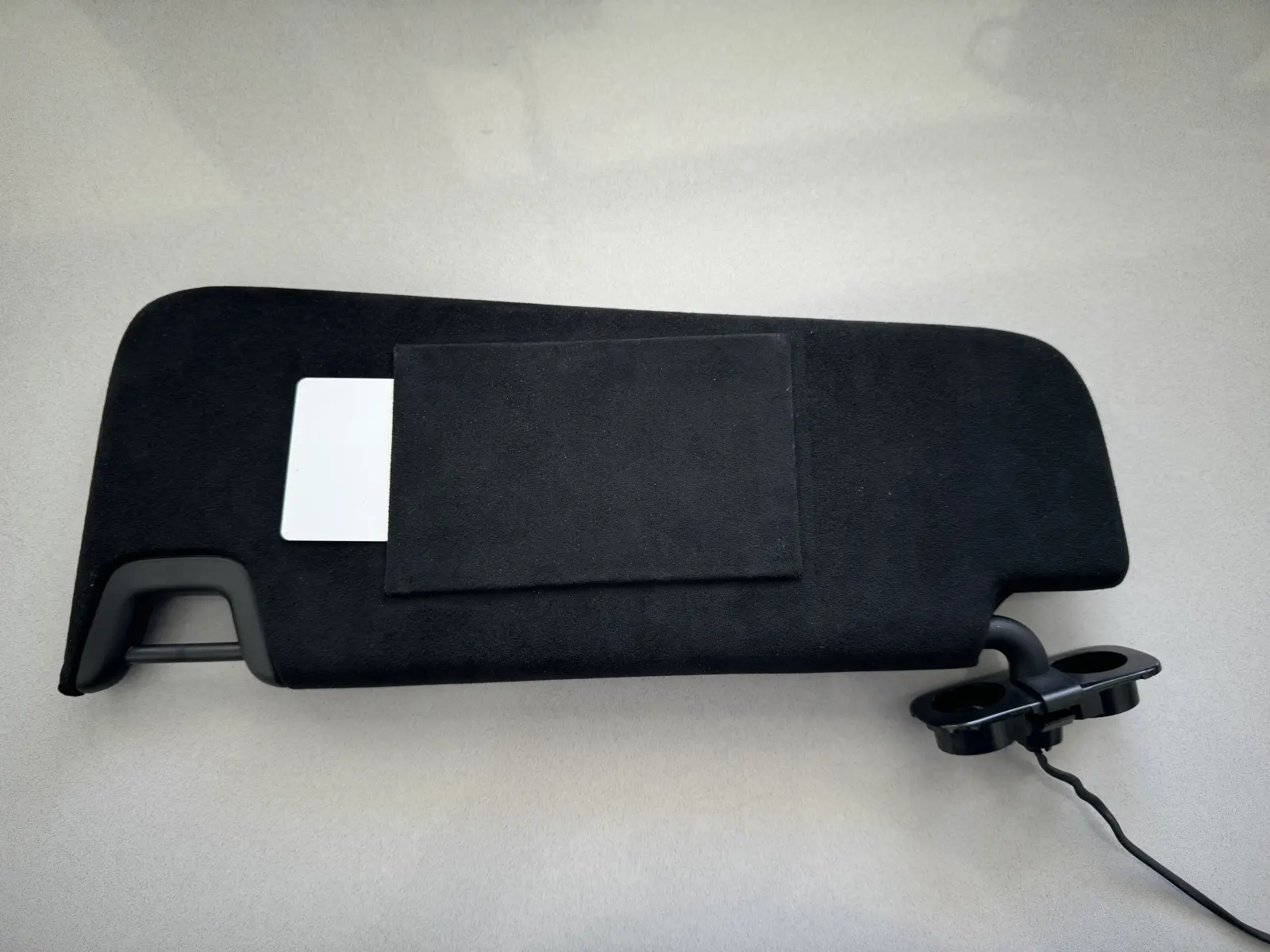

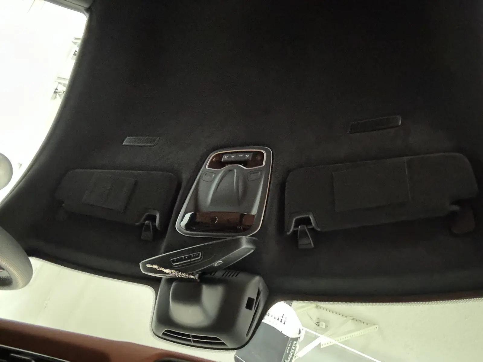

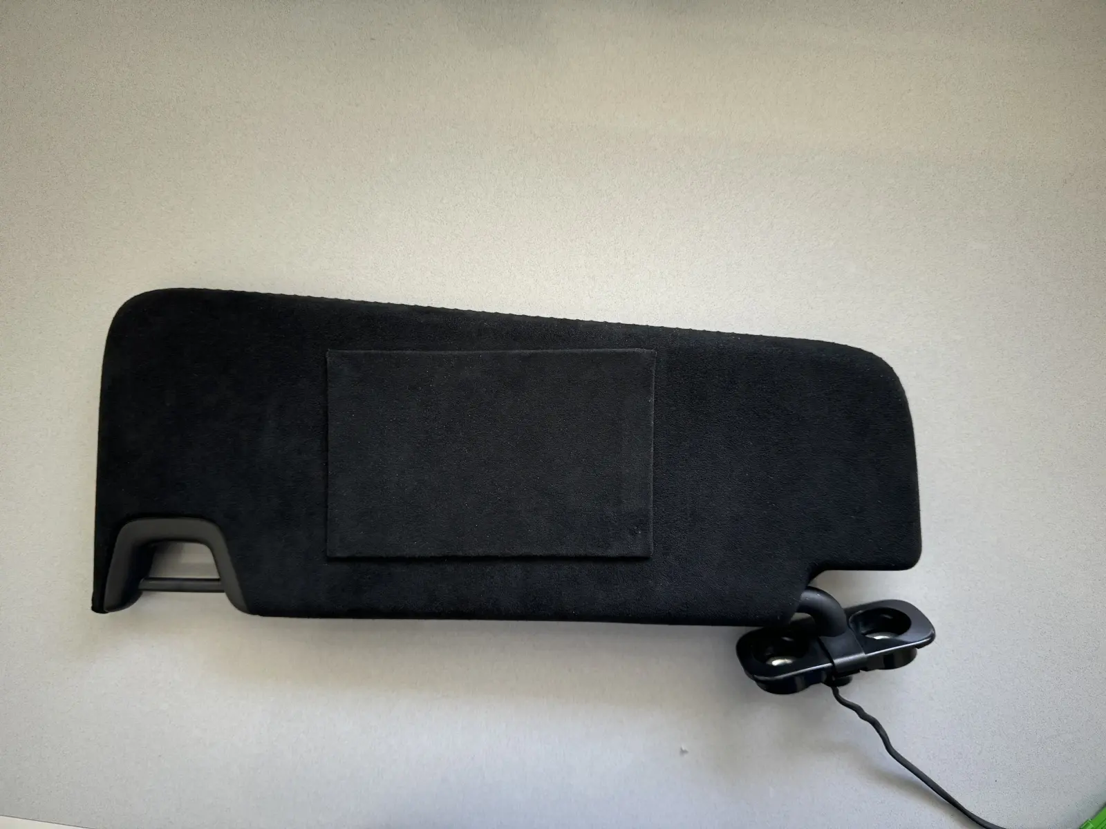

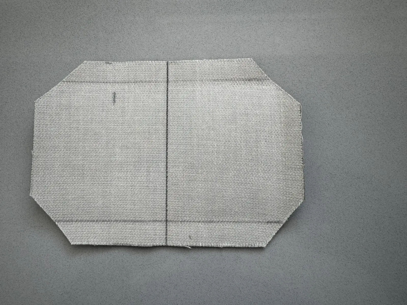

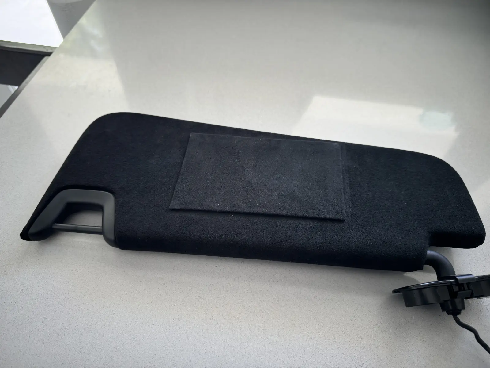

Ok so today I finally got to tackle my fugly sticker delete project. I had to abandon my former idea of designing a band around the visors as it proved too complex due to the angled shape of the visors plus the challenge with the passenger side mirror.

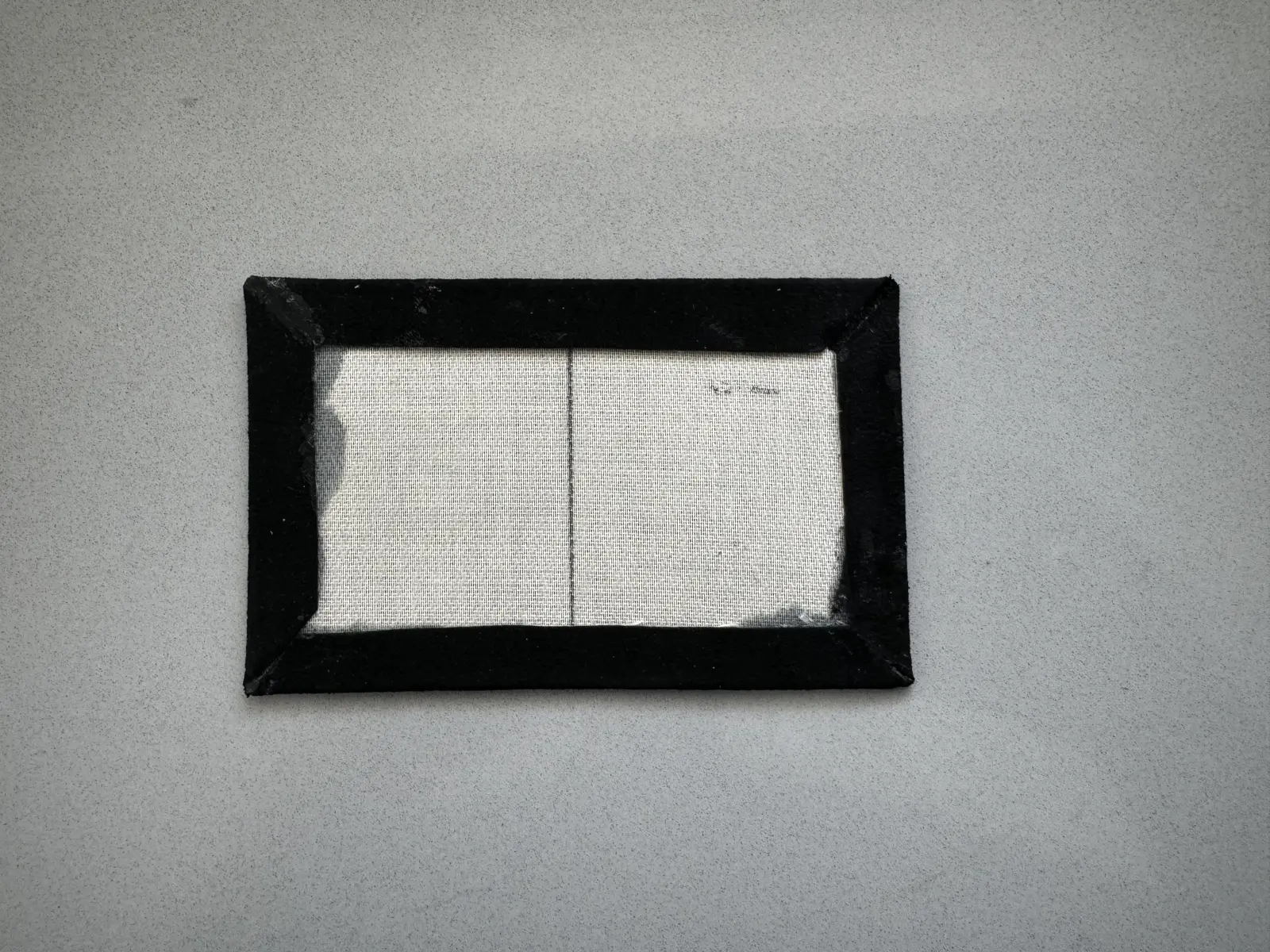

Instead, I drew on my limited arts and crafts skills to make a pocket out of the Relicate.Black 9040 alcantara (thanks Silent Cilantro for the tip) with backing in the dimensions of the stickers. I then glued them on 3 sides, one at a time. and placed a metal ruler with a heavy weight on top of each edge to compress the alcantara as the glue dried to get as close to a flush surface as possible. Finally I placed a bead of glue within 1/4" along the perimeter on the stickers leaving one end unglued (open) and again, used a cutting board with a heavy weight to compress well the pocket to the visor.
To my own amazement, it came out really nice, even nicer than the pictures suggest, since the shadow effect makes it look less flush than it really is. My main objective was, of course, to get rid of those unsightly stickers and make it as discrete and blending as possible. Another collateral useful purpose however is that the pocket could be functional to hold parking cards etc.
I've included a few pictures of my project should any of you like to follow this idea.

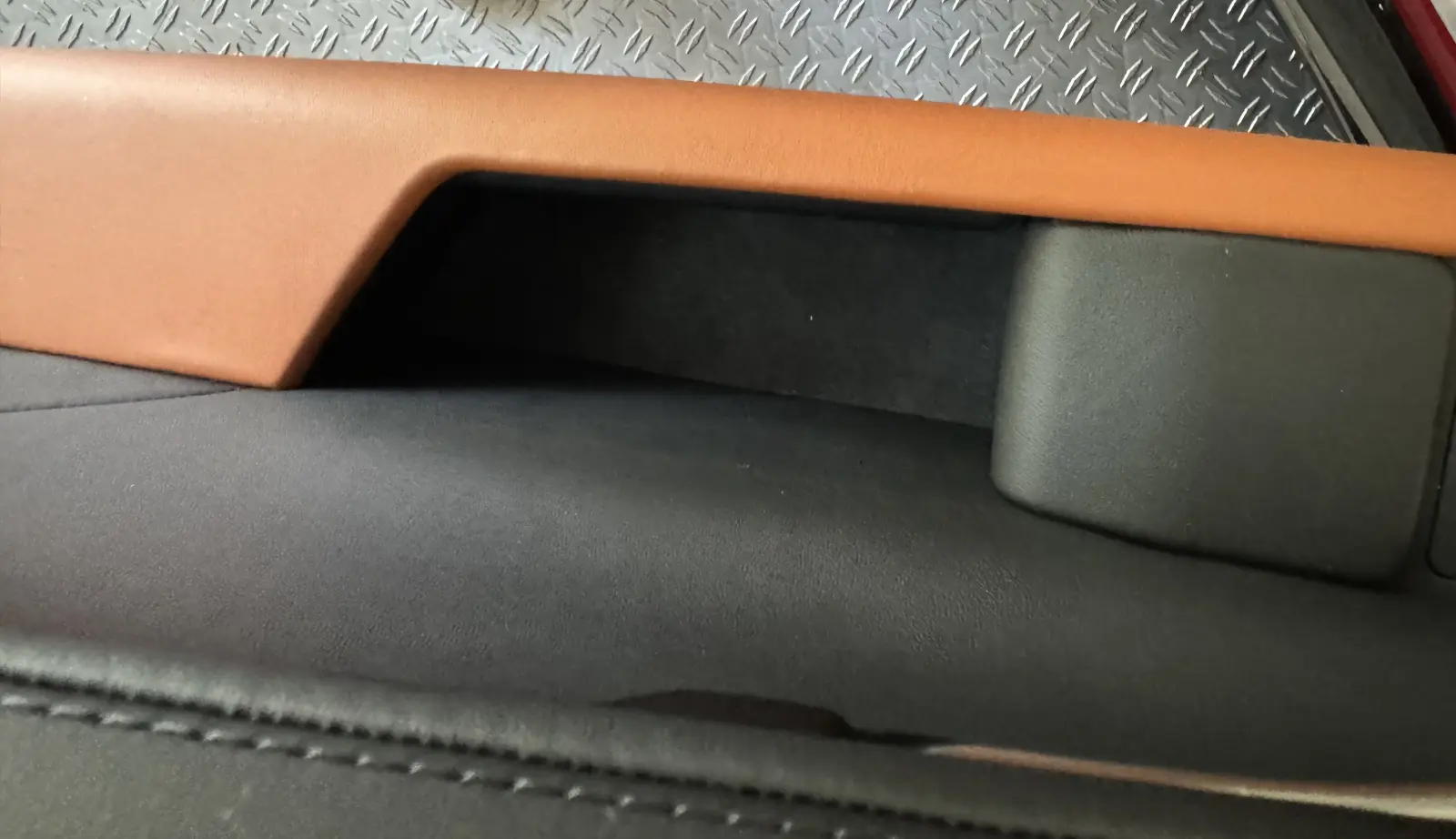

On a side note, the last 2 pictures was something I thought of (and very glad that I did), which was to place small mats with my leftover alcantara in the door handle cavities which I cut out using a paper template. I gave it some extra length so it could slipt extra on a slip under the slot which makes it stay in place nicely. No need for glue or anything else. As small as a detail as this may seem, it definitely looks nicer than the hard plastic of that handle cavity and feels much much better when opening of pulling the doors, plus they easily can be pilled out for occasional cleaning. I did both door handles in less than 30 minutes.
Here are the pictures....

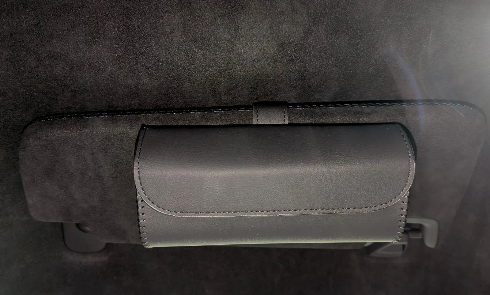

Similar T6061 above, I purchased this sunglass holder for the drivers side. I covers most of the sticker and you can't see it while driving. Passenger side has the sliding mirror so I'm debating what to do about that one. Amazon link [$9 - Accmor Sunglass Holder - Amazon product ASIN B08ZRTCTMT]

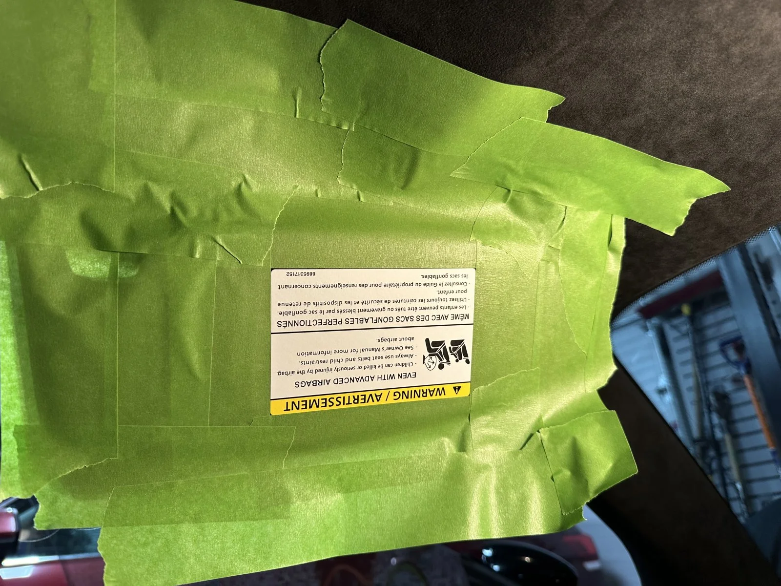

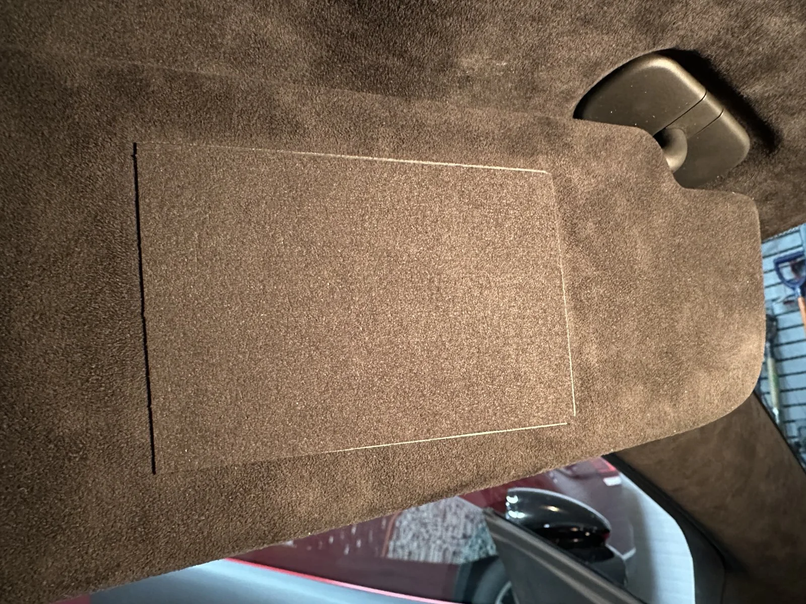

For anyone interested, I covered my visor labels and I'm 99% satisfied. I didn't measure properly so this post may help others do better, should you cover your labels with alcantara, like I did.
What I used:
-Black 9040 unbacked alcantara purchased from "Relicate" (NY, USA); a 12x11.5" small panel. This was the alcantara that silent cilantro recommended, as matching the Emira, based upon what he used for the custom magsafe wireless charger he sells on the Forum. I thank him for that advice, since it was a good match.
-3M Super 77 multipurpose spray adhesive. I used this since it cost less than $20, rather than spray adhesive costing twice as much, since the glue only needs to bond fabric to "paper". It worked well.
My mistake was failing to cover up the outer edge around the visor lablel, which isn't part of the label but rather a clear edge around it. It's visible but only for ODC people like me, when knowing what to look for and focused on a close-up and well-lit view. I cut out a swatch 121mm x 79mm and should have added at least 1-2 mm to each side, to cover up 100% of the clear edges. But I accomplished my mission and got rid of the labels. Here's a "during" (before spraying; I left the visors on) and "after" photo, of the final result:
