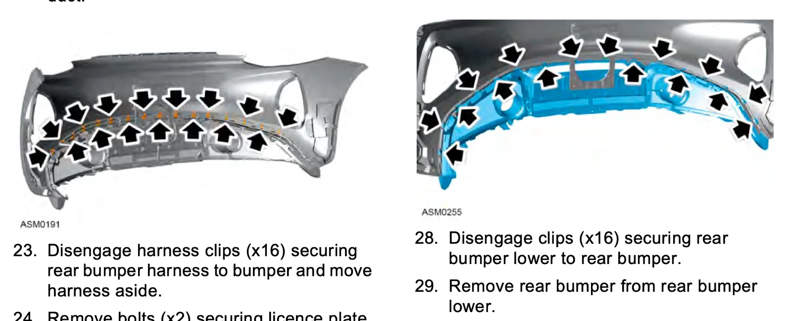

I don't believe this is possible. It looks like the lower bumper is attached to the bumper from behind. And there's a harness attached between the two pieces.
It is not possible to swap the exhaust tips ( i did it and looked for a work around) without full bumper removal. The problem is the crash pad foam under the bumper which covers several items for the tips. Its really not a bad job to do just idiotic Lotus designed the tips that way.
