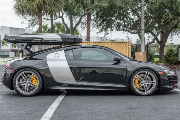

Call me a madman, but I really want to have a roof rack similar to this Audi R8 one:
Probably a long shot that someone makes one for the Emira, but any leads to anything remotely like this for the emira?
I know seasuckers exist, and may probably be the only route I can take, but a bolt or clamp style roof rack on would be ideal.

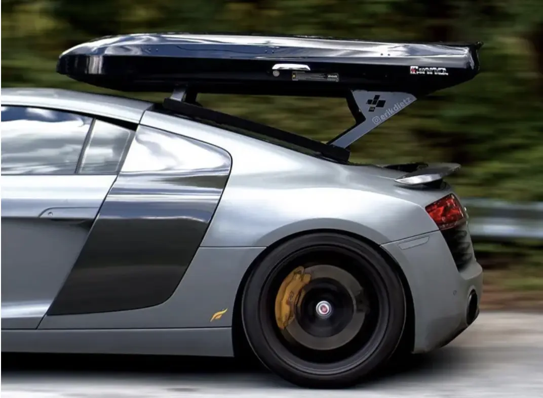

This is the roof rack in question. They may be willing to make one for the Emira. It uses Seasucker suction cups, so perhaps not ideal. Nice custom powdercoating.

That's too much leverage on the lower portion of the rear glass, it's just an unsupported piece of glass there. I have a Seasucker Komodo and I place it further up to make sure it doesn't apply too much force on the lower portion of the glass.
Yeah, if this was attached to something more structural sure. But like this? No.

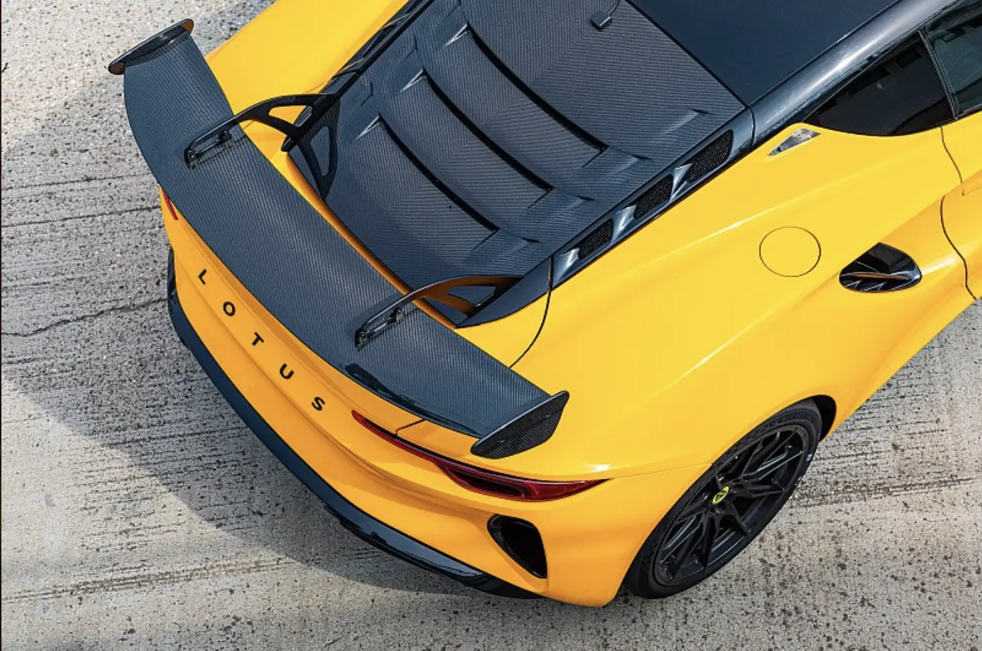

The Jubu wing seems to be bolted on using existing holes under some plastic cladding near the tail end of the hatch:
If someone was to make an aftermarket roof rack, I'd imagine this would be a good place to bolt on at least the back end of the support structure. Then the front could be seasuckers for a cleaner install.
