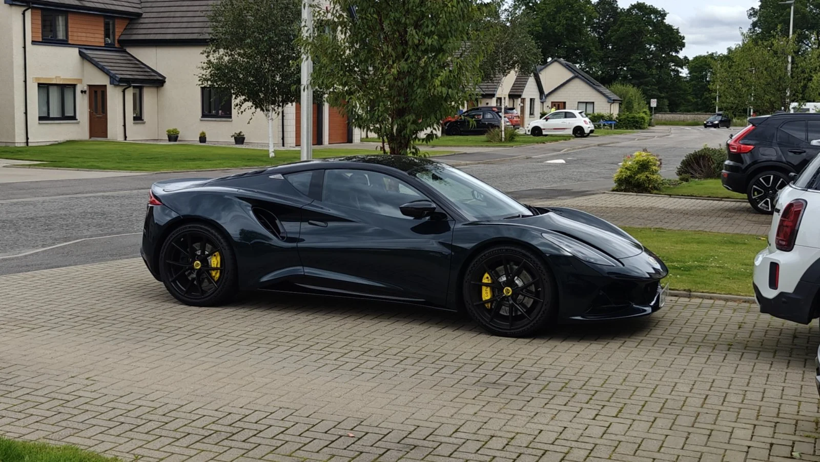

Just gave the car its first proper wash of the year and wow it was bad... Paint blistering on BOTH rear quarter panels as well as the driver door and also paint cracking along the edge of the left hand side rear quarter panel where it meets the boot lid. Not too happy...
I've been in touch with Lotus Customer Care directly, bypassing the dealer, asking to escalate the issue further to hopefully get a resolution. It is getting to the point where I feel it will need to go back to Hethel for a new body and a rebuild!

Reject it. A lot of us with the blisters have already done so. Don’t take this BS. Down the line, it will only get worse.

Since my last post nothing has happened on the rejection front. I emailed the escalations team stating I want a new car or a refund and then it just so happens that the part I've been waiting 5 months for miraculously appears at the dealer two days later...
Giving them one last chance, booked the car in to have all the mechanical and trim issues sorted. They're going to have the car for 3 weeks so it better be sorted when I collect it! What has surprised me though is they have also told me that the parts are in to have the door AND both rear quarter panels replaced so that is getting done while it is in as well, so should be car completely sorted and good to go? Nope, just last week paint bubbling on the boot lid. It is on back order so won't be possible to replace this time... Only bumpers, front wings, roof and bonnet to go and it's a whole new body!

Man how is every single composite panel on your car blistering, insanity. I hope they get you squared away quickly.
