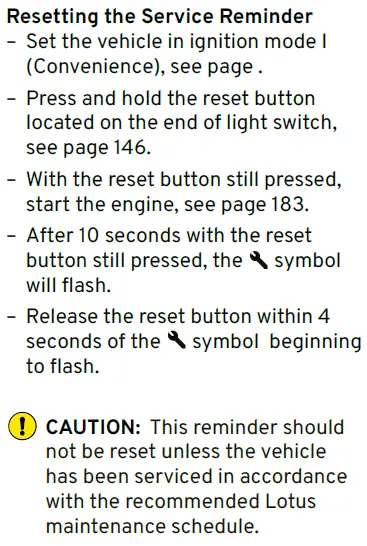

From page 217 in the manual.
  • #3
Thanks. Interesting. It sounds like it's got some kind of timer mechanism on it. I think I'll just leave it as is!
