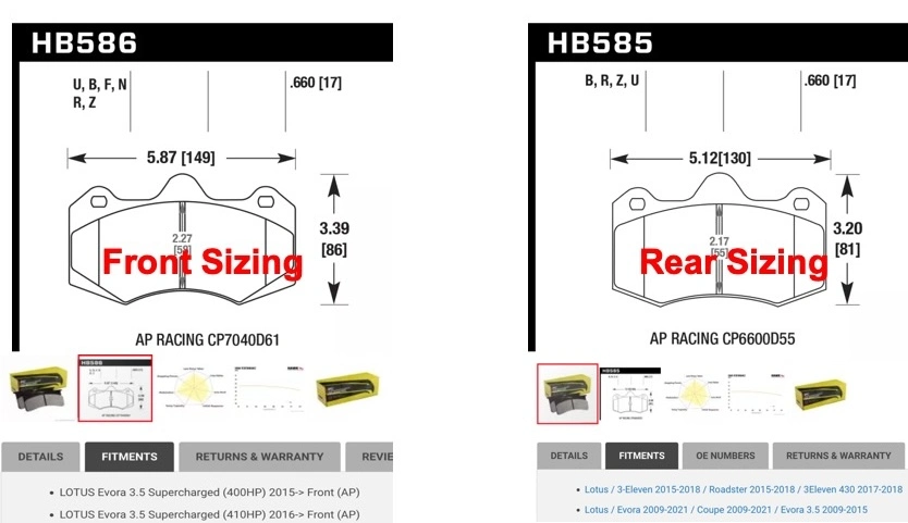

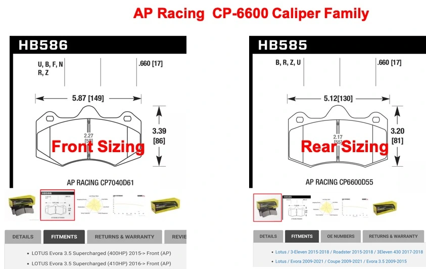

The problem finding a good Hawk brake pad as a replacement is the Emira is too uncommon to be listed on many brake supplier websites. So I started researching and found that the Emira has AP Racing Calipers front and rear. The AP Racing part #'s for the calipers are: AP RACING CP7040D61 (Front)and AP RACING CP6600D55 (Rear). The corresponding Hawk brake pads for both the Lotus Emira / Evora GT Front and Rear HAWK brake pad part numbers are:
Front HB586( ).660
Rear HB585( ).660
Hawk makes a line of pads from street to track and everything in between. To find the pad right for your application, all you have to do is insert the letter to choose the pad compound. Once you’ve found the pads you want a google search of part numbers will find retailers. Not all compounds are available for both front and rear. With the Hawk part # a quick google search should list several suppliers. For example I put Performance Ceramics on my car. The Part numbers for f/r pads are HB586Z.660 / HB585Z.660

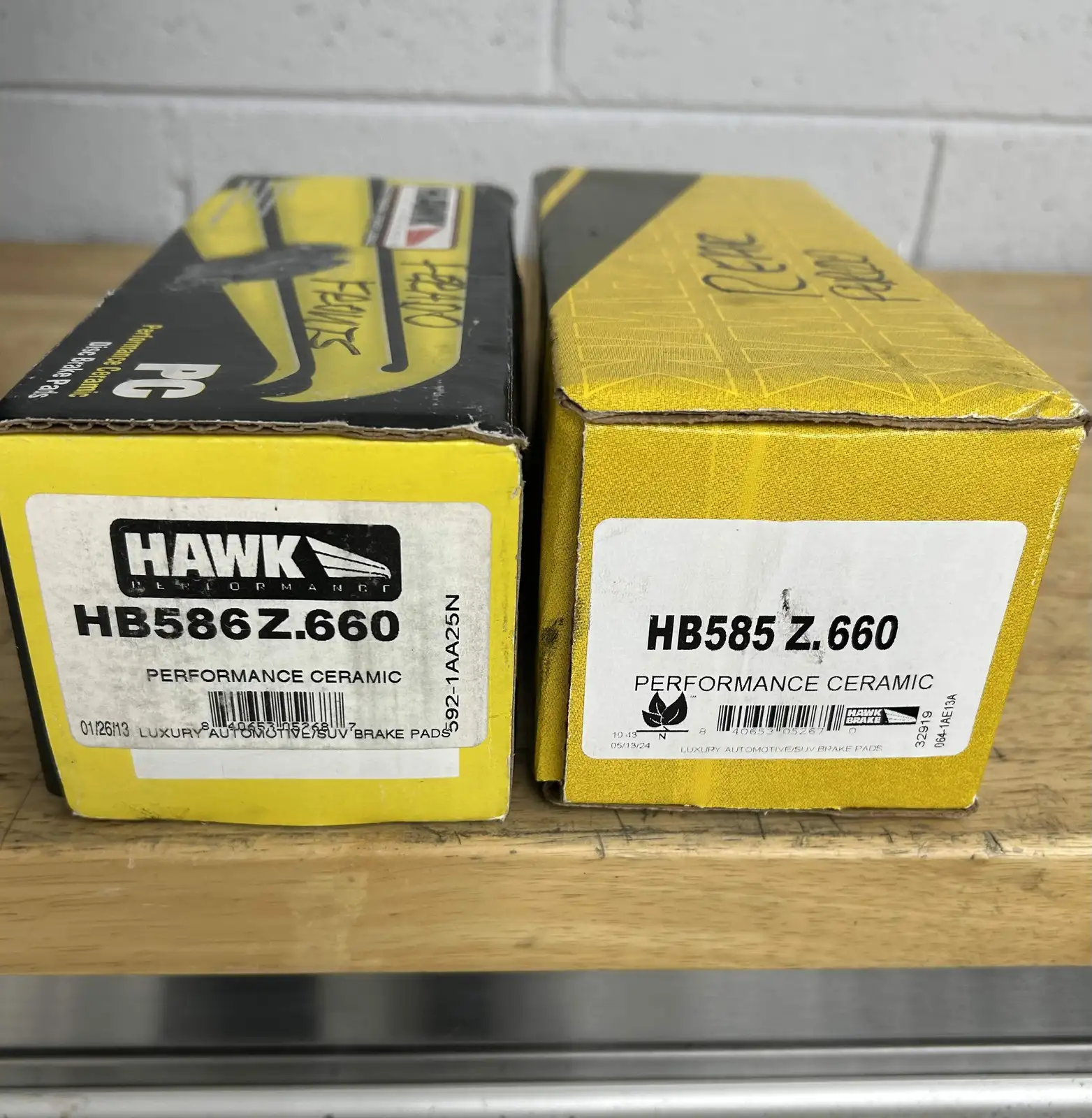

I installed the Ceramics and bedded them in. They fit perfectly! Almost zero dust and the brake feel is positive and progressive. Much improved over the dusty Ferodos.
Front HB586( ).660
Rear HB585( ).660
