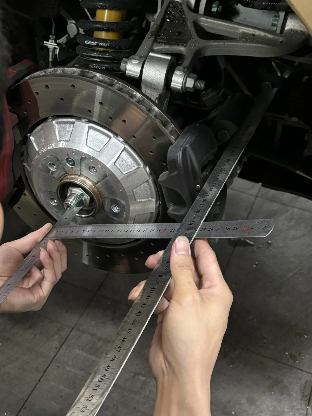

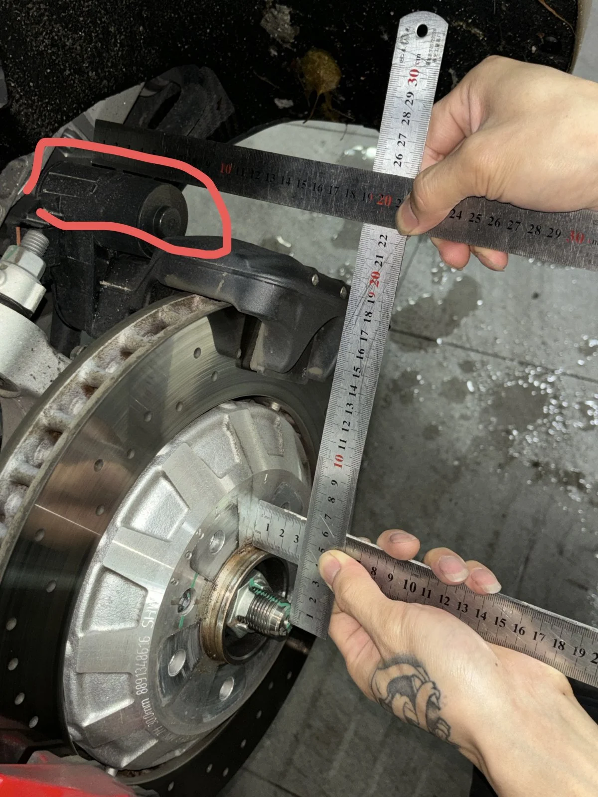

fit with 18inch wheels must be modify the parking brake attached the picture for your reference
This shop offers other styles of rim, and apparently the 18ā€ version are designed to work with the OEM brakes.
The 18s are not particularly light, but are lighter than the original wheels. He states they are built to be strong, not as light as possible. These are CNC from a forged blank, so are somewhat flexible on the details I expect.
