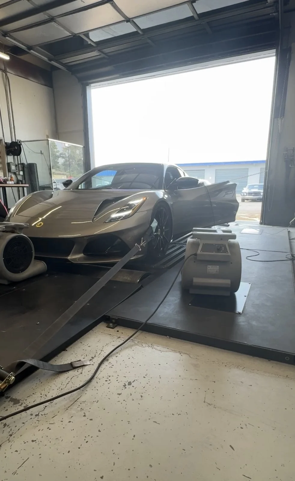

Here's a full dyno test of various air filters and the complete Eventuri intake that GRP conducted recently. They have both K&N and a dry high flow filter that can be used without oil or other modifications that increased flow.
I am running the K&N. Induction noise and supercharger sound are increased but only noticeable when the windows are down and you’re on the throttle. It sounds great and especially good in combination with the 3rd cat delete. In sport or track mode it is absolutely a riot yet very quiet on tour.
I am going to be consistent on oil changes and replace the K&N instead of reoiling. I don’t anticipate any issues.
