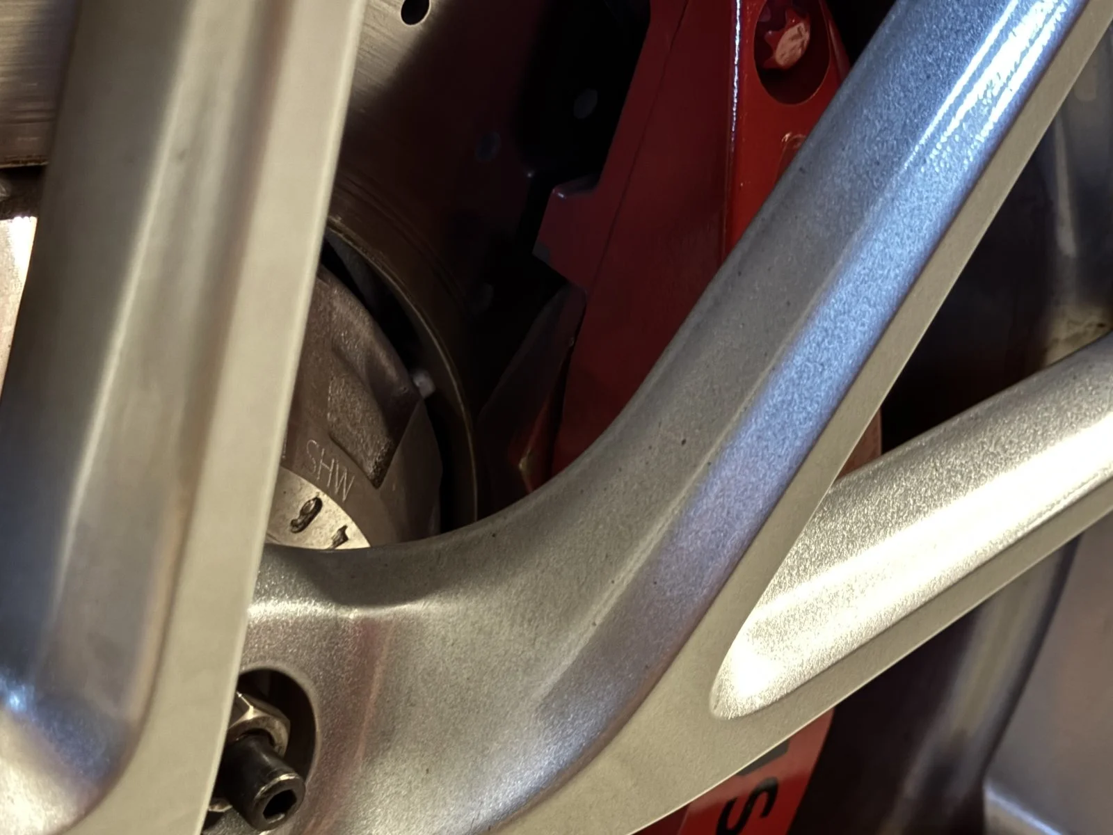

Can you see the red paint of the ebc reds behind the emira calipers? 😁
You’d really have to be deep in there with your head a foot away, the right lighting, and the pads cleaned up to notice.
