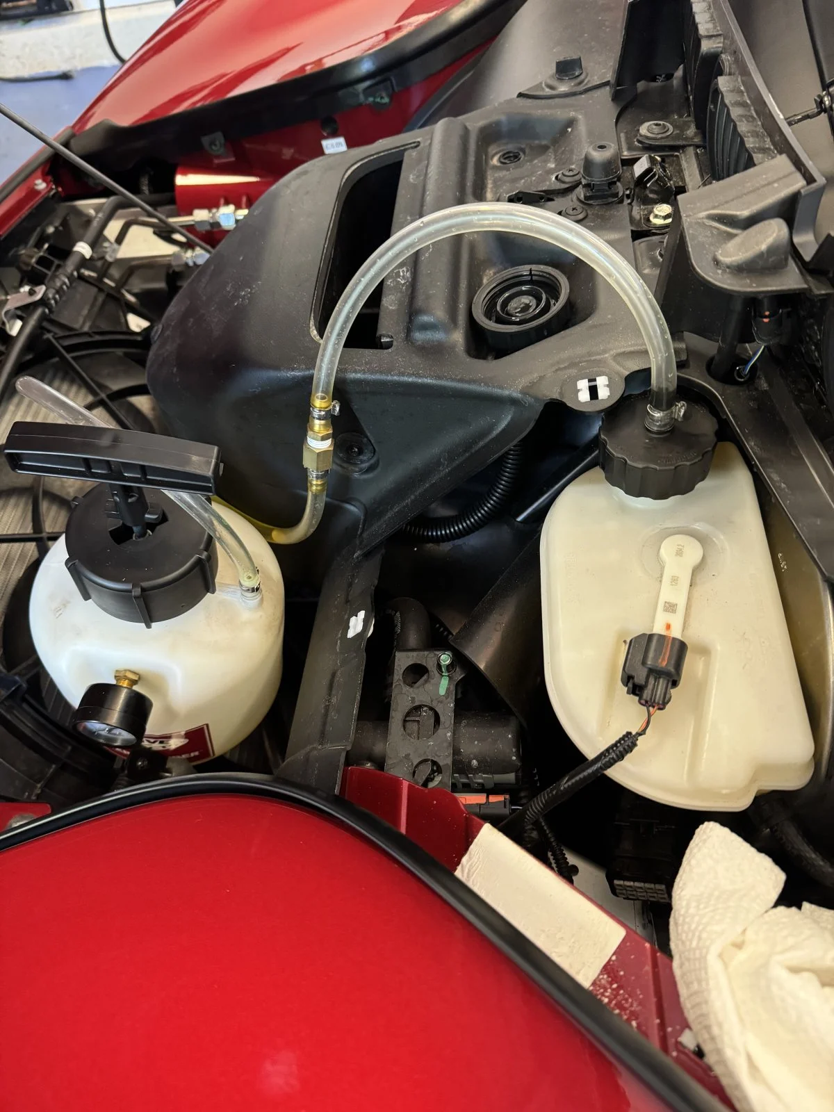

I have the motive european cap (used it for the "M" cars), I will try to get out a bit later to see if it fits. I am curious as well.
I went out and checked; the "european" spec cap fits. This was the first time I had opened up the front hatch and I was looking for an excuse to do so. Also gives me a chance to get in and clean it up a bit.
This is the link I used years ago to purchase the adapter: https://a.co/d/hPL5HG6
