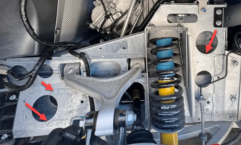

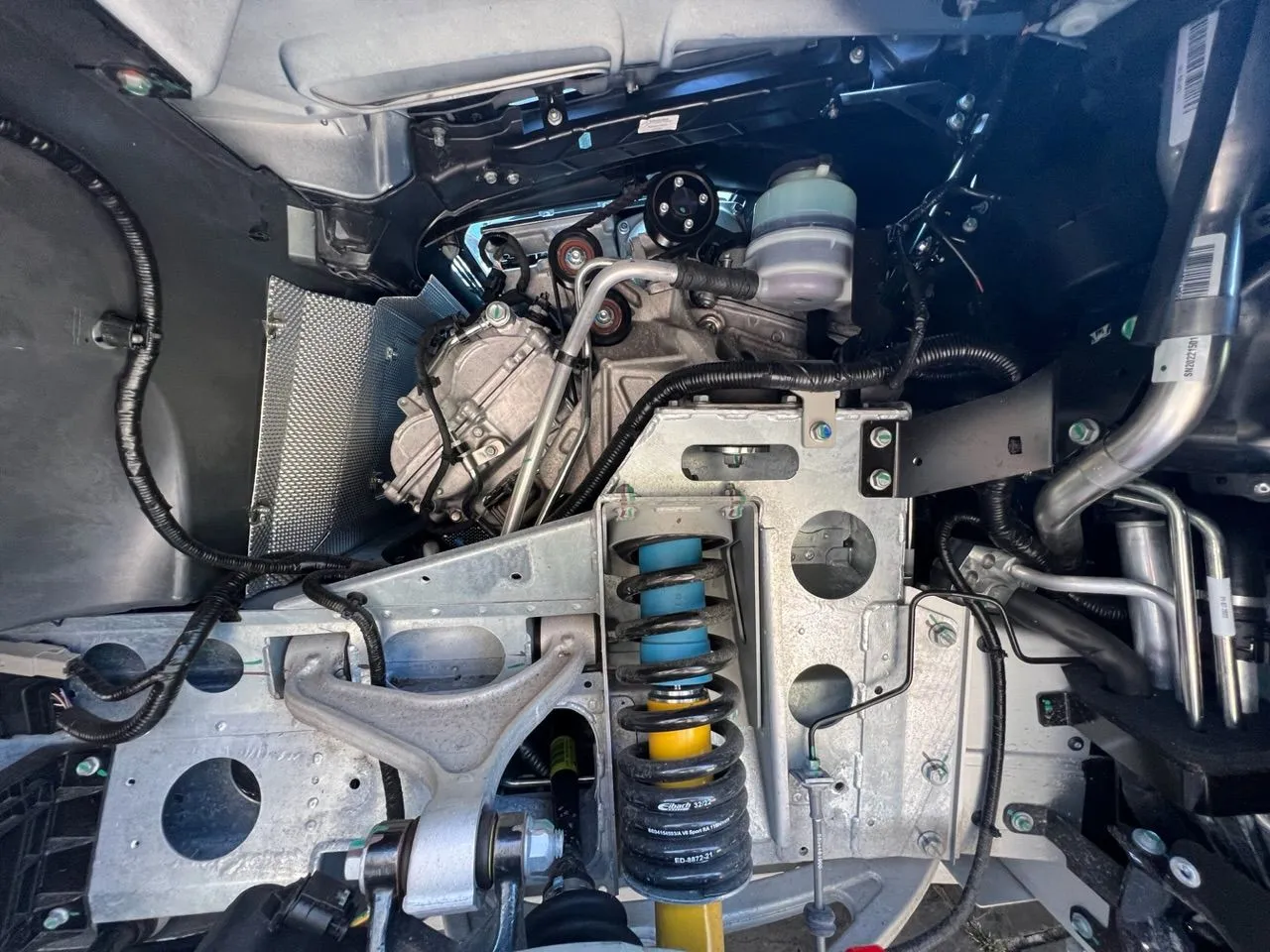

Anyone seeing rust on V6 rear subframe?

What is the rear subframe made out of, cut/stamped/formed galvanized sheet metal pieces riveted/welded together on a jig? That type of fabrication has a fairly low competency threshold - there is no special/exotic tooling or process. Lotus only need to procure galvanized sheet metal of the proper composition and gauge and use the right process for welding and restoring the rust protection at weld points. There is always a healthy need for domestic fabricators and welders in energy, transportation, and construction industries where the projects are typically unique and can't be economically/practically performed remotely.
Right, but you still need a genuinely skilled welder to build something as safety-critical as an automotive subframe. You can't have booger welds and poor penetration on the thing that holds the motor to the car and applies all the motive force to the body. And welding anything galvanized requires very good process control, in addition to the base welding skills.
As an alternative to what you've described, for something like this I'd expect instead for them to weld and prep the entire piece out of non-galvanized high grade steel, then acid dip, then hot dip galvanize the whole piece at once. Otherwise it's never going to be right (and stay right) for a 30+ year lifespan.

Mine looks just fine.
These areas (below) need to be looked at closely. That's sheet steel that's been stamped to cut out the holes, and then galvanized. There shouldn't be wrinkled surface there unless there's a weld on the opposite side that's penetrated through. Can you look inside the hole (maybe with a mirror?) to verify that the wrinkling on the surface matches the position of an expected weld?
