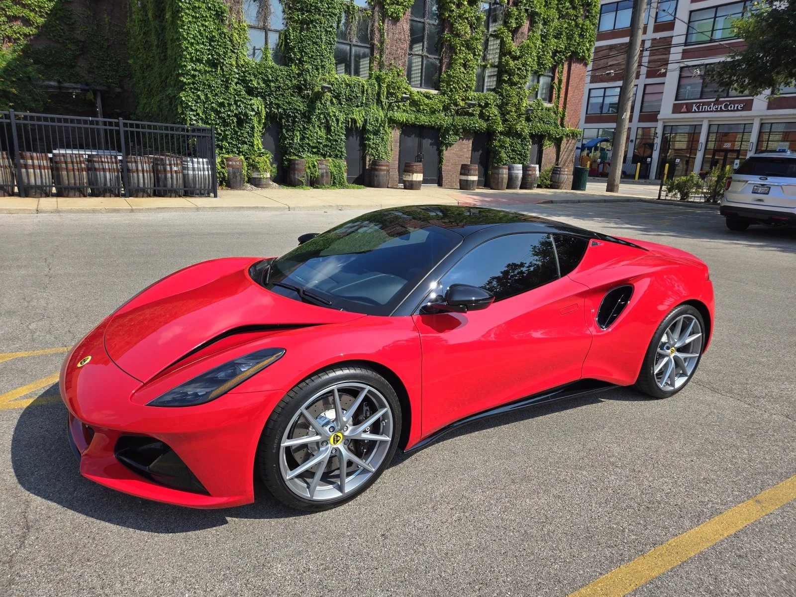

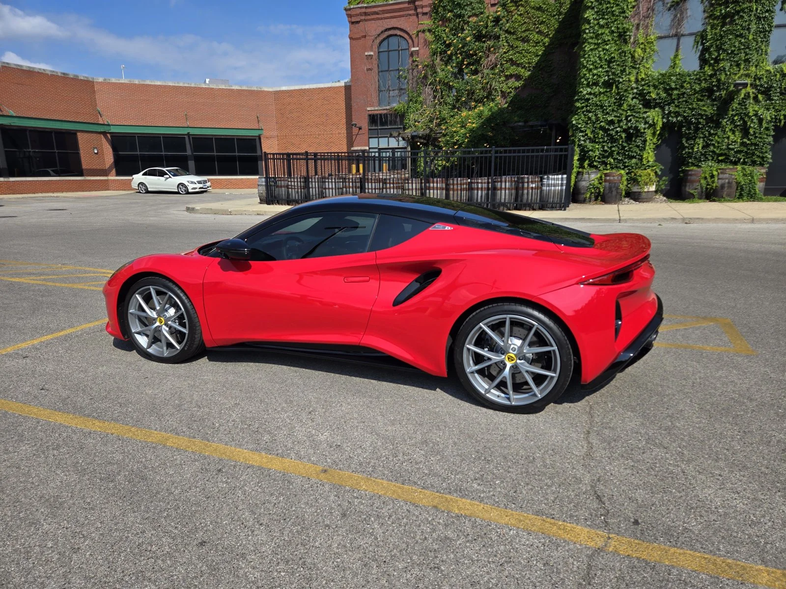

I've really paid attention to my line of sight when looking over my shoulder and can absolutely confirm what kitkat stated earlier, the little windows are simply not a factor.
As for matching the tint on the side windows, I too had planned on that originally. An owner on another thread had I believe a 20% tint and it was a pretty spot on match. Well once I saw 20% in person it was far too dark for my taste and not to mention illegal in IL. In the end I went with 35% (legal in IL) and was pretty amazed at the difference between that and 20%. Still looks amazing in real life with good light inside and from most exterior angles matches nicely with the triangles.

As for matching the tint on the side windows, I too had planned on that originally. An owner on another thread had I believe a 20% tint and it was a pretty spot on match. Well once I saw 20% in person it was simply far too dark for my taste and not to mention illegal in IL. In the end I went with 35% (legal in IL) and was pretty amazed at the difference between that and 20%. Still looks amazing in real life with good light inside and from most exterior angles matches nicely with the triangles.
Thanks - this is helpful feedback informing what I’ll decide to do.
