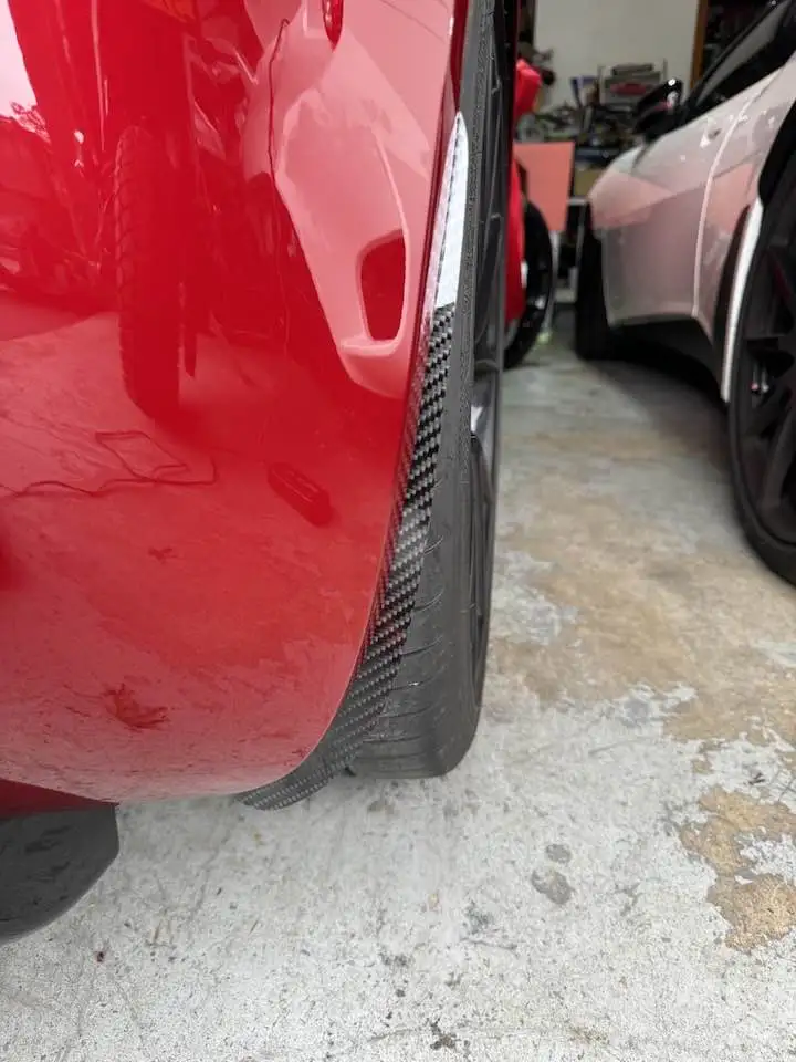

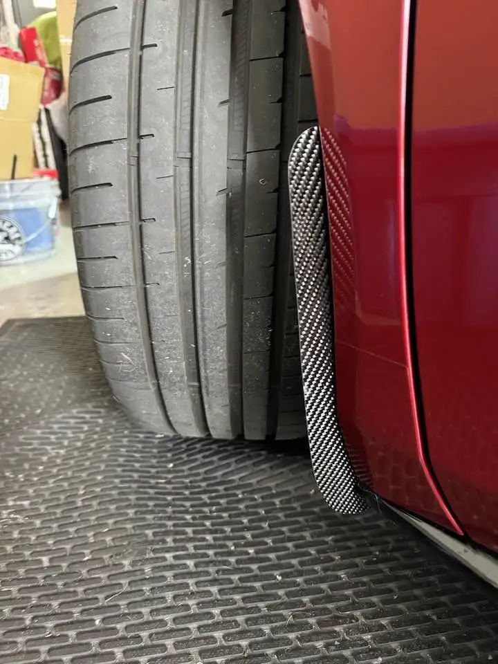

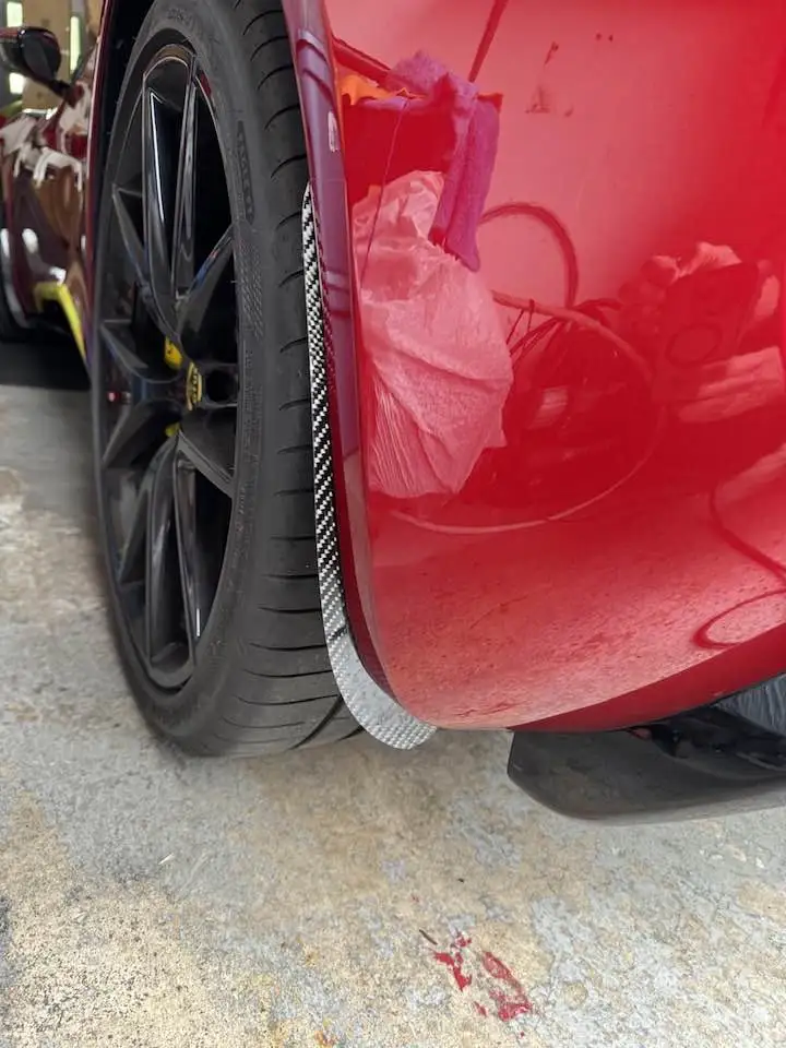

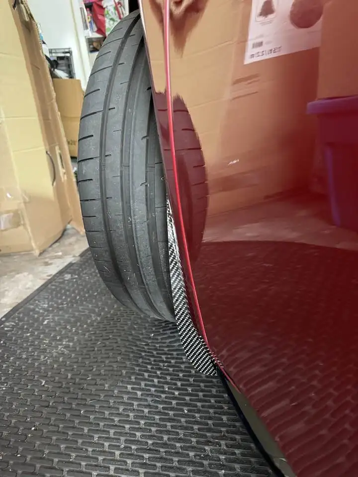

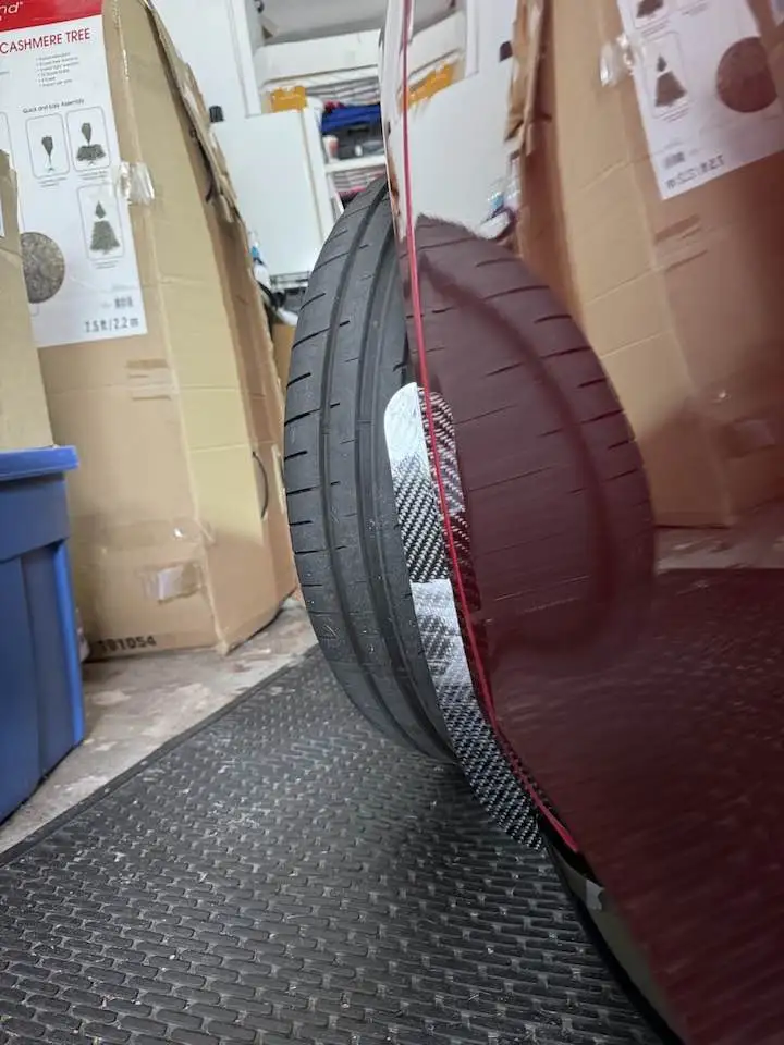

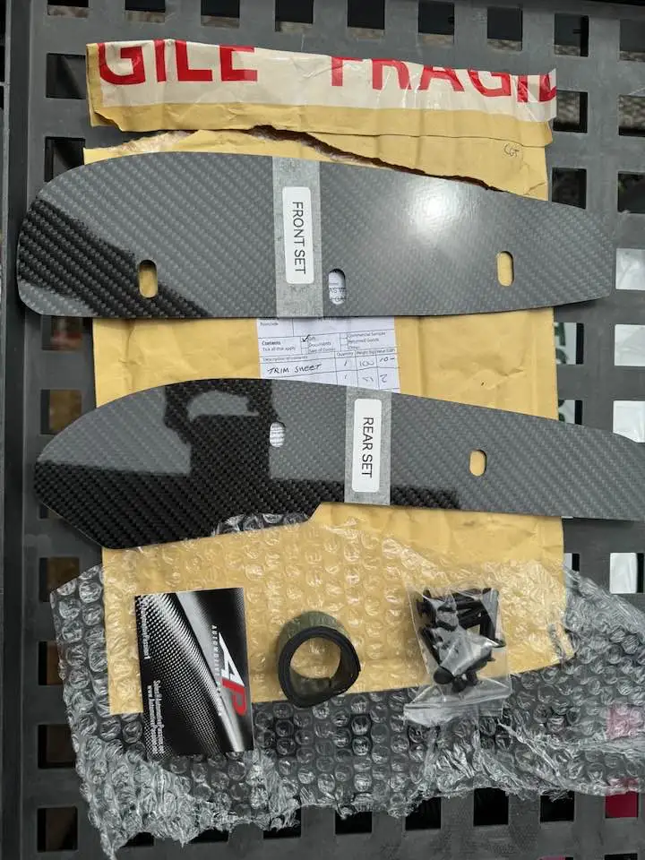

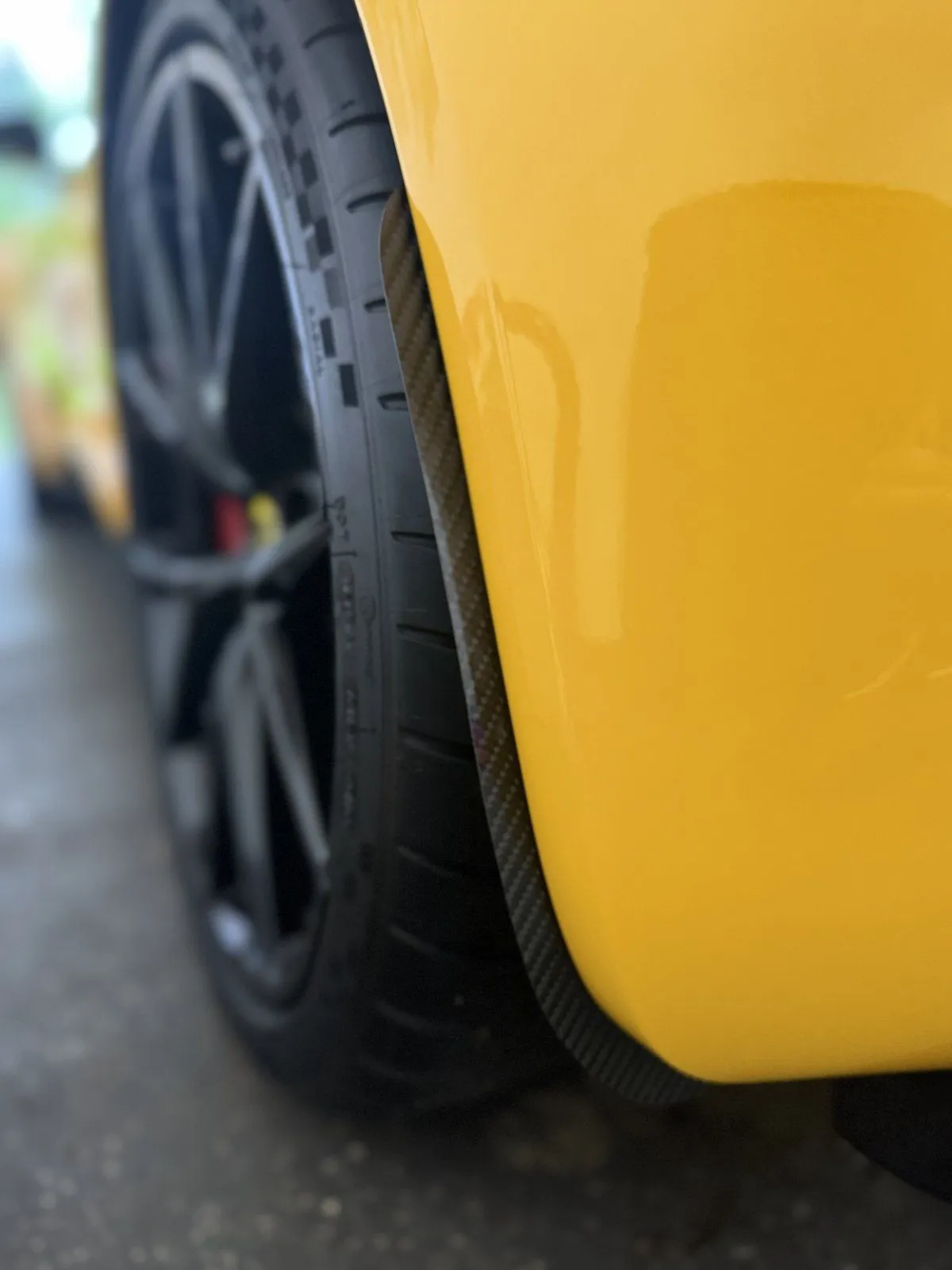

Following up on my last post, today I received and installed my Automotive Passion mud guards. As I had planed, I successfully installed them inside the wheel well liner. All I had to do was make a small (about 4 inch) scissor cut on the lower section of the from wheel well liner to allow the flap to pass through. I also drilled a small whole in the liner to secure a fastener for the top hole. No modifications were needed for the rear mud guard installation. As predicted, wedging the mud guard flap between the wheel well liner and the fender, makes for a more firm installation. I also like the more integrated look of this alternative. Here are some pictures of the result:

Well I think it looks a lot better wedged in and I tried them on both ways, just to be sure. This, of course, is a matter of taste and opinion. As for me, I'm not a fan of the glossy flap noticeably slapped on the inside surface of the matte liner. That triggered alarms all over my ocd radar. The other, and not any less important, reason to wedge them was to get a snugger fit and keep them more firmly in place. When I first installed them on the outside, they felt loose, I could easily slide them by hand by pushing/pulling on them. With wear and aging, this can't be a good thing.
