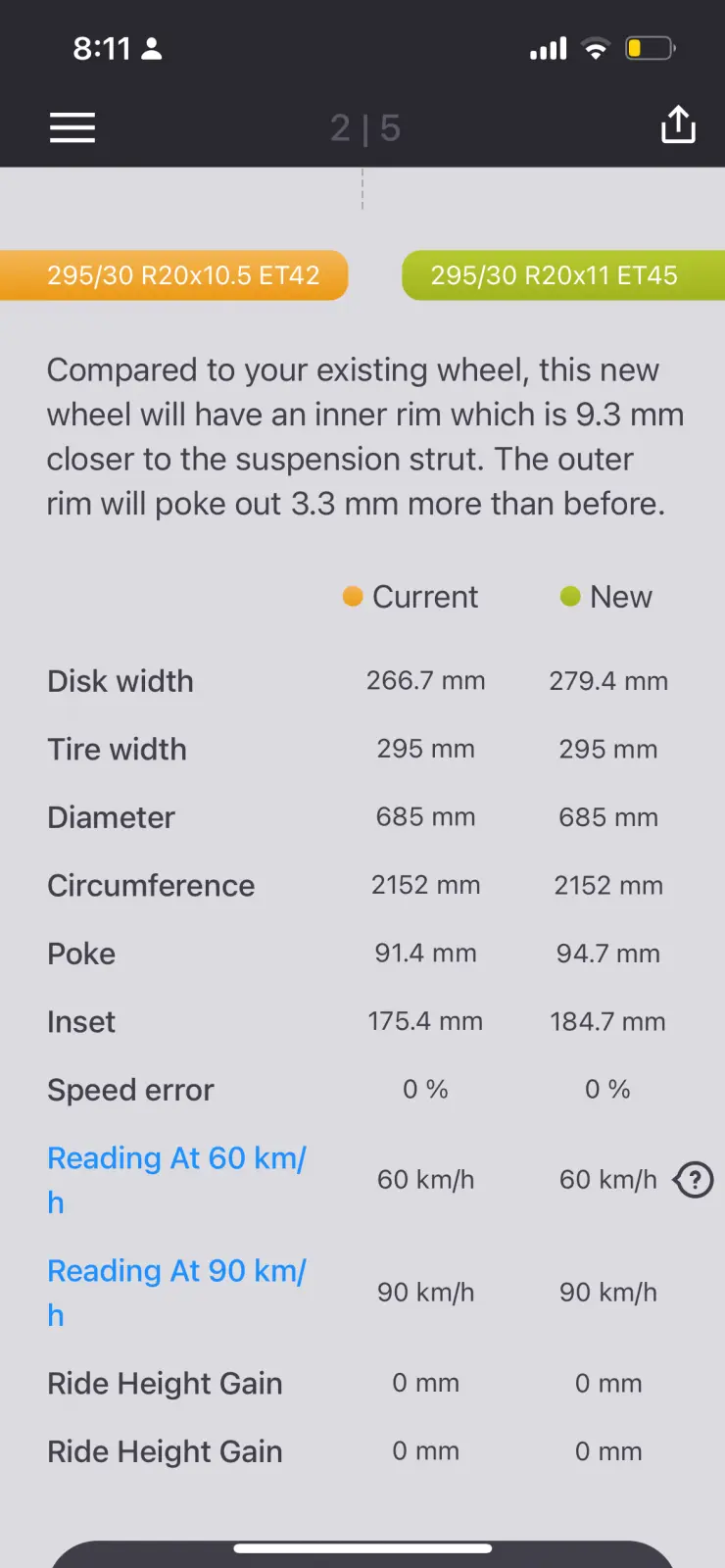

Yes, but that was all taken into account when the wheels were spec’d.
Including spacers, I should have rears pushed out 3mm reference where I was

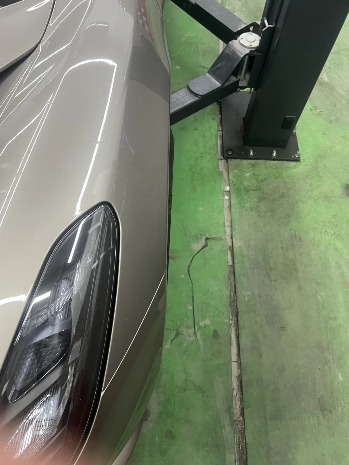

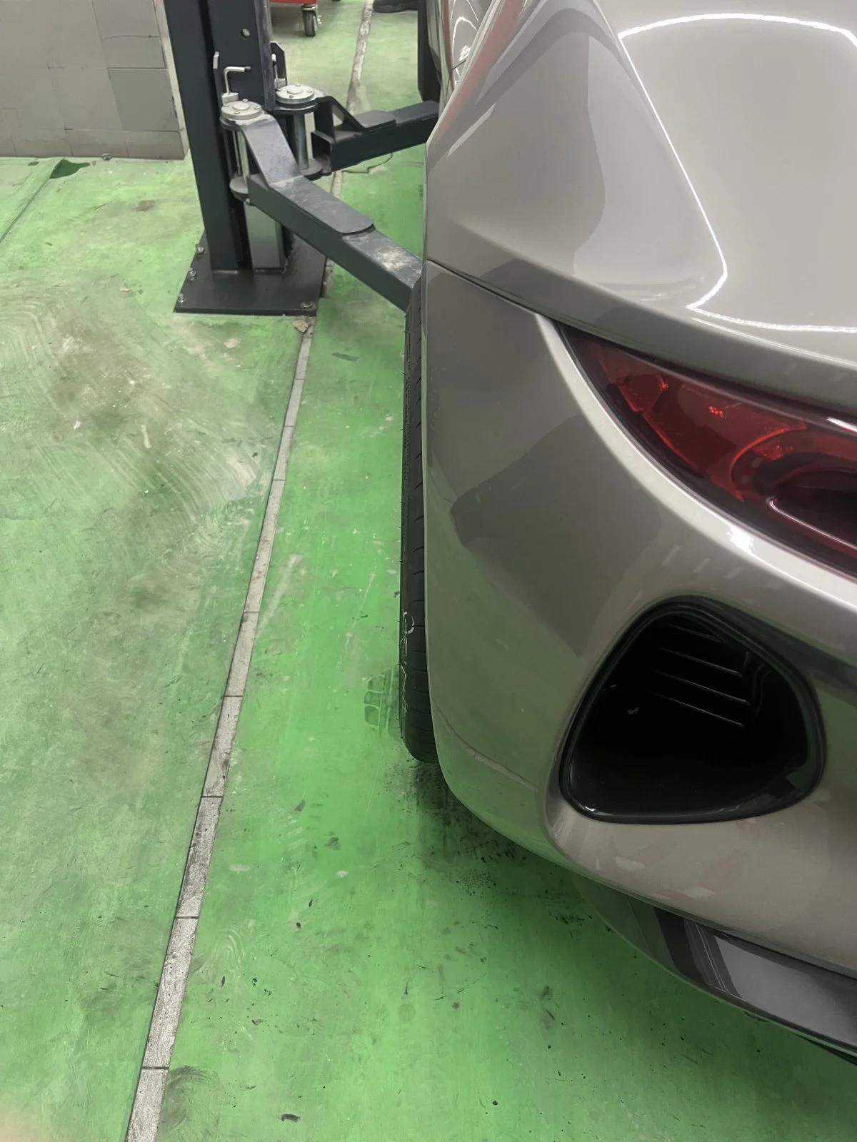

You need to drop the car from the lift before the wheels will "sit" right. Trust us, it will tuck in to flush both front and rear. I am running 47mm/42mm front/rear and it's perfectly flush.
I did and no it doesn’t fix it. It looks shit. As the info is out by 10mm, that lines up with what I have observed

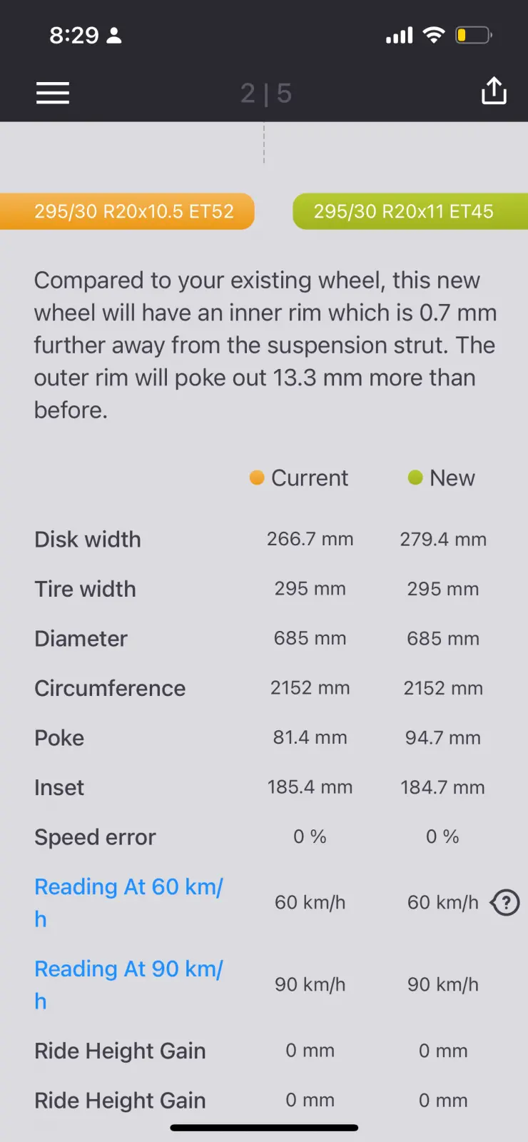

These are the alignments when you start with ET64 (minus 12 for spacers). Poking out 13mm more than before.

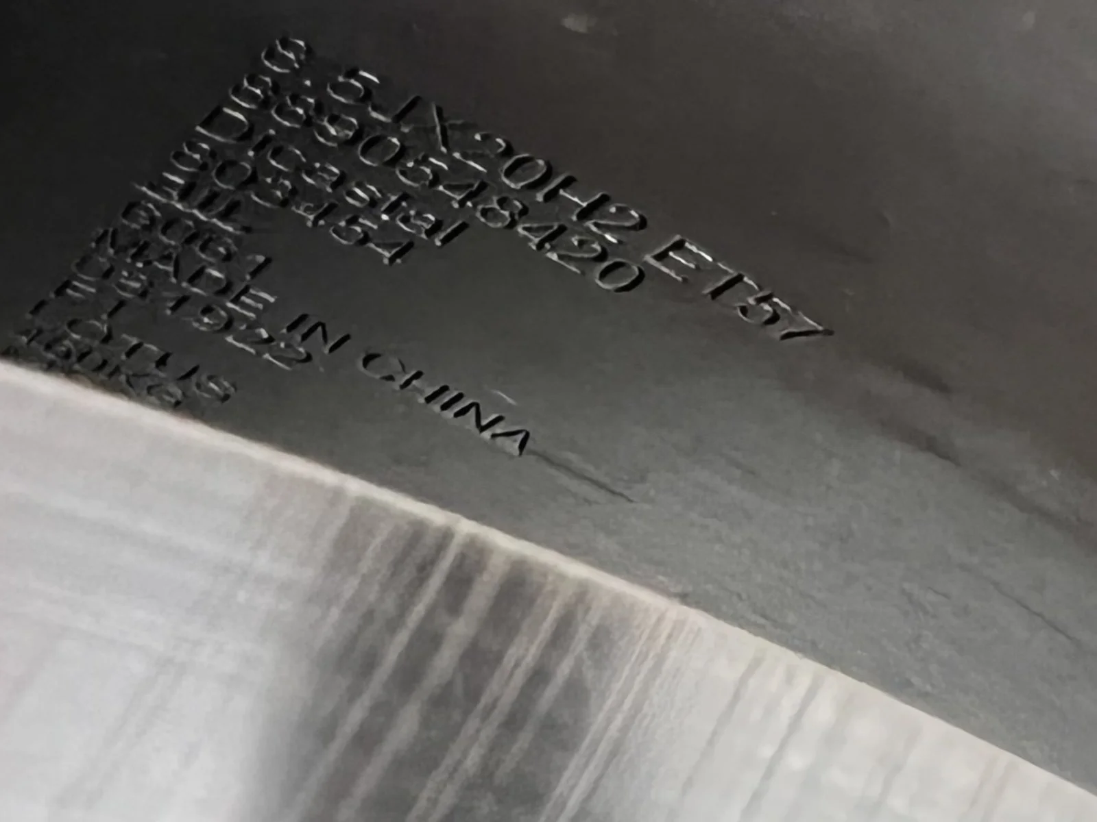

I totally get that you're irritated, I would be too. I wasn't trying to rub salt in the wound.
Just an FYI going forward, many factory wheels have the size and offset information printed on the inside of the wheel or sometimes on the inner mounting surface. The Emira definitely does, and it also has the manufacturer info (Dicastal).
Inside front wheel:
Take a look and see if your factory wheels have this in the rear. If they do, take a pic and we will add it to one of the wheel spec threads here so someone else doesn't get nailed by the same issue.
I'm going to proactively edit a few threads to clarify, hope you can also grab a pic.

I looked today, couldn’t see an ET value stated. I was looking when I realised something wasn’t right and was trying to figure out what the issue might be. Will take a picture tomorrow.
