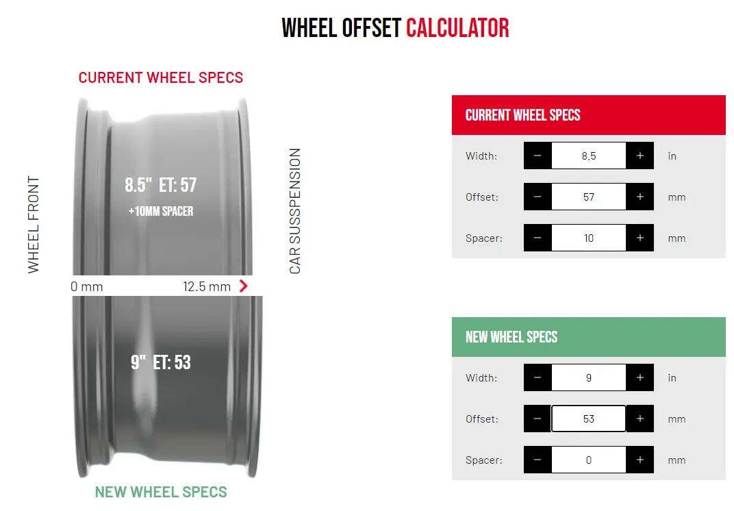

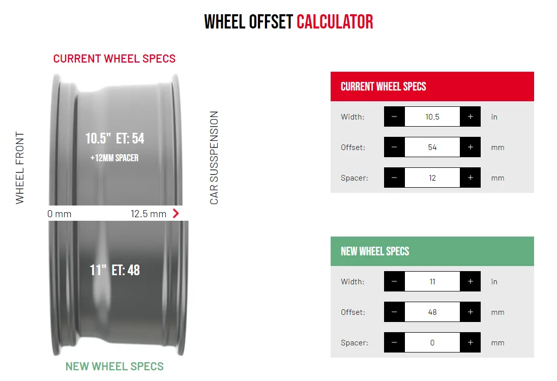

I've read some posts about the spacers, it seems that proper spacers are 10mm front and 12mm rear.
Adding the OEM wheel spec, and with larger rim width, I got this "optimum wheel spec"
FRONT: 9J X ET53 (proper for 245/255 tires)

REAR: 11J X ET54 (proper for 295/305 tires)

Any thoughts or advice?
If you are looking to put more rubber under the Emira sure this is an option and they should both clear.
Two issues however:
Does the Emira need more tire or are you stretching the stock tire sizes further?
Are there wheels in a desirable design with the offsets and 1/2" wider widths you're targeting?
Kitkat makes a good point about stretching tyres to fit the rims. I think stretched tyres on wider rims looks worse than the standard set up with spacers.
