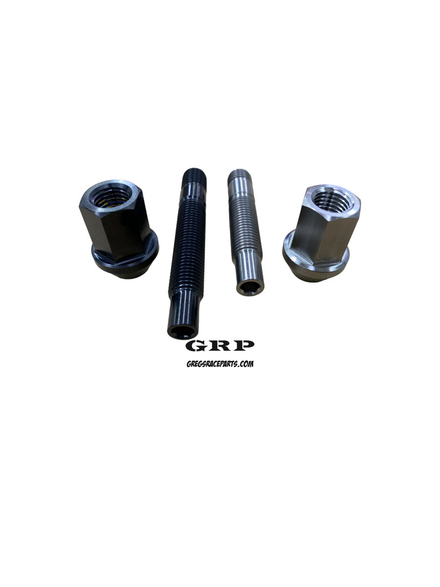

Regarding longer wheel fittings for cars with spacers, wouldn’t it be better the fit these:
Surely the nut fitting with the taper could be held in place and the torque set tightened up the bolt part, or am I missing something?
I’m just referring back to comments where the paint could be damaged using the standard type if they don’t have that facial part that stays still to save the paint getting damages.
