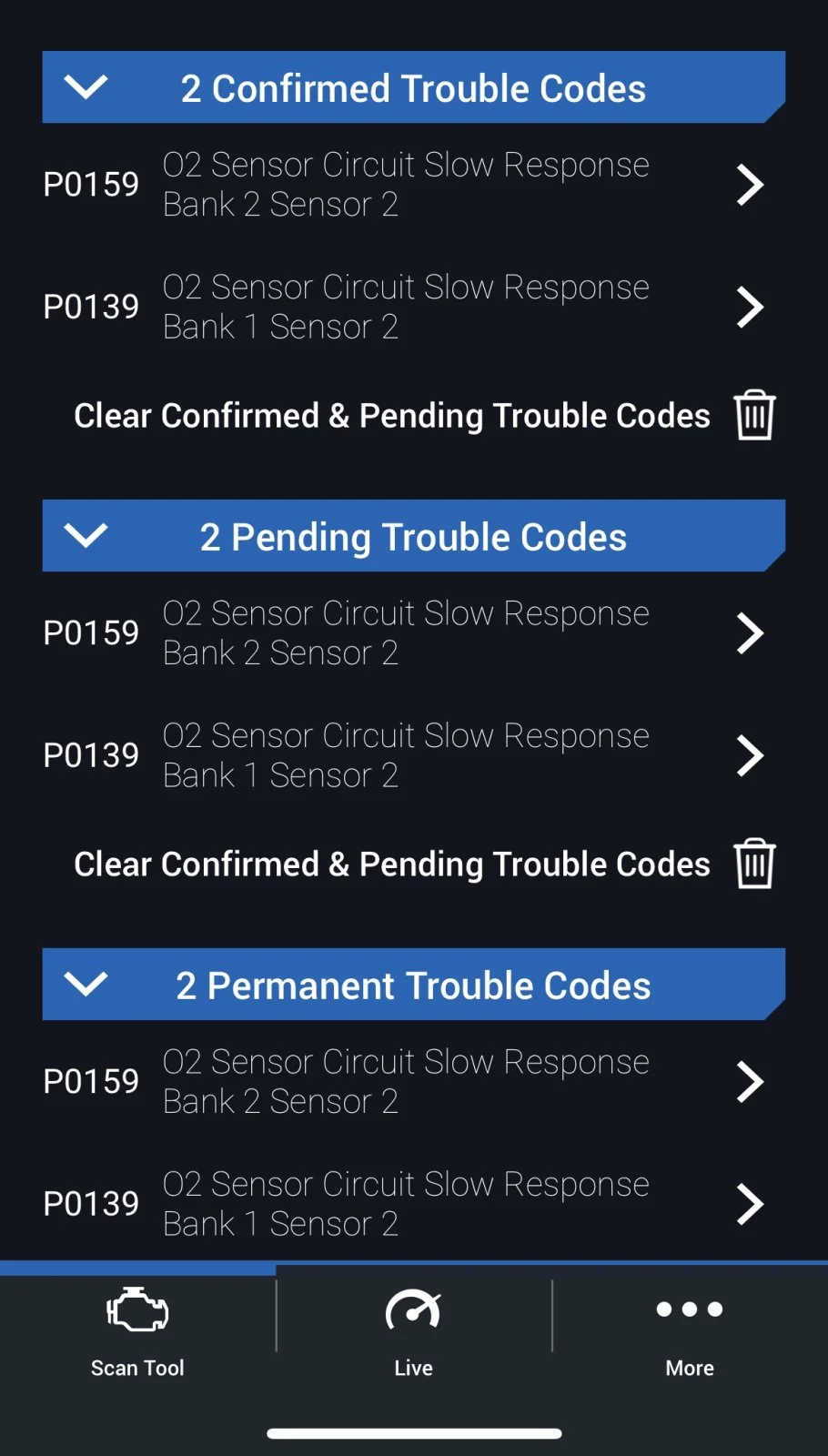

My car didn’t through the 2099 codes but it threw the below. Interesting your dealer said it was o2 sensors. My dealer replaced all o2 sensors and all cats and the car had been good ever since. It’s been 1500 miles since.
  • #7
Thanks for the data points. Glad to hear yours is sorted. Thankfully everything seems to just be tied to Bank 2 for me. I’ve been thinking it’s sensors but I suppose it could be the cat as well.
