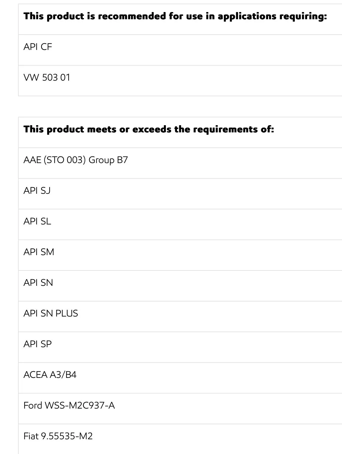

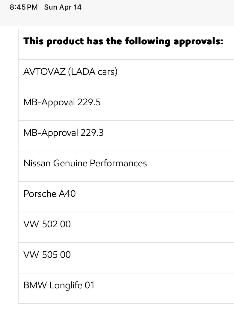

My go to oil for the Porsche 718 Spyder and both BMW SUV’s and soon Emira at 1,000 miles…..can’t beat the price, and meets most european spec A40 for porsche LL01 for Bmw, etc….
www.walmart.com/ip/Mobil-1-FS-European-Car-Formula-Full-Synthetic-Motor-Oil-0W-40-12-Quart/893400295
I removed my GPF on the Spyder, so now A40 is fine for me, C40 was introduced for GPF engines😄
I am sure you can get it Canada as well, this is $5.-/qt……..not that I like Walmart, but I think it can be trusted, over amazon for sure…..

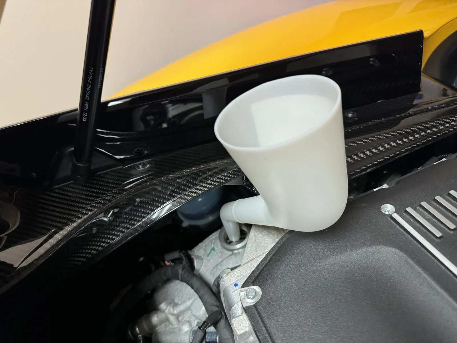

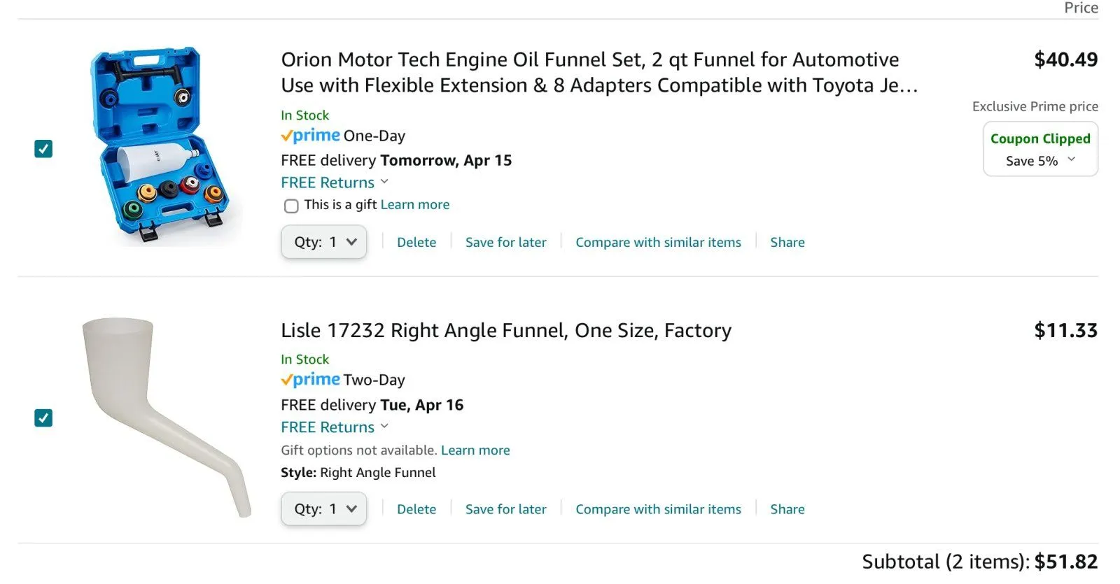

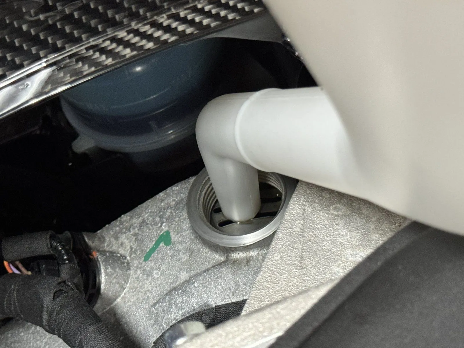

I do not think the funnel will work, you have max 4-6” above the filler cap, and you would have no straight pour access anyways, I am looking at these 2 options….
www.amazon.com/gp/product/B08H4ZHKN5/ref=ox_sc_act_title_1?smid=A1R5RH6SRZN4Q4&psc=1
www.amazon.com/gp/product/B00MEPIU4M/ref=ox_sc_act_title_2?smid=ATVPDKIKX0DER&th=1

Thanks Barcino2012. If this helps fellow Canadians, I found the Lisle right angle funnel for sale at C$13.83, which is better than the amazon.ca price of $23.34. It's available at MPR Tools:
Hopefully it works for the Emira, otherwise I've added yet another thing in my garage for my spouse to look at and question (lol).

Guess I paid too much for the Motivx oil change tools. Oh well. At least I now know the LIsle funnel I bought will work with the Emira although I would have preferred the lid on it. I haven't found a place in Canada to purchase the "lid retro kit" but here's a few places in the States for anyone interested:
