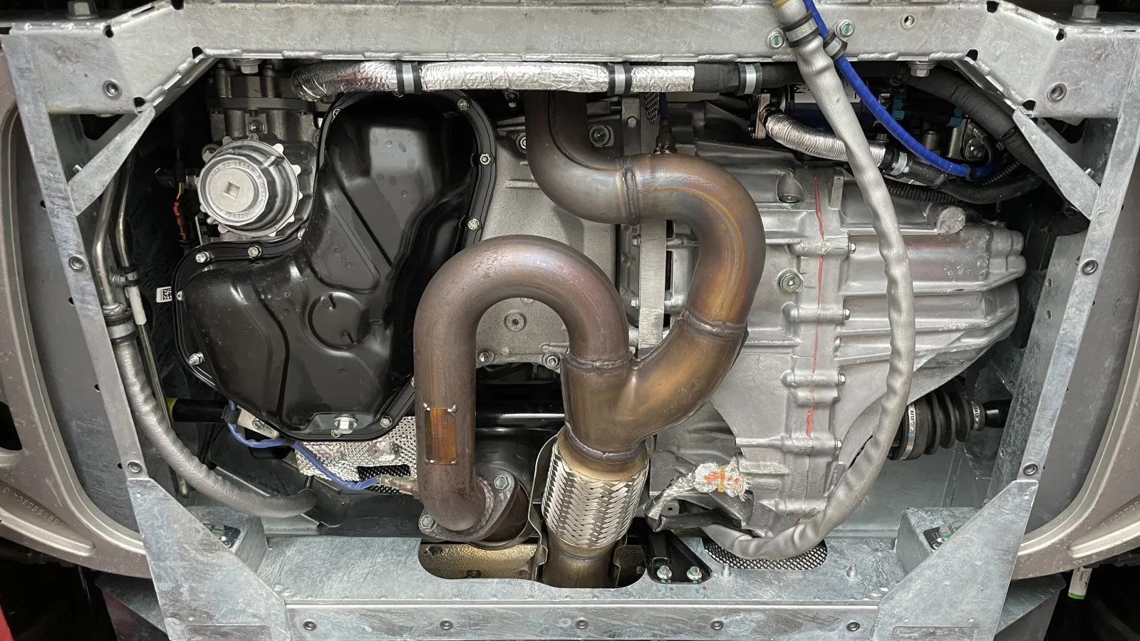

Thanks to Porter for these links. I just completed my 1000k-ish change. A couple notes from me:
1. I unscrewed pretty much every 10mm, 7mm and 4mm allen bolts from the back third of the car. I left the upper rear most allen heads on the rear diffuser on but I think next time I will just take the diffuser off entirely and then the rear tray, rather than letting it hang down and sliding the aluminum rear tray out. There might be 30 bolts to remove, I didn't count but it is most of them. If someone can tell which are optional, I'd be curious. There is a gray rubber insulated something on the rear left of the car that will hang down once the under tray is removed. I didn't like that this just rests on the tray - I am going to look for wear at my 5k oil change and see if there is something I can do to improve this potential wear/failure point.
2. Under the rear hatch, the lower plastic engine surround pulls straight up and out and is held in by push grommets. The upper section pulls up from the lower edge and horizontally back from the upper edge. You do not need to take any allen heads out to remove these pieces. Just pull them out.
3. The oil drain bolt crush washer is stuck on really tight. At the time I wasn't sure if it came off or not - after reading an earlier comment, apparently you have to pry it off. I tried a couple of times but didn't want to force it, so I kept it on and just used a new one on top of the old one but that's not ideal. Hopefully it's all good and doesn't weep oil.
4. The aftermarket mag oil plug recommended by porter has quite a few less threads than the OEM one. I used it anyway, and torqued it to 20 NM, but definitely didn't feel good about that. If I would have known that compromise, I probably wouldn't have bought it, but I figured if I strip it, then I would get the baffled oil pan as an excuse. Next oil change if there is debris on the mag I will keep using it, otherwise I will put the OEM one back in.
5. This was my first oil filter housing experience that came in two pieces. I didn't know there was an inner and an outer until I took the entire thing out. I am assuming the only reason for the inner removable section is to drain the oil before taking off the outer housing. I am assuming if you take the entire housing off, like I did, you don't have to mess with the inner part. It really wasn't messy, I'm surprised that is the purpose of the inner section, unless I am missing something. The Purolator Boss seemed to fit perfectly - I was paranoid about getting a knock-off filter and didn't want to drive to my dealership. That oil filter housing tool recommended above is super gucci and probably overkill - there is likely a cheaper one out there but I was too lazy to search.
5. Roughly 6 qt came out and I put roughly 6 qt back in to arrive in the middle of the high and low dots on the dip stick. The oil after 1,000 was mostly clean but the new oil was definitely cleaner, as I had a hard time actually seeing where it was on the dip stick. It gives me good piece of mind to know it has clean oil after a proper break in.
I hope this is helpful to someone!

You mentioned a “gray rubber insulated something”. I believe you can see it in this picture.
10mm bolts are the ones holding the section in place. i wanna say they were a total of 12.
I just goit the car up on ramps
The 7mm might be optional, they hold two smaller plates to the main structure - but there is overlap w the rear diffuser-be great if those were optional!
Yeah, exactly. It hangs down and rests directly on the bottom aero cover. I’ll zip tie some rubber or foam padding at the low point next oil change. Curious on what others think if it’s a non issue or something to deal w.
