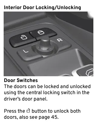

I think if you use the unlock button in the car prior to opening the door it will only take one pull. Dumb.

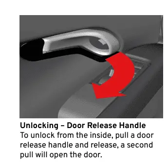

This is standard on most European cars - if the doors are locked (whether from inside, outside or by autolock when moving [if set in options]) the first pull of the internal handle unlocks, second pull opens the door. The only exception is if there is a "deadlock" option on the remote (sometimes an extra button on the remote or a second press of the remote lock button - the Emira doesn't have this though) then the internal handle remains locked.
"In the event of an accident that has deployed an airbag, doors will unlock automatically."
It's "as designed" - It's even in the manual....
