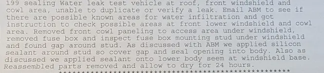

Just got the car back from the dealer. This is what they found and did for a fix. I need to wait 24 hours and I can do a test wash again.

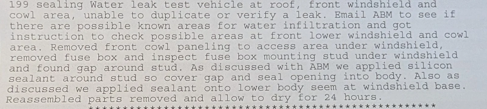

"fuse box mounting stud under windshield"... curious. gonna have to look for that. no water in my car, but still curious to see where the possible ingress is. thanks for sharing!
The window and door seals can be helped out by putting Shin Etsu grease on them. The grease causes them to fatten up slightly so they seal better, and it eliminates any squeaks.
Wouldn't that "stud" under the fuse box be covered with the rubber AC resistor pack "apron" ?
Confirmed that the problem is fixed with the steps the dealer took.

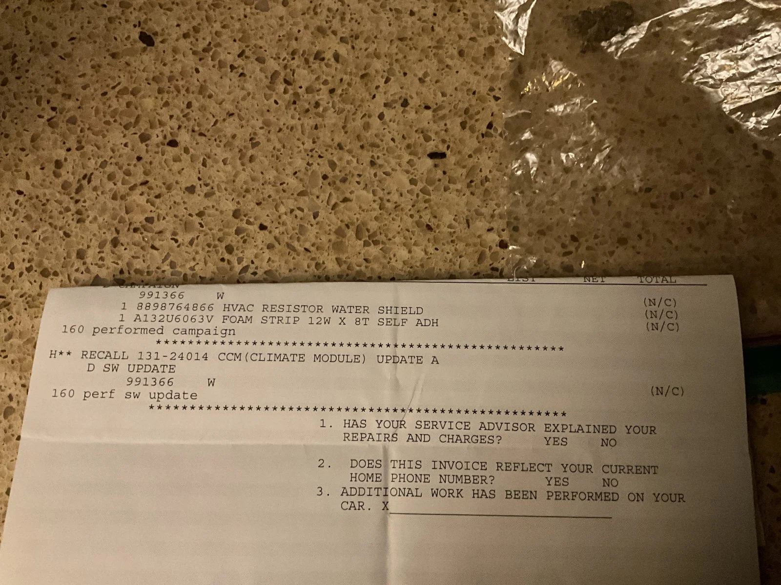

Check out my service sheet image in the post I made in Monday. Sealant at base of windshield and fuse panel bolts.

Any idea what part they needed? Mine was just sealant, but if it happens again. Thanks!
It took 5 weeks they replace the windows seals, and I had to wait for a cover for something on the firewall.
