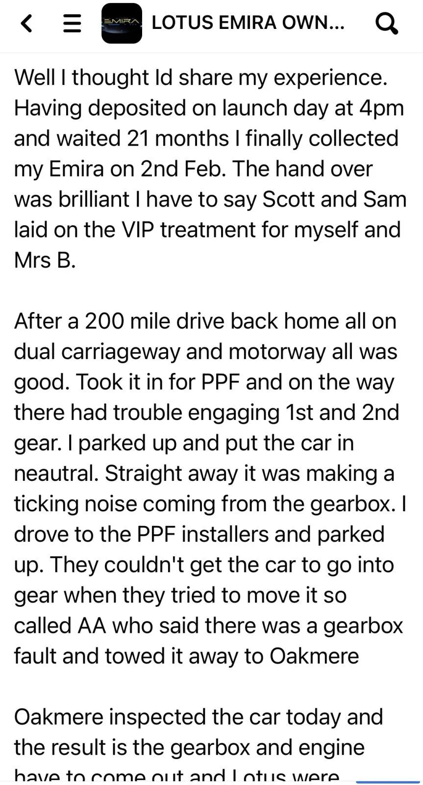

Just seen a post on the Facebook page about yet another owner who has had the car a day and already has gearbox failure. Think this is the closest I’ve been to pulling out. Whole reason I sold the supra is due to it being away being fixed more than I could drive it. I won’t accept the same issue from a brand new car….

It’s on FB posted an hour ago

"Not going into gear" is very unlikely to be gearbox failure on this type of transmission. Far more likely that the adjustment came loose on the cable linkage for some reason, and it simply isn't moving the input clevis far enough to engage the gear.
I'm not making excuses, it would still be a significant manufacturing screw-up, but it's definitely not the same as total mechanical failure of a major drivetrain component, which is what several people seem to be suggesting or assuming here.

@Porter , that makes sense. I wonder then why they need to do major surgery, according to the FB post. Maybe Lotus is guessing at trying to fix this and/or other issues?

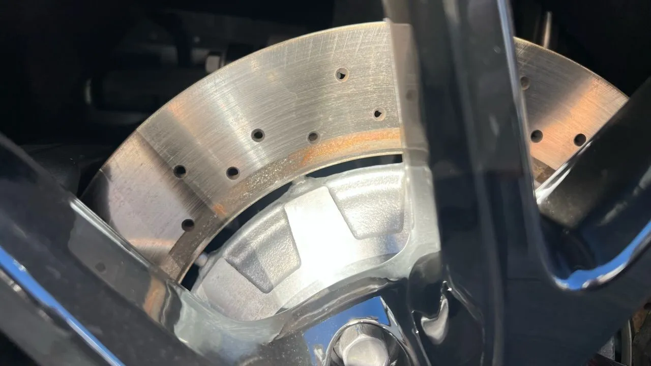

There’s something wrong with your brake pads.
They’re only sweeping about half the disk.
Wow, I didn't even notice that. Looks like a chunk of the pad broke off, some of it is still stuck to the rotor that can be seen on the right side of the rotor in the photo. You can also see where the center seam/channel of the brake pad left a mark on that location of the rotor. The rotors are probably fine, but the pads are defective. They might be able to clean up the rotor but one could argue that having been driven with half a brake pad for some miles, it's no longer serviceable for a sports car.

The dealer probably has no clue and are simply collecting the car for Lotus to examine.
@Sid seriously, that car needs to be looked at and fixed by your dealer. Looks like the pad failed. Possible that it was weather related when the car was stored waiting on build parts or something.

This is seriously concerning. How are these passing PDI? @Sid please let us know how your dealer responds. New pads and rotors are needed ASAP!

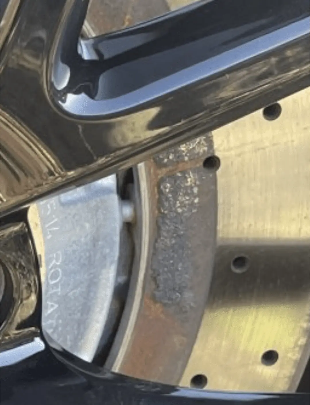

After noticing @Sid ‘s brake issue I thought I’d have a proper look at mine and…
Nowhere near as bad but it’s another one not noticed at PDI.
B&C will be sorting it tomorrow.
Have B&C said what’s caused it and what the fix is?
