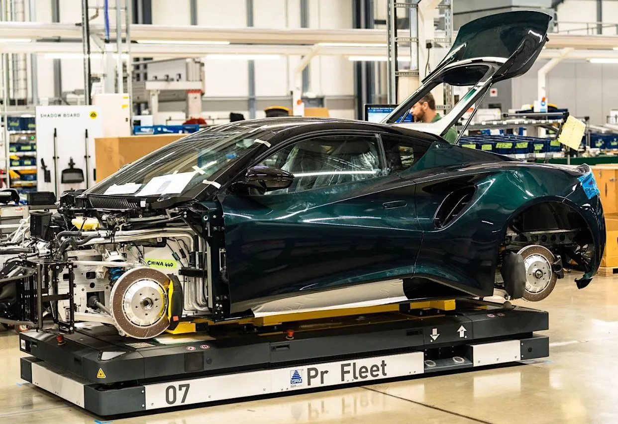

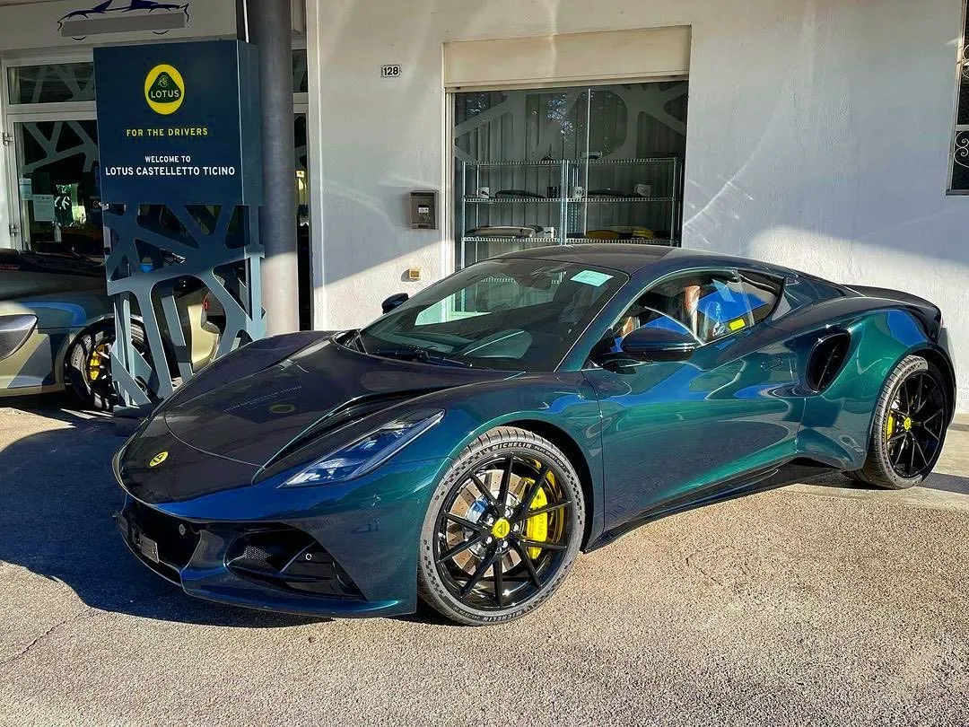

I have a folder with a LOT of photos of Emiras, from VP Cars, to customer cars, and none of the cars in any of the photos have any rust on the rotors with the exception of ONE photo of an Emira sitting in front of an Italian dealership, so this phenomenon has to be limited to cars that have left the factory and were stored elsewhere before the customer received it.
Here's a picture of an Emira on the production line, and you can clearly see the condition of the rotors, and how much of the rotor surface area the pads are actually supposed to cover.

Out of all the photos I have, here's the only one that showed a hint of rust:
This doesn't appear to be a widespread issue, but rather something that seems to be happening at either certain dealerships, storing facilities after they've left the factory, or perhaps sitting on transport trucks long enough to be exposed to humidity.
I don't see it as a panic issue, but rather something the dealerships should be responsible for, and something that's easily remedied.

Isn't the rust on the green Emira's rotors just normal surface rust from washing the car? Surface rust can appear on a rotor within a few minutes and just gets scrubbed away when you next drive the car. Some detailers take the car for a 30-second drive after washing, and hit the brakes a couple of times to prevent this.
You can also use a product such as Hyde's Rustopper.
Uncoated cast iron can show rust within seconds of moisture contact. Fortunately, at least based upon my experience, that rust is quickly removed when the brakes are applied. I rarely have to wash any car because I keep them clean of dust with a California duster, and if needed, spray 3D waterless car wash, wipe (by dragging a microfiber towel over the beads), and then buff. Thus, the rotors rarely get wet unless I get caught in the rain.
Yes on the green car but there are cars that were due to be delivered with pads stuck to the discs so they had to replaced and delay delivery. Some which escaped the PDI process have been delivered with seriously pitted discs at the base or cracked pads. Something to be aware of.
If BCA had simply sprayed the pads with brake cleaner spray before trying to move the cars, this likely wouldn't have happened. Brakleen usually releases weather-adhered pads in all but the absolutely worst cases.

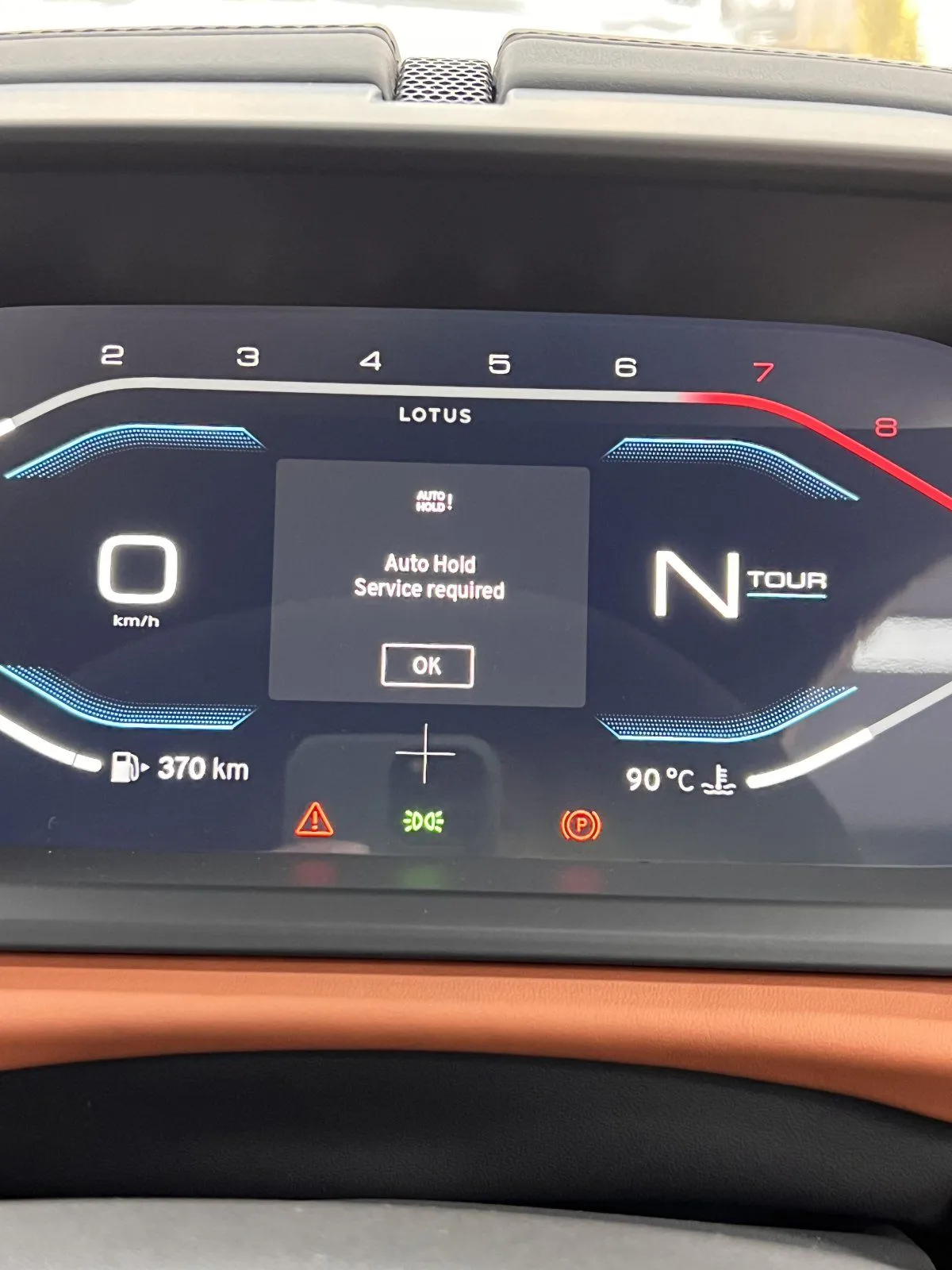

New issue found … Auto Hold failure 500km in. Any ways of troubleshooting / resetting this manually? Picture attached.
