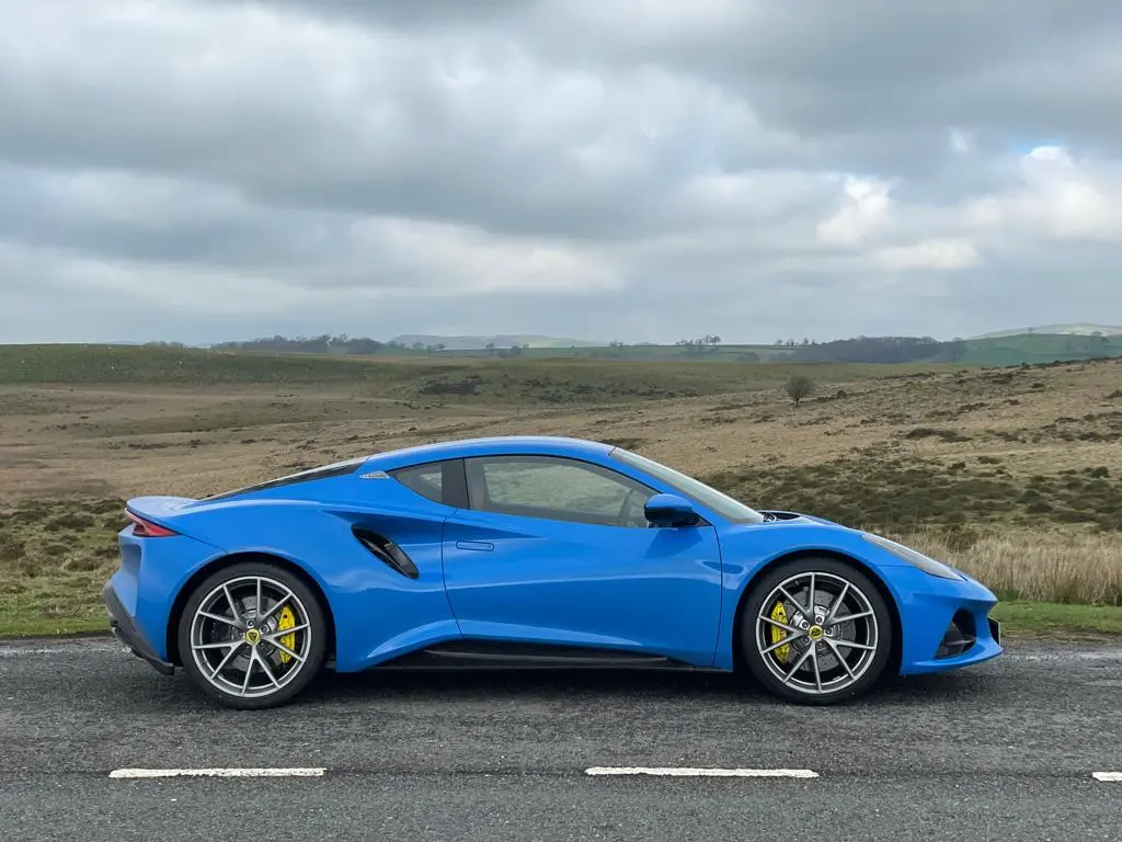

This is the post we'd hoped wouldn't be needed. We collected the car from the factory last Friday and with the exception of the known wiper problem we loved the first 400 miles. Then the sun came out and it was apparent the air conditioning simply doesn't work, not even slightly. After thirteen attempts to contact Lotus they said take it to a dealer. We don't have a nearby dealer so after more arguing they agreed to send an AA technician who also confirmed the air conditioning doesn't work. Again told to take to a dealer. The factory collection was a great experience but to be charged more to collect a faulty car and then to be offered no support has somewhat ruined the experience. I wonder how many cars collected during the winter don't have functioning air conditioning.
Sorry to read this! We have had some others report faulty A/C systems, so you're not alone.
I’m curious to find out what the root cause of these AC issues is as it seems there’s a pattern here. I suspect it’s a gas leak due to a poorly tightened fitting on the high pressure pipe work that leaks when the AC is first used under pressure. Sometimes the leak is slow and sometimes it’s faster.
Had the same issue occur in a brand new Mazda. A few o-rings and gas re-pressurisation later it was back to normal and cooling fine. I doubt it would be anything with the Denso AC compressor as they tend to be bullet proof.
It's such a shame because otherwise the car is amazing.
Keep us posted and good luck! Hopefully it's an easy fix (whenever you eventually get someone to look at it).
