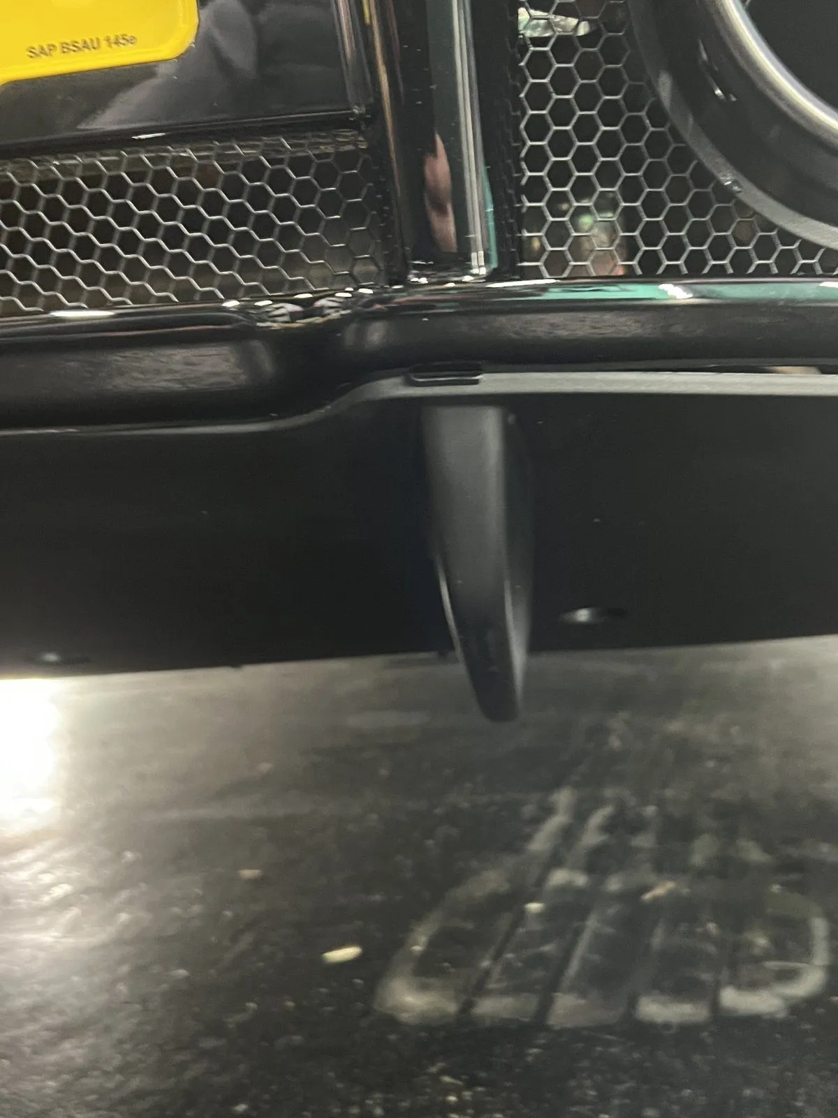

Just had the car detailed and ceramic coated (pics to follow). Detailer noticed the rear diffuser hasn’t been fitted correctly with one of the locating tabs not pushed in

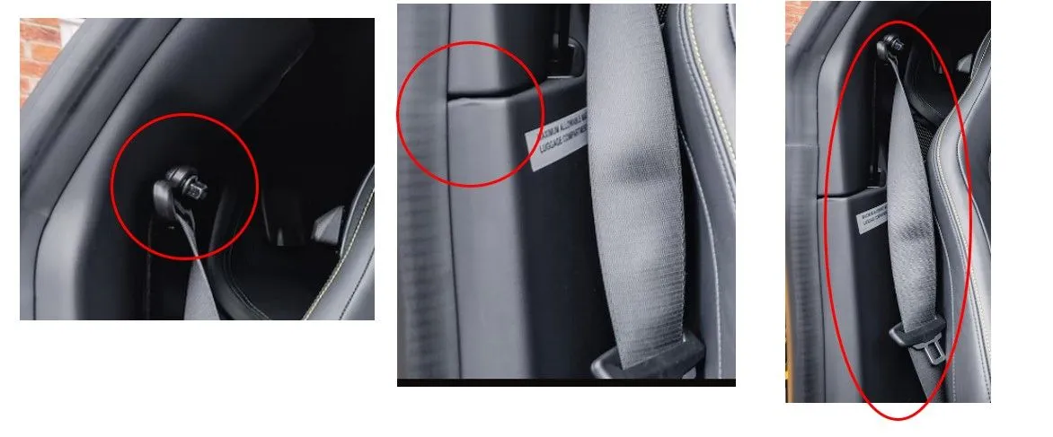

I know I'm like a stuck record (for those that remember such a thing) but further to my comments about the seat belt in the demonstrator, I've looked at the photos of the Emira on Collecting Cars. The upper mount bolt has again been installed without great care, the cover is also missing (on both belts this time), there appears minor damage on the b pillar trim (possible removed to fit belt?) and the belt has been fitted incorrectly. I can't believe the buckle would have twisted round from 11 miles of use so that's how it's likely to have been installed.
Factory checks (if done post belt fitment) and a PDI must have failed to identify the issues.
A large exposed steel bolt in that part of the cabin is hardly a good feature.
