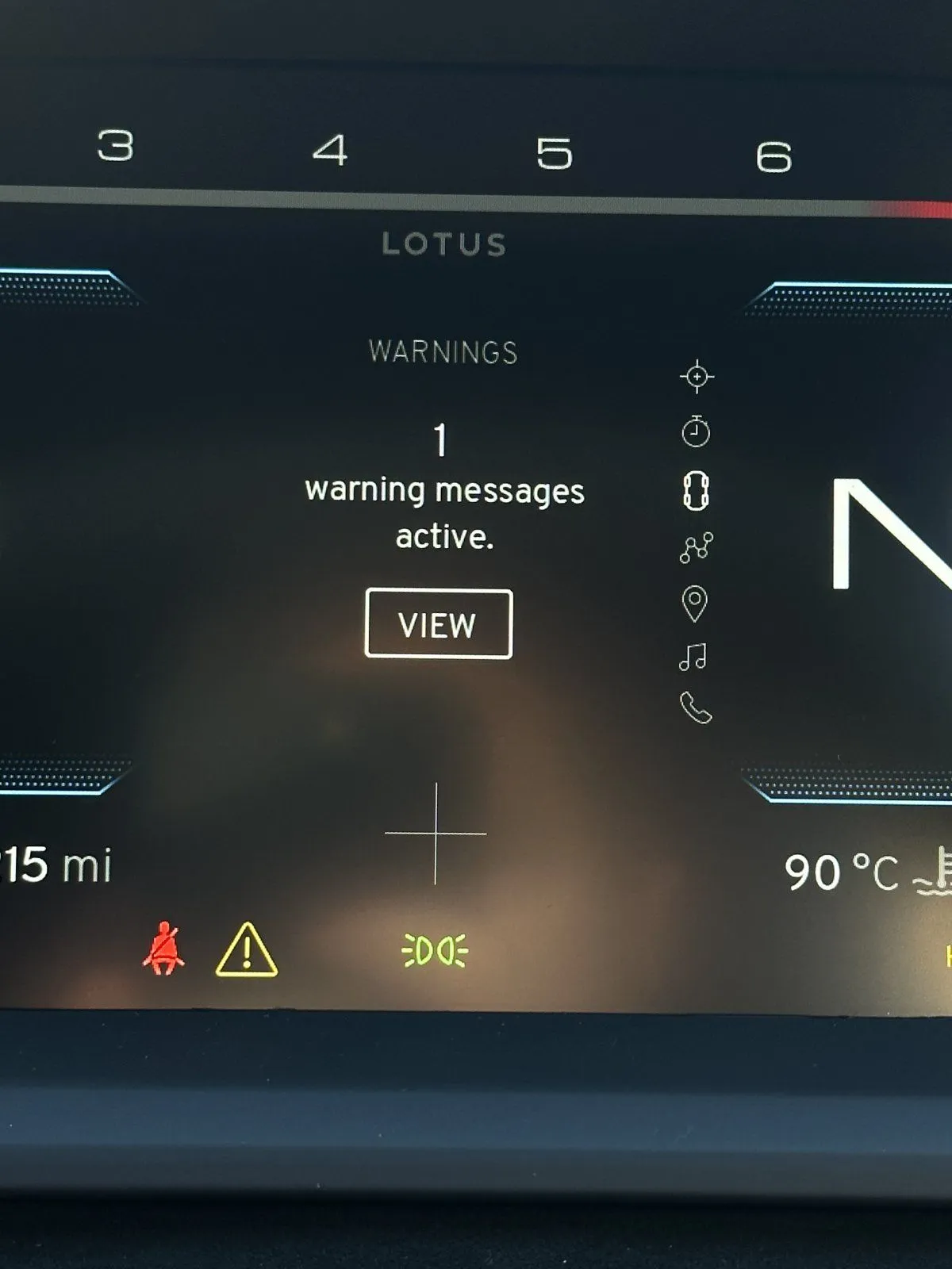

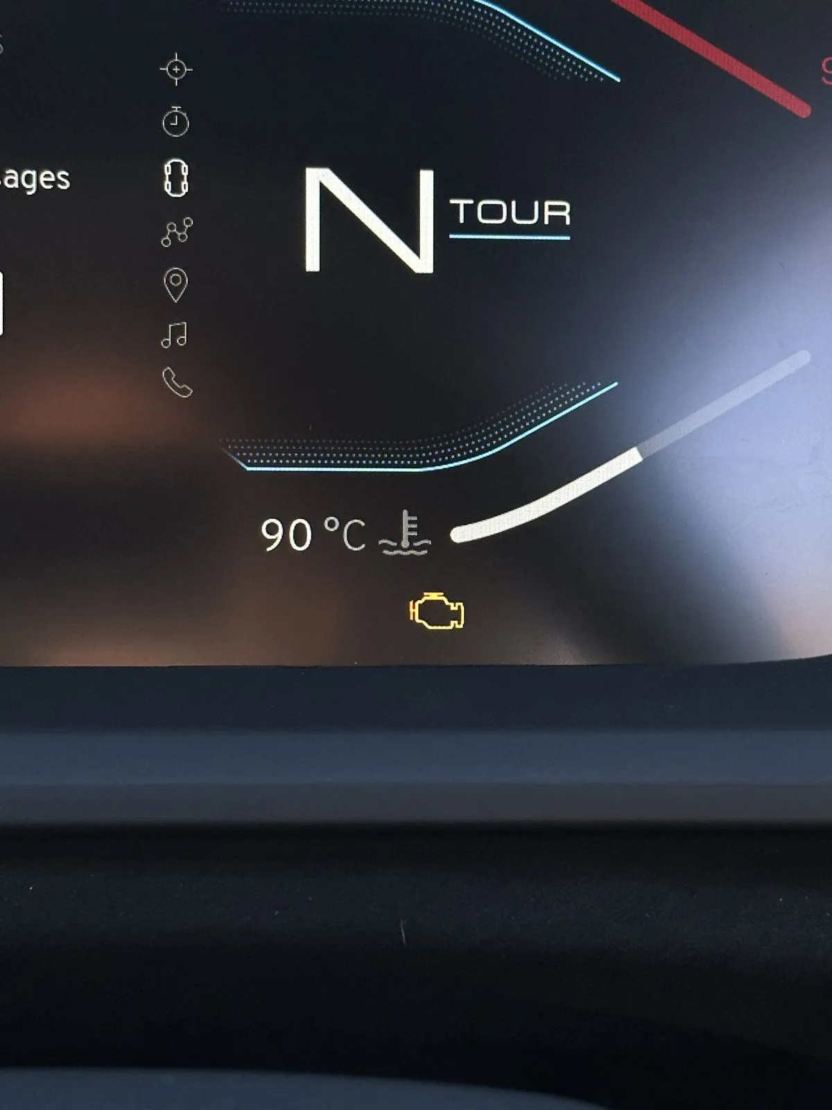

Hi all!
Received my Emira a couple of weeks ago, first proper drive and the Engine Light comes on….
“reduced acceleration” comes up if you try and put your foot down.
Lotus have said they know about an issue and the solution is a software update, which apparently is now ready… BUT, the software to get the update onto the car is broken, so they are hoping to have a fix in the next 7 days.

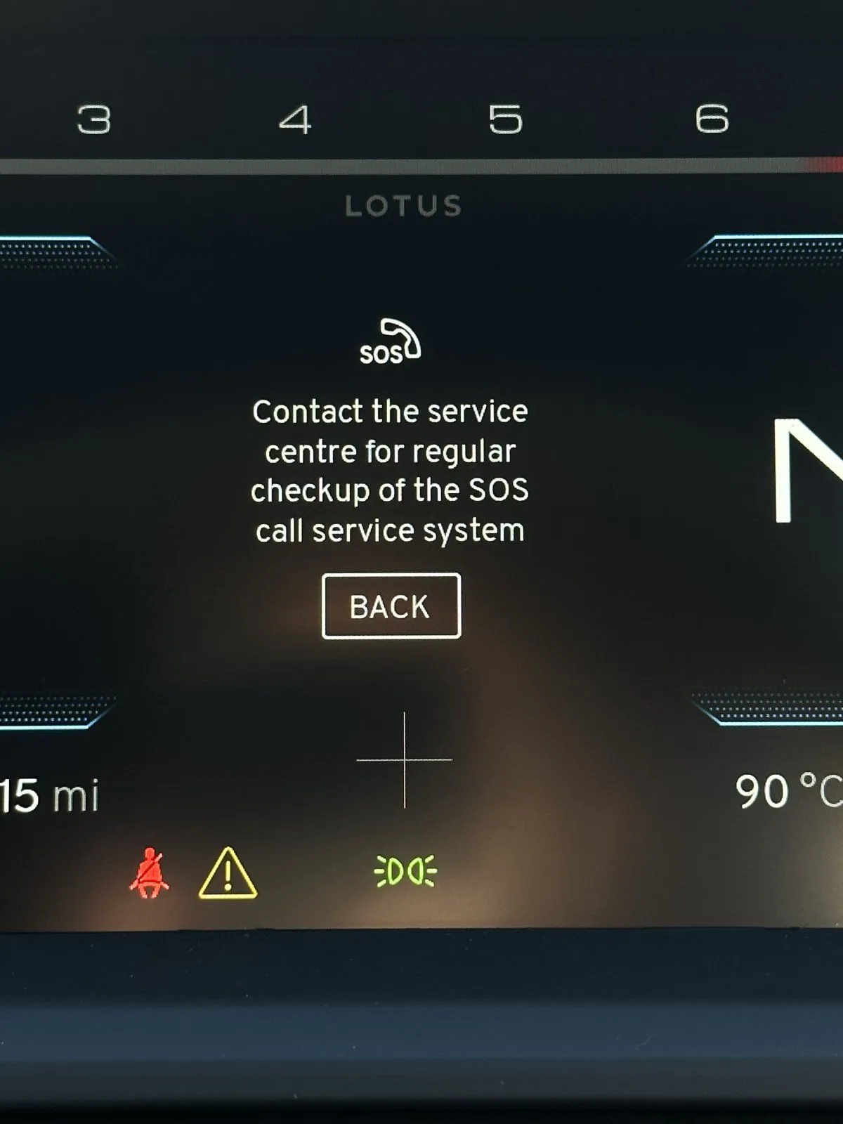

I also get a SOS error message come up but I believe that’s because the car lives underground when not driving so it can’t get a signal. It seems to only go off after at least an hour outside but the warning triangle can pop up again.
The SOS system is integrated with cellular mobile, so if the car is underground without mobile signal, then it gives a warning that SOS is not available in case it is a hardware error. I guess the message could be a bit clearer..

Hi all!
Welcome to the forum @FarmerJ and congratulations on being one of the early Emira customers. It would be great if you could post a bit more about the car, your car history and impressions of delivery and first weeks of ownership over on the Introductions sub-forum:
Thanks for the info about the engine light warning. Good that it's already known about and has a solution, bad that they let cars out to customers with a known issue and that they can't currently deliver a fix. One of the downsides of not having an Over The Air capability on the car is that software updates are going to involve a trip to the dealer. For a lot of people that will mean a long trip.
There have been a couple of reported examples of the engine light, both on UK dealer demo cars, so I'll add your info to the table on post #1. Please keep us updated about the fix and any further info from Lotus on causes.
The SOS warning hasn't been reported before. Underground parking is likely to be the main factor but it should reconnect quicker than that once above ground.
